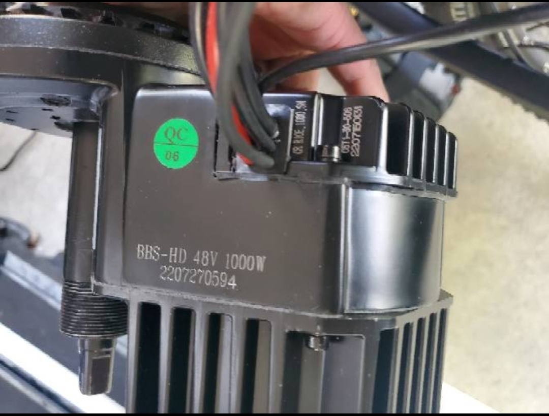

My first build not starting off so hot. Grabbed this BBSHD 1000 Watt 48v off Deruiz Ride Store on Alibaba. It was noted that this unit works with 52v batteries. The box was gone through and maybe a return as the cranks were scratched šŸ™ˆ
I bought a Mini Max 52v 10ah battery and my voltmeter reads 59v at full charge at both ends of the internal plug connections.

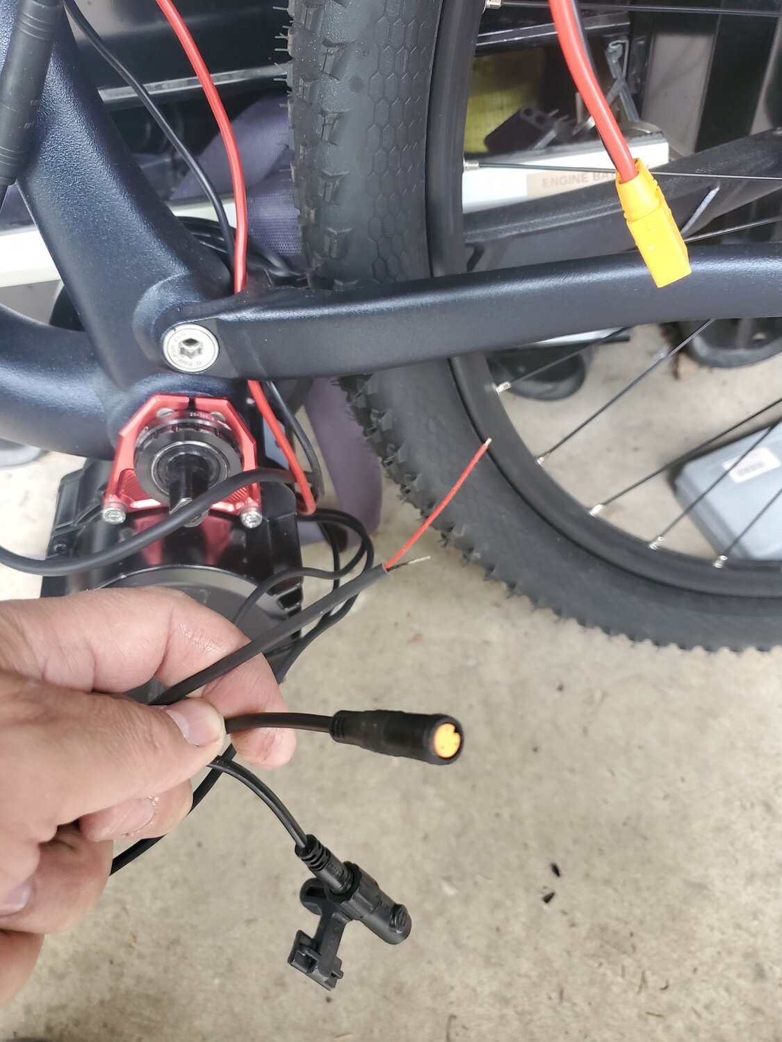

There's a small lead (picture)with a black and red wire coming off the motor I'm not sure what this is for and if it impacts the display not firing up.

By the looks of it the small lead is for the headlight display.

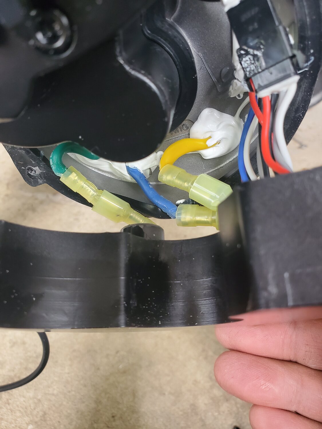

I opened up the controller are there any wires I can check with the voltmeter to diagnose anything?

You have a 48v controller that won't accept the full charge of 58.8v of a 52v battery. If you can reduce the charge down to below 54.4v somehow and try it it will probably work...

From what I've read I don't believe it to be the case.... but with Bafang providing no official specification details and various possible firmware versions... I'd give it a shot.
