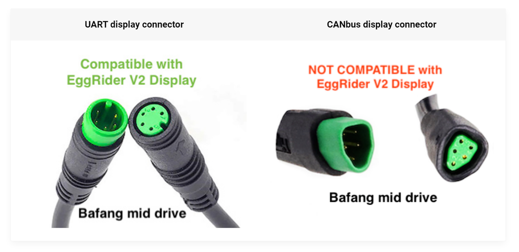

I believe from the model number yours is CANbus protocol.
Just double check before ordering by looking at the connector shape.

Thanks,i will check it out connector is the one on right,not the round one,thanks again.
fyi... You don't have to replace it with the DPC-18. As long as you match communication protocol, most all Bafang compatible mid drive displays are interchangeable.
Personally I prefer/use the third party APT 860C, though I think there's some new ones out there. You can find these in the same places, just confirm compatibility with the seller before purchasing.

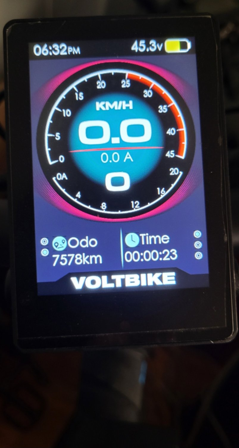

I've actually got a "Voltbike" branded DCP-18 (round UART plug) on my hub drive Outback??
I guess it's just some proprietary firmware that makes it work ??
(Actually, there's A Lot of settings and adjustments that don't do anything, so it kinda works. 😁)
