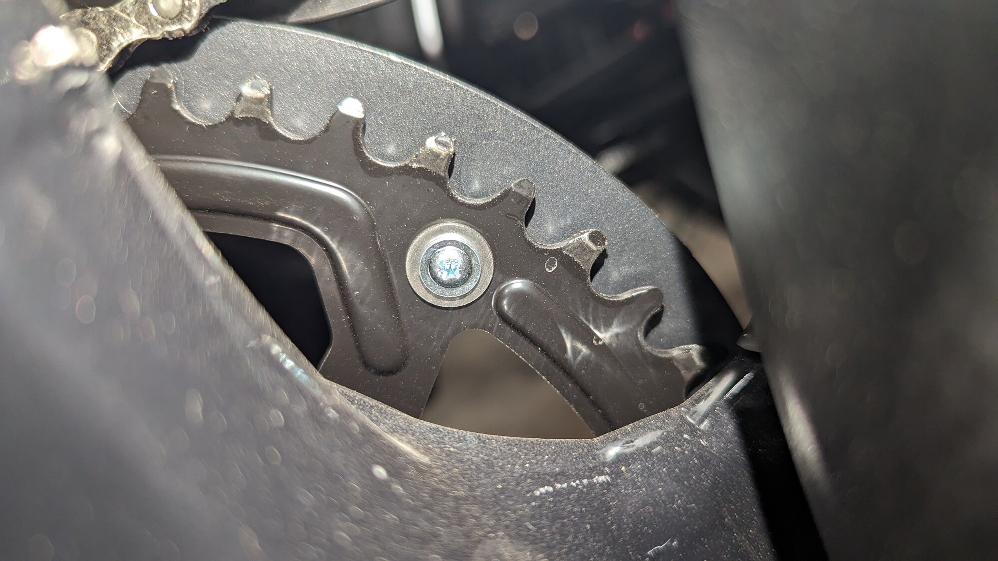

I chatted online with Specialized Rider Care which was an arduous process. The CS rep was vague and seemingly lacked technical knowledge....but attempted at every opportunity to appease me...saying 'that is the OEM ring'...or 'that is indeed a wave ring'. After 51 minutes online back/forth discussing the uploaded photos of my ring and he attempting to explain that it is an OEM wave tech ring....and me not buying it at all....he asked that he speak with a team lead and get back with me via email. In his email he wrote "do you feel confident installing a new chainring? If so I can send you a new one. We are still looking into whether that is the wrong chainring that is stocked on your bike".
I responded that I can easily install a new ring and have not yet heard back from him.

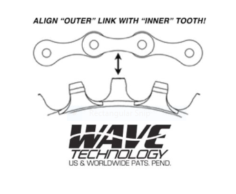

In the meantime I emailed and spoke with Praxis. Praxis confirmed via my photos that this is most definitely not a Praxis chain ring. He acknowledged that Praxis does make parts to spec for manufacturers and that this particular ring is not Praxis. He also stated that all of his rings would be printed with "Praxis".
I understand that Specialized has an 'out' with their disclaimer "Specifications are subject to change without notice".....but I just cannot help but have a bad taste left in my mouth. Perhaps I am not being reasonable.
Edit: Just received an update email "I heard back from higher ups and they said we have switched to a more robust steel chainring to minimize wear and tear. The new chainring does not use Wave Tech Technology, but we have not had many problems with chains dropping with those new chainrings. Yes, the chainring I can send you will be a praxis branded chainring like you sent the link to."

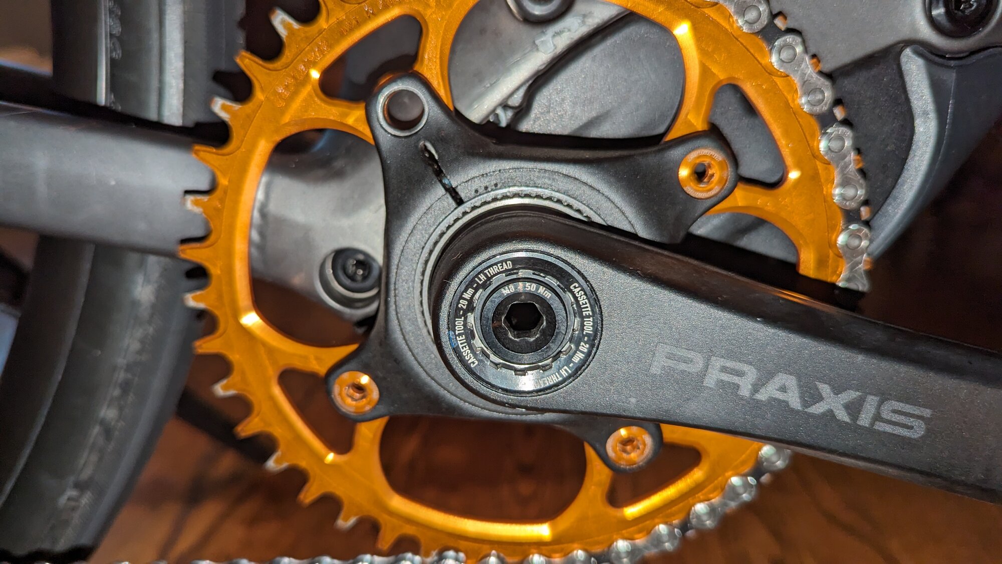

Sidenote: I have yet to have a chain drop since installing the Garbaruk on my SL. More miles will tell the whole story....but so far so good.

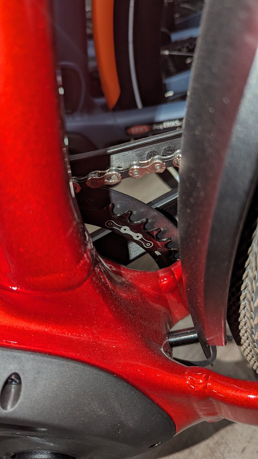

While waiting for service yesterday I observed their two Vado 4.0's sitting on the floor. A red one with the Praxis chain ring and the black one with my stamped metal chain ring of unknown origins. It does seem that Specialized is using some generic chain ring on these now.

While the tech specs for my Vado 4.0 clearly state "Praxis 48T chain ring" Specialized does have a disclosure which allows them to substitute similar parts when/if necessary. So technically they were not required to appease me....but they did.
As I already posted...I was pretty surprised to find a cheap stamped metal chain ring on my new Vado 4.0...and I reached out to Specialized for explanation.
I won't bore everyone with the details of that conversation (again) but today I did receive a Praxis 48T chain ring for the bike via FedEx.
I do not yet know whether one functions better than the other, however, the Praxis ring appears to be of infinitely superior build quality when compared to the chainring that shipped with the bike. I plan to replace the existing ring with this Praxis ring....but with rain expected for the next 5 days....it may be awhile before I can give it a good test.
The funny part of this: The Praxis wave ring was nothing but trouble for me on my Vado SL and I replaced it with a Garbaruk which has been problem free thus far.

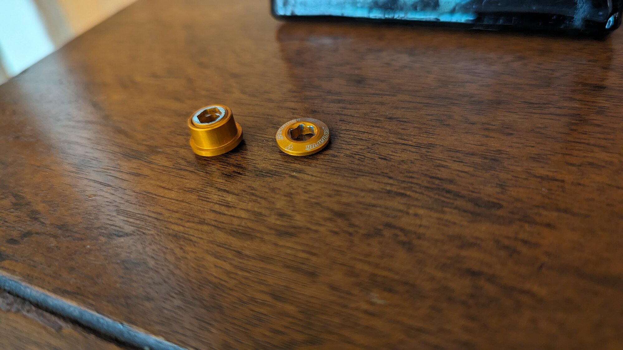

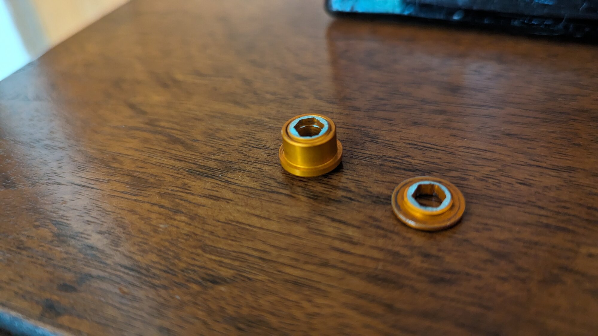

Well this is a problem. I was lubing my chain today and the chain came off the chain ring. I s'pose I was torquing the chain a bit sideways while back-pedaling while cleaning and applying lube. No biggie.
I removed the chain ring bolts to get the chain back on and before I even got to the point where I was tightening....the outer (threaded bolt) top sheered off entirely!!!!
Perhaps I should avoid aluminum! I s'pose it is possible that I had over-tightened when I previously installed back many months ago....but just the lightest touch seemed to break this thing.
Think it is un-safe to ride with 3 bolts until I find a replacement?
EDIT: I JUST REALIZED THAT THEY HAD SENT ME 5 BOLTS!!!! I HAVE A REPLACEMENT HERE AT THE HOUSE!!! YAY!!!
