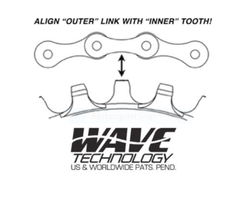

Perhaps this diagram could help?
As I can read it in another forum, the WAVE chainring is not directional. The chain placement graphics could be well hidden behind the chainguard in your Vado.
I can remember a debate with a German forum member here: I said the graphics was on the outside, and he claimed the graphics should be inside the Praxis chainring :)

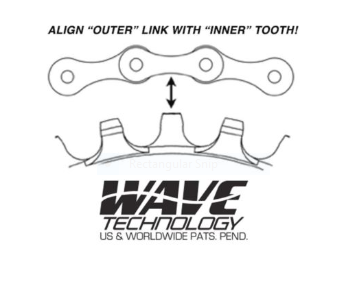

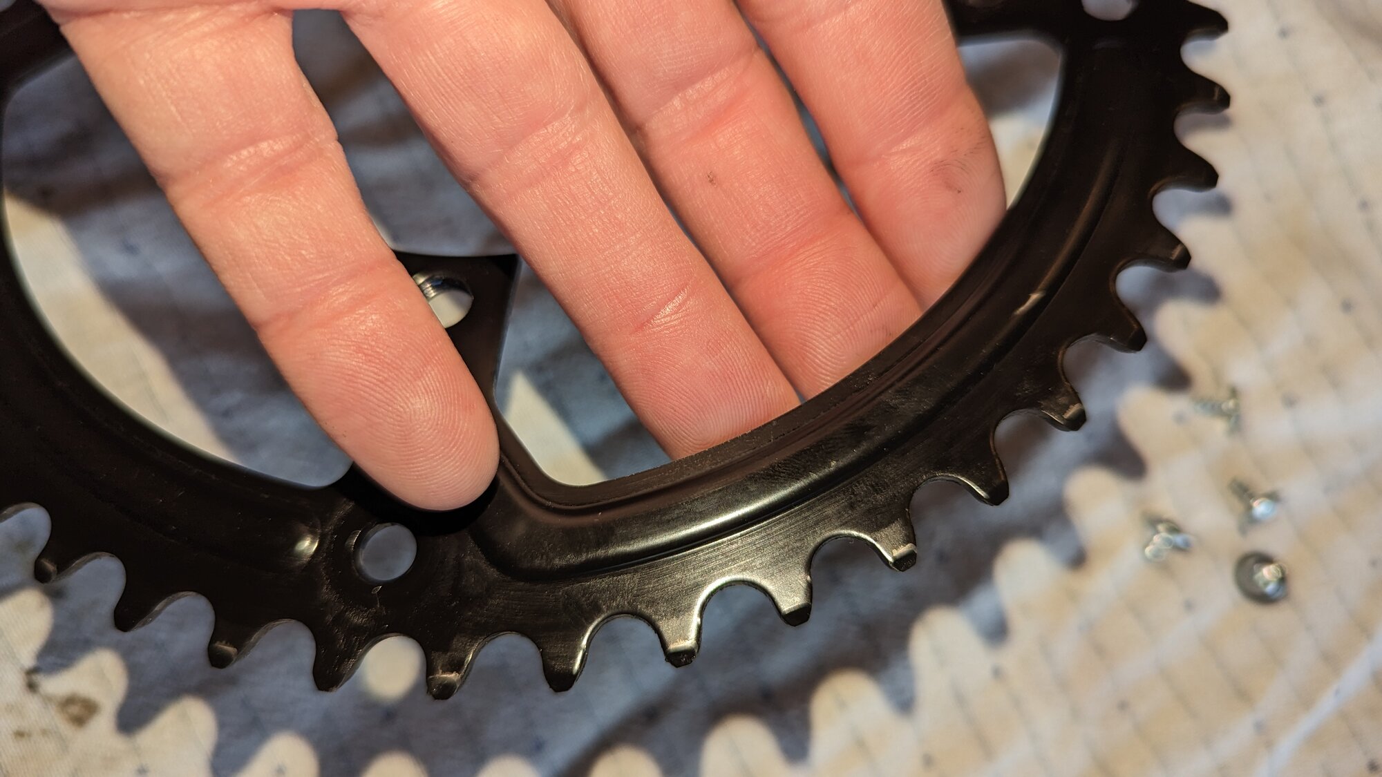

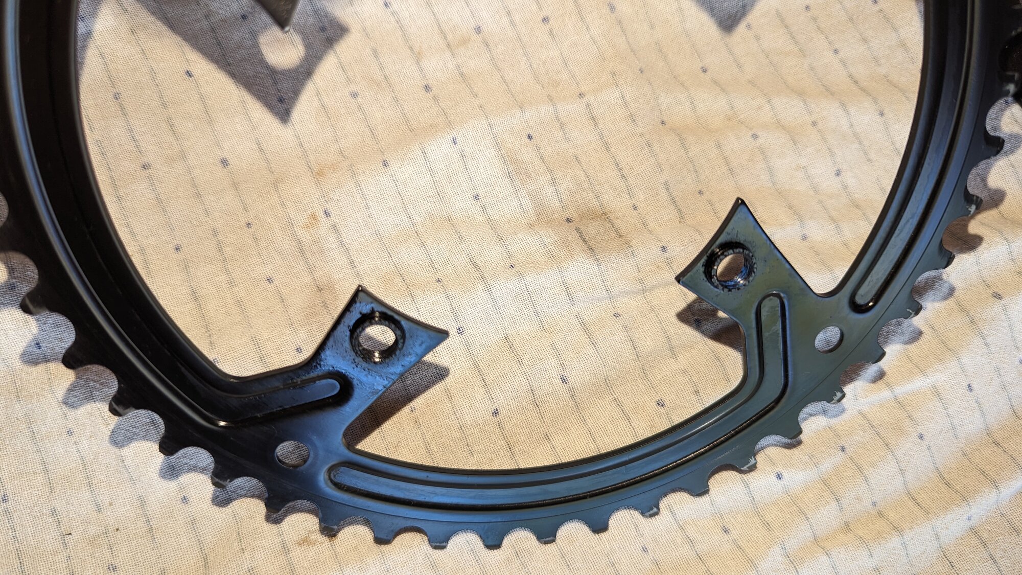

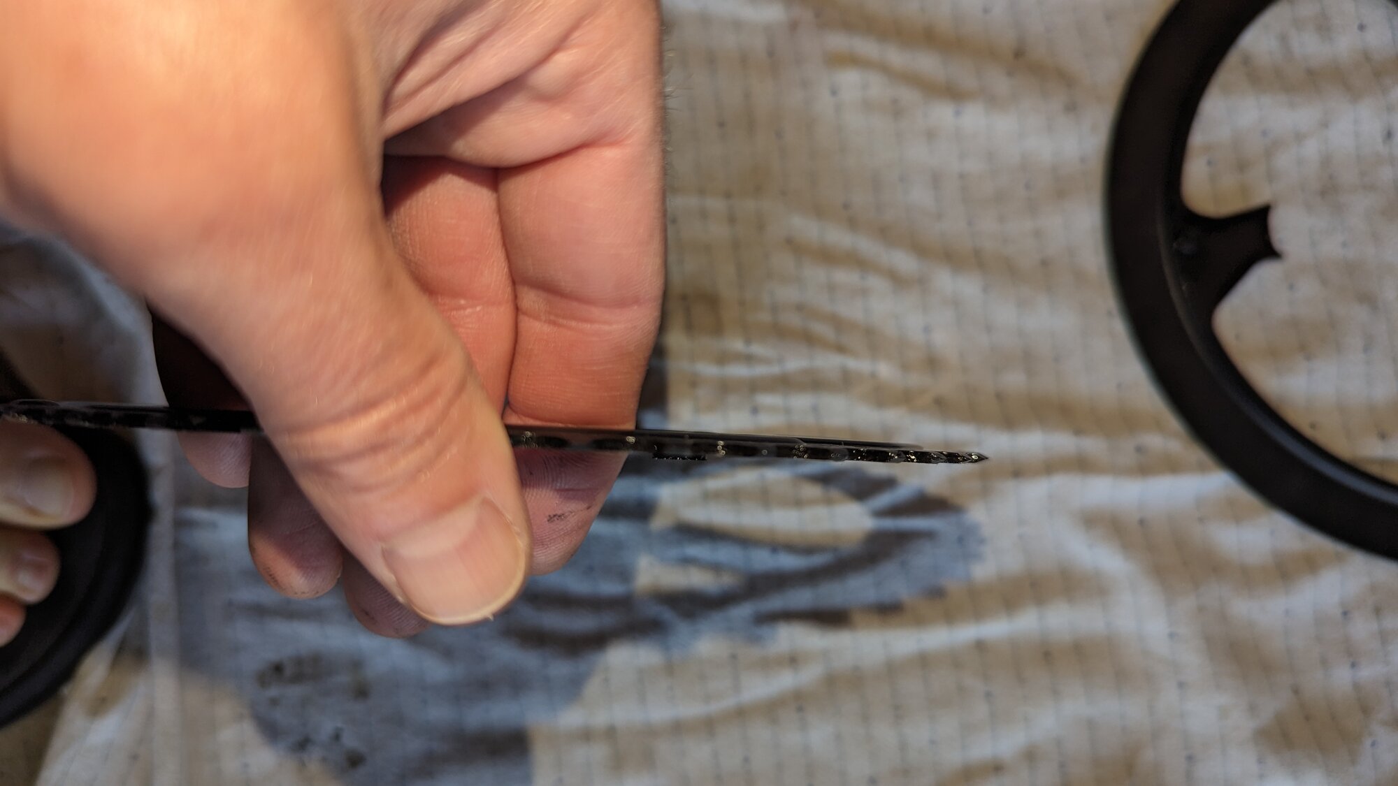

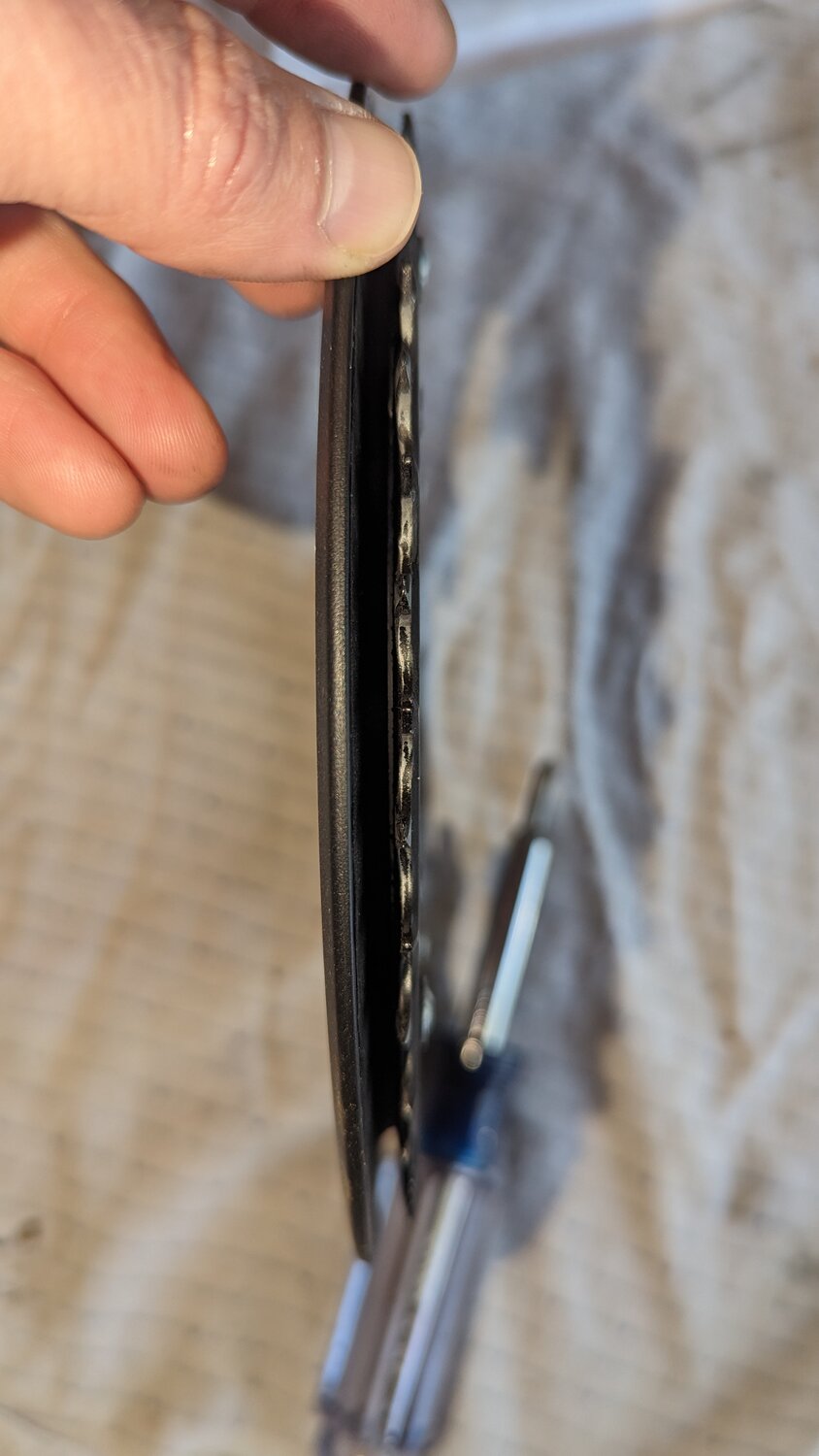

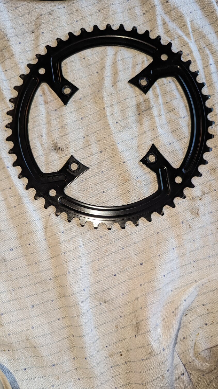

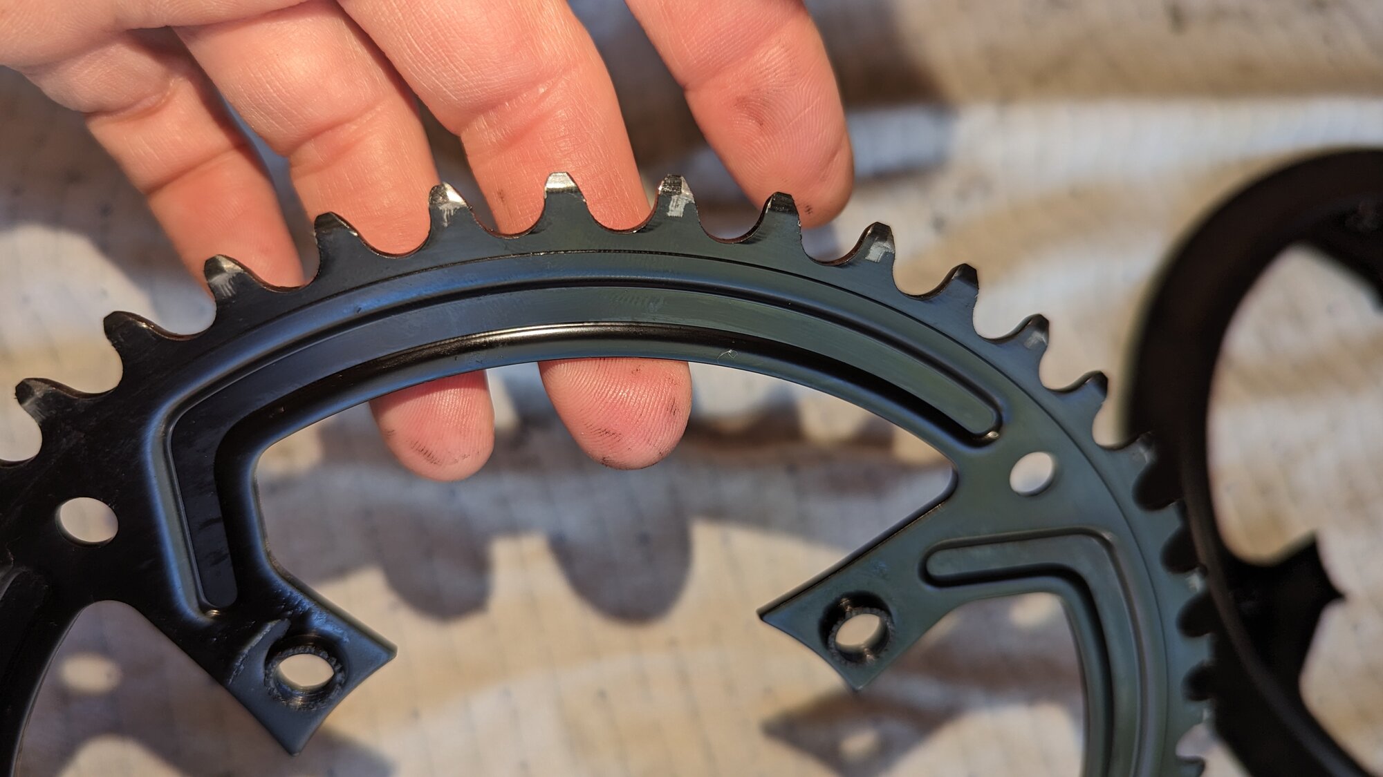

OK....I went out and removed the chain ring and its guard(s) to have a closer look. The Vado 4.0 chain ring indeed appears to be manufactured by stamping and has no markings whatsoever. If this is a Praxis chain ring then Praxis wasn't too proud of it....as the name is not on it. Clearly this is not a "Wave Technology" chain ring....the teeth are not offset at all. I don't believe that this ring would require any specific tooth to chain configuration for installation. Hmmmm....this is not the chain ring that I had expected.

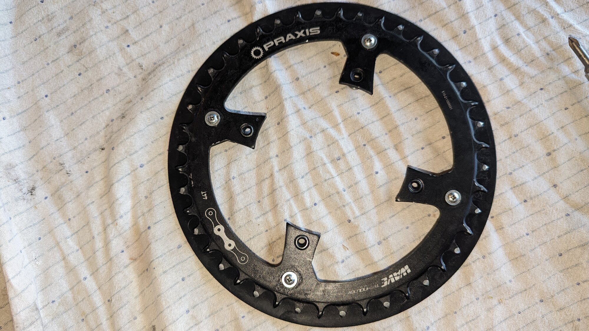

Now just for giggles....here is the Praxis 44T chain ring that I had previously removed from my 2022 Vado SL 4.0
and this one has clearly off-set "Wave Technology" teeth and accompanying Praxis markings.
Wow, that looks like a totally generic chainring. I wonder if the shop swapped it out or just grabbed the wrong one prior to building it? Anyway, I'd not lament the absence of the Praxis Wave ring, and instead just get a quality narrow-wide chainring and happily ride for thousands of miles...
Shocking! It does not look a Praxis chainring to me at all! Does it at least accomodate the chainguard and is mounted by nut-less (threaded) bolts? If yes, such a chainring is a rarity anyway.

I'd say, 48T, mounted by threaded screws, with a chainguard... Keep the chainring you have got. @Avg_Joe: it is not Praxis but it is not a random chainring either. It has threaded holes, also for the chainguard.
