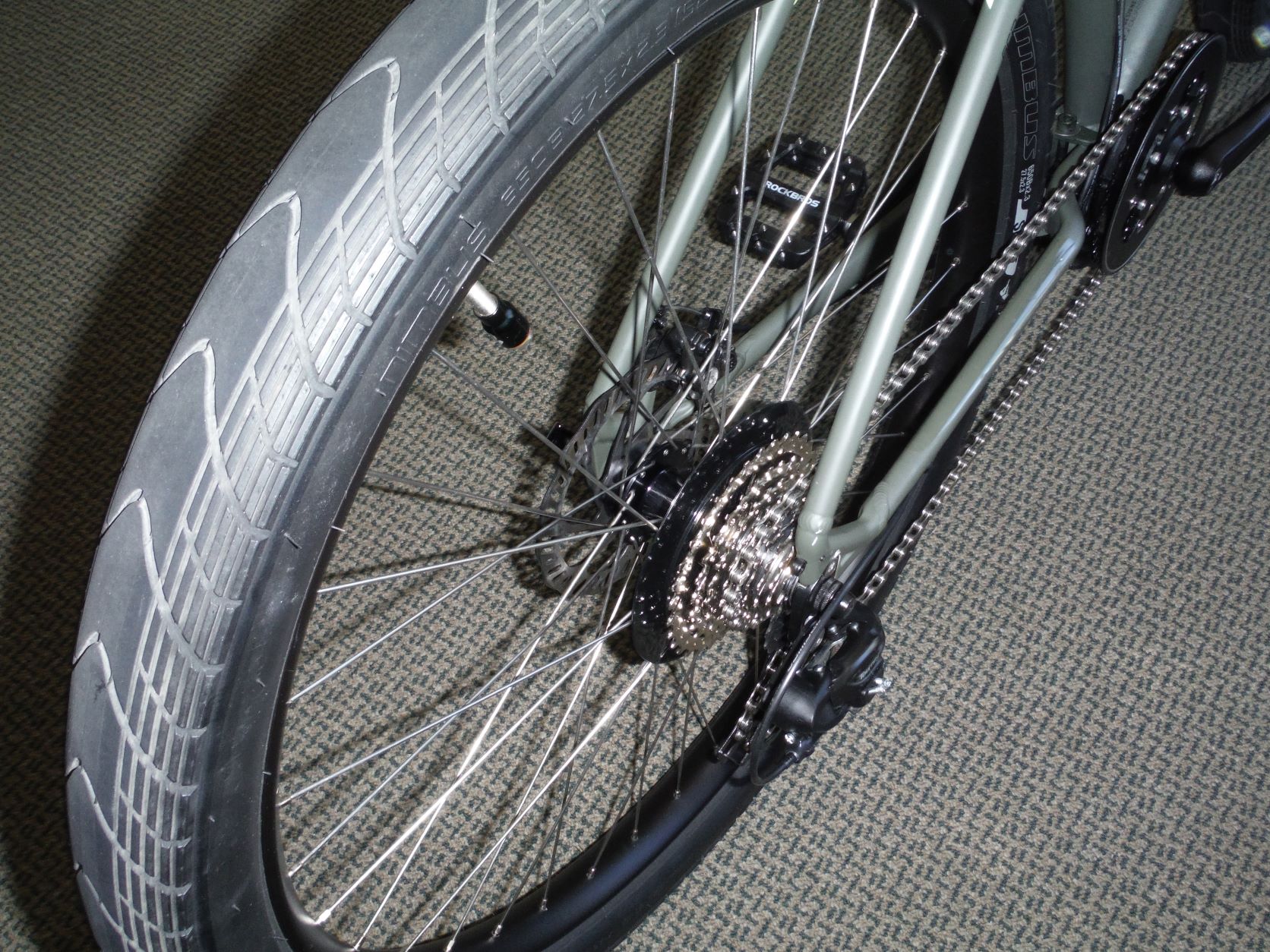

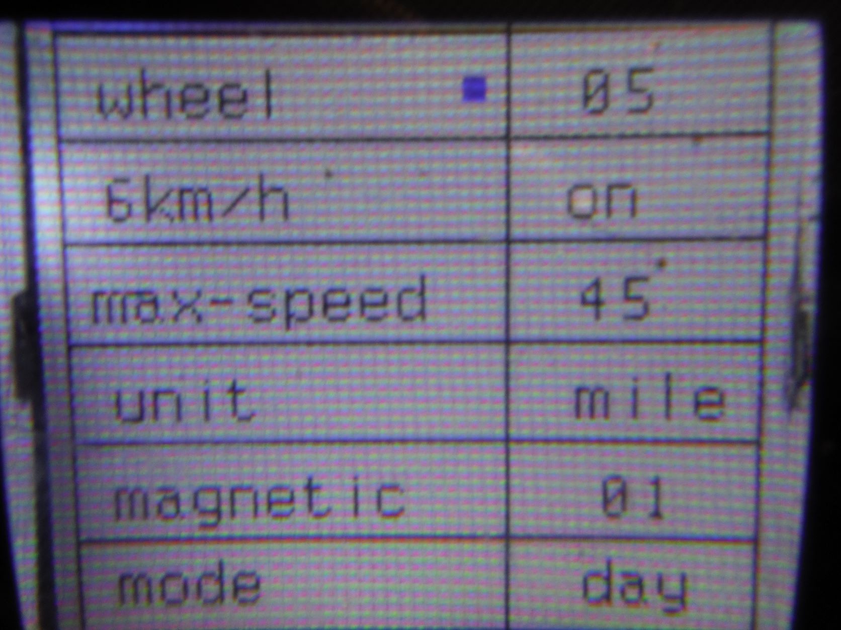

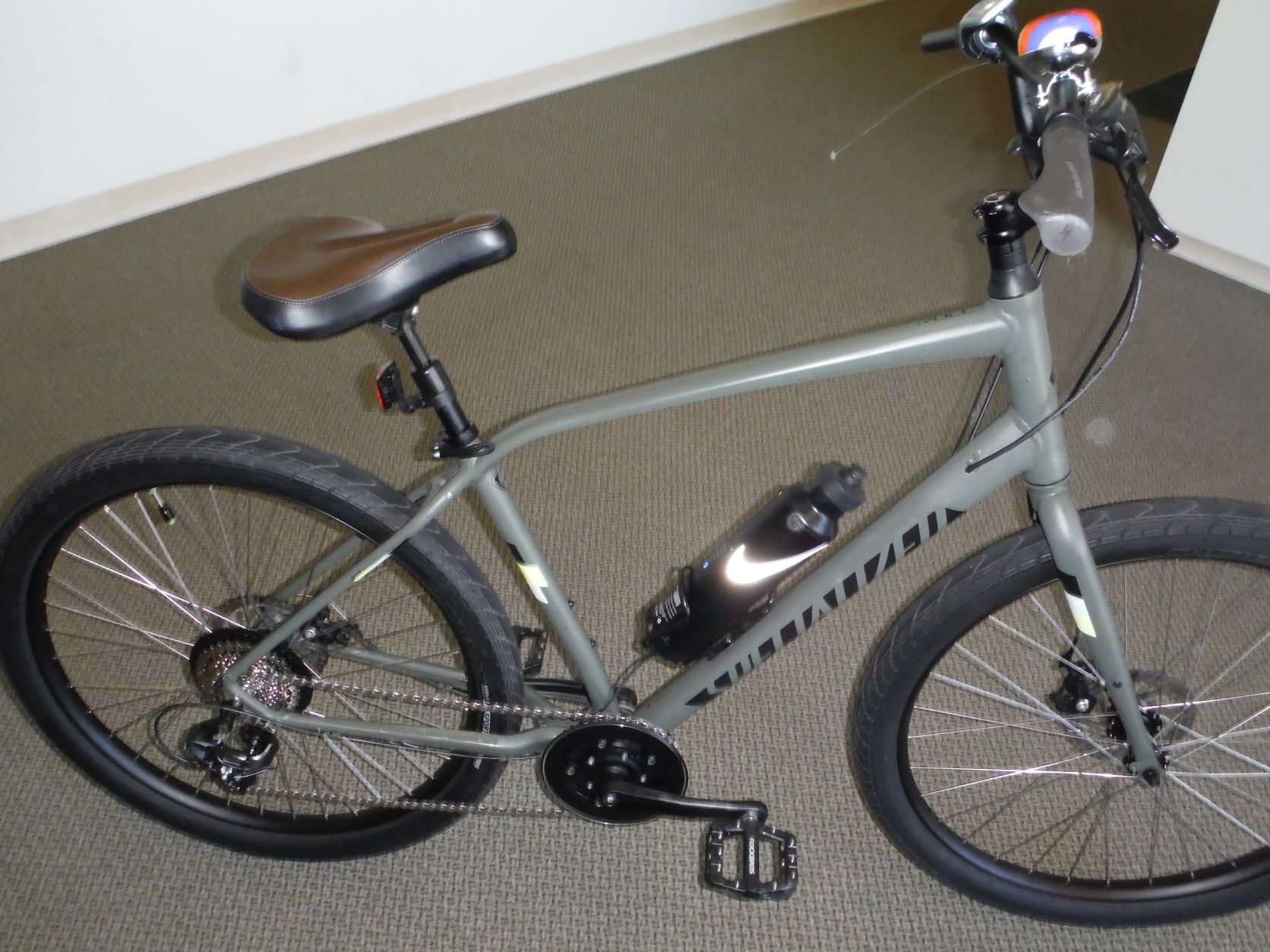

@Gionnirocket, This electric bike is almost finished. The left brake lever and the SuperMotoX tires arrive tomorrow. I programed it so it think it has 5 inch wheels with a top speed of 45. And put a Niki swoosh on the battery to dress it up.

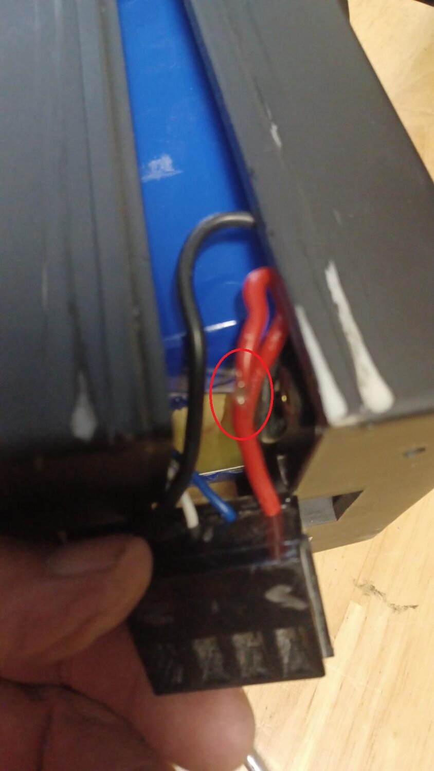

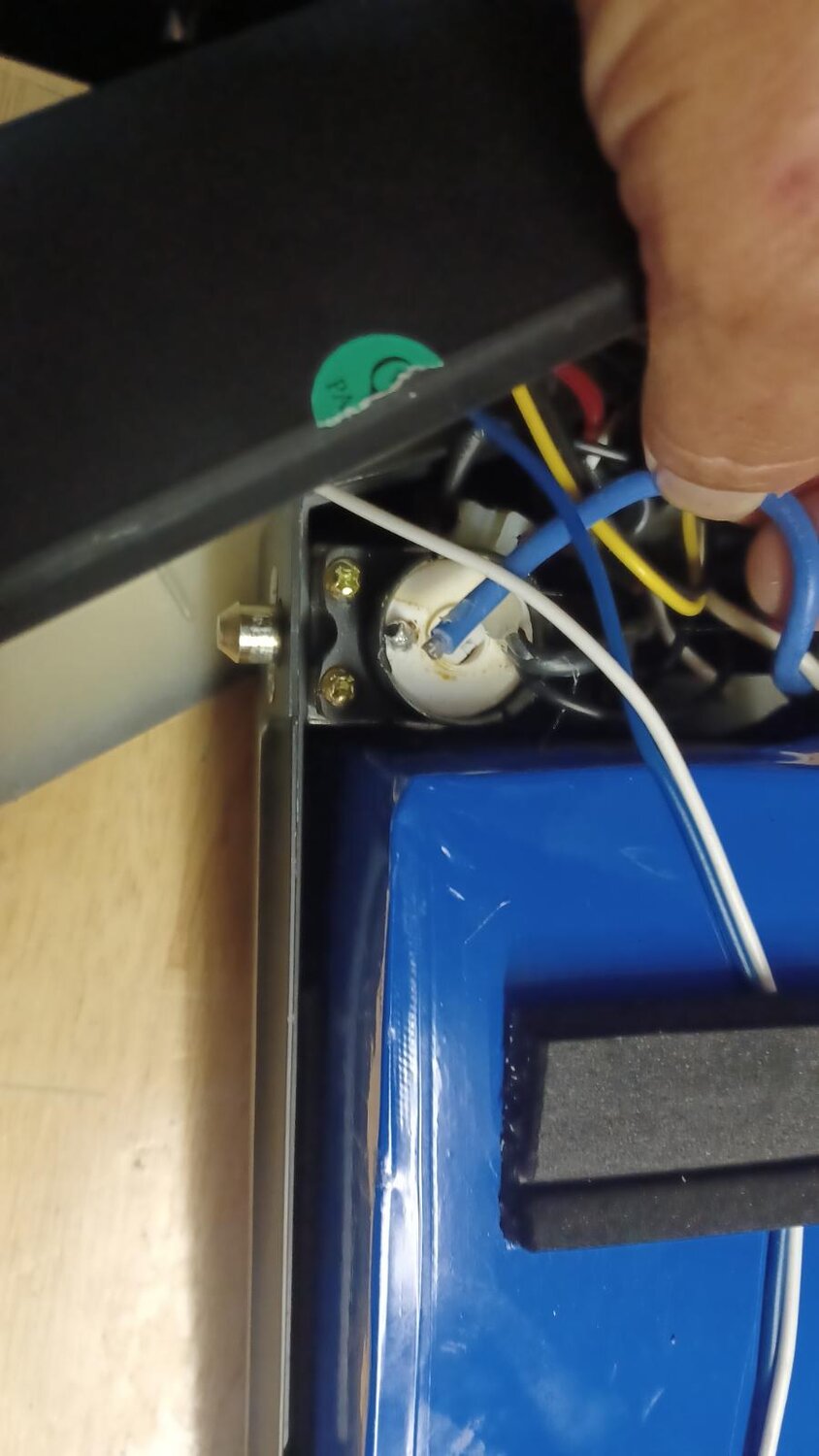

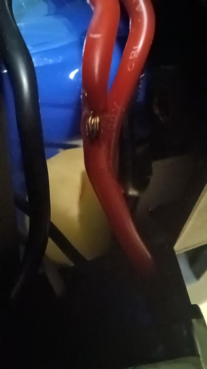

I decided to open up the old battery to see if there's anything obvious.
Sure enough! Poor workmanship killed this battery.
Broken wire on the main switch and a chaffed wire where the screw holds the case together at the bottom.
That's probably why it was surging until it died and i would get random voltage readings
