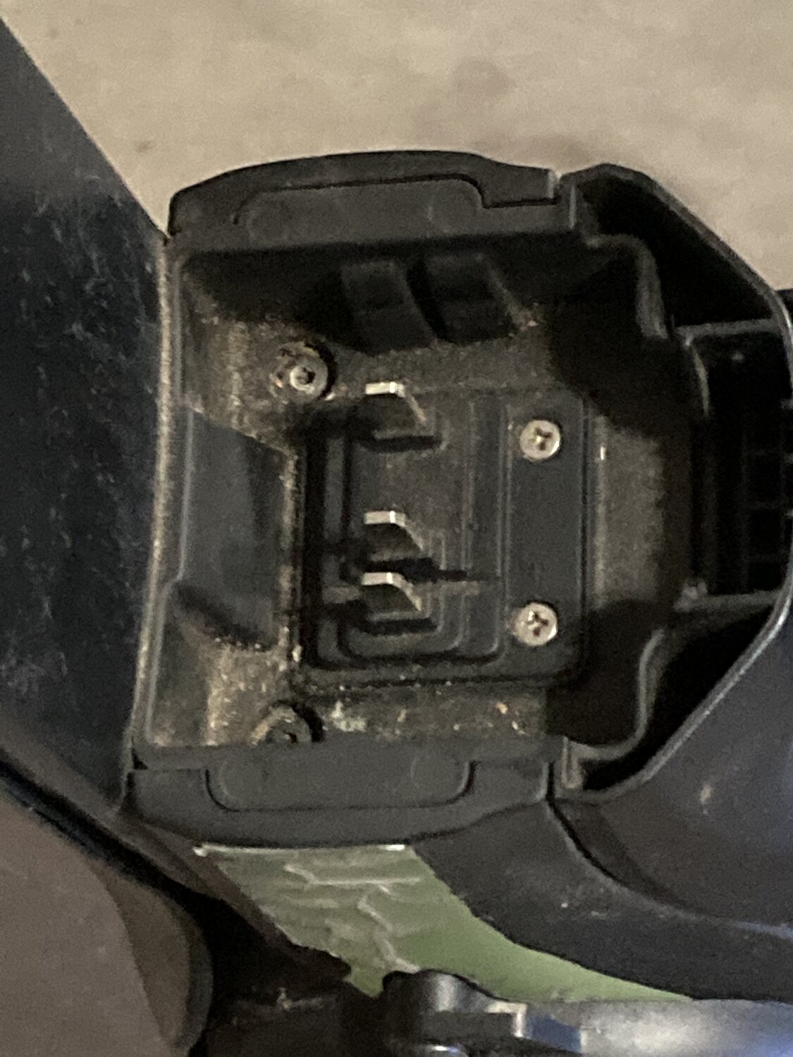

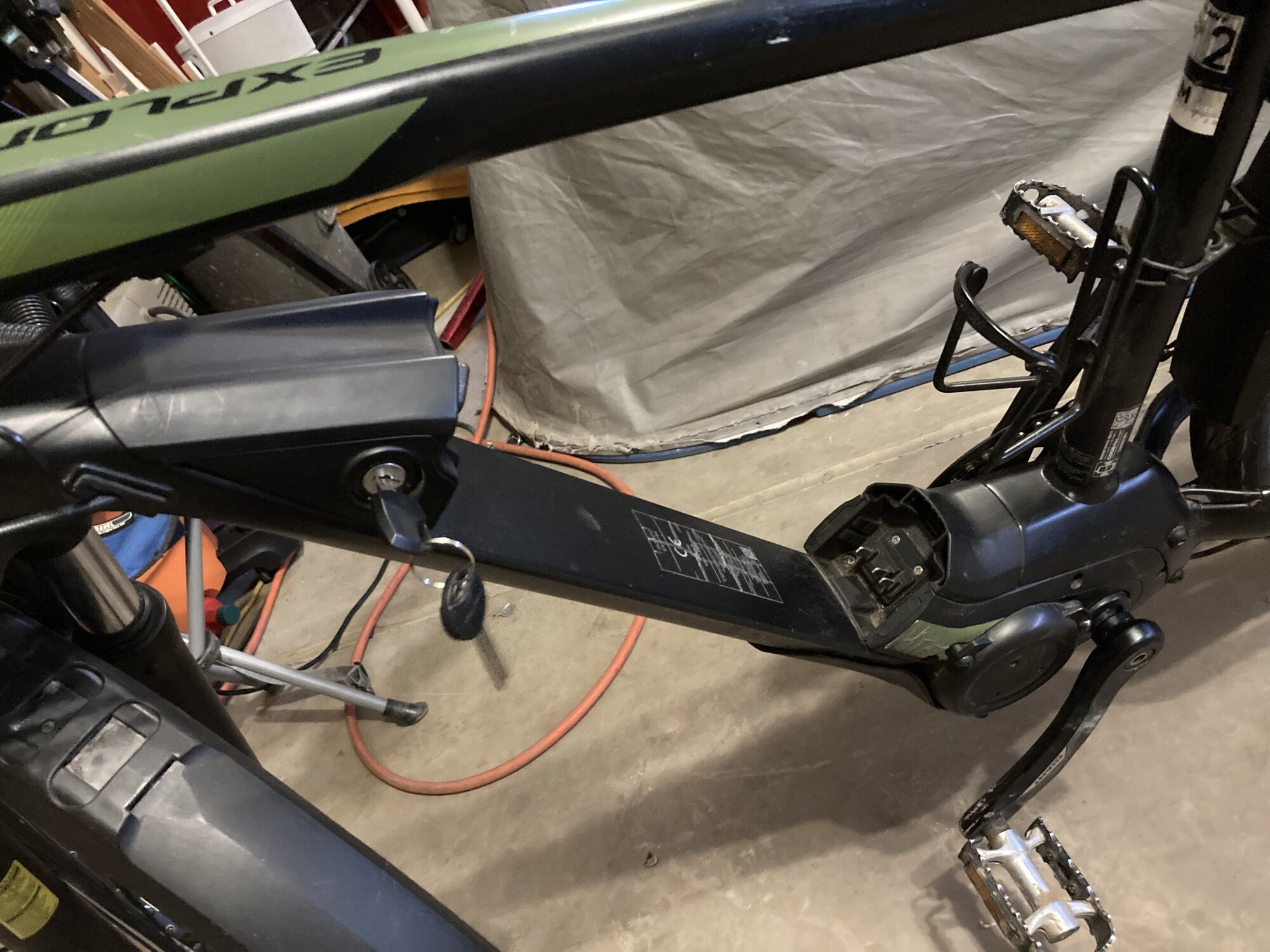

I just bought a Giant Explore E+ 2 , I was told it is a 2018 (trying to verify with Giant) and it does not have a battery. The seller had to leave it behind on move due to shipping issues with the battery.
I have been doing some searching and such but cannot determine how interchangeable the EnergyPak Smart 500Wh batteries are.
This Giant has 3 prongs where the battery plugs into (it is the top loaded design).
Has anyone retro fitted an aftermarket battery like a Bosch? I am not too concerned about maintaining the visual ascetics of this bike at this time.
I am curious to what other options are out there and trying to avoid a trial and error scenario...;)
Thanks.

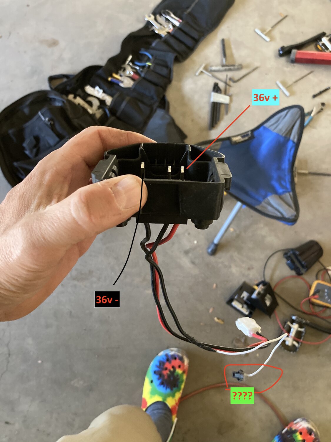

Does anyone know what the 3rd white wire is for? The white goes into the motor.

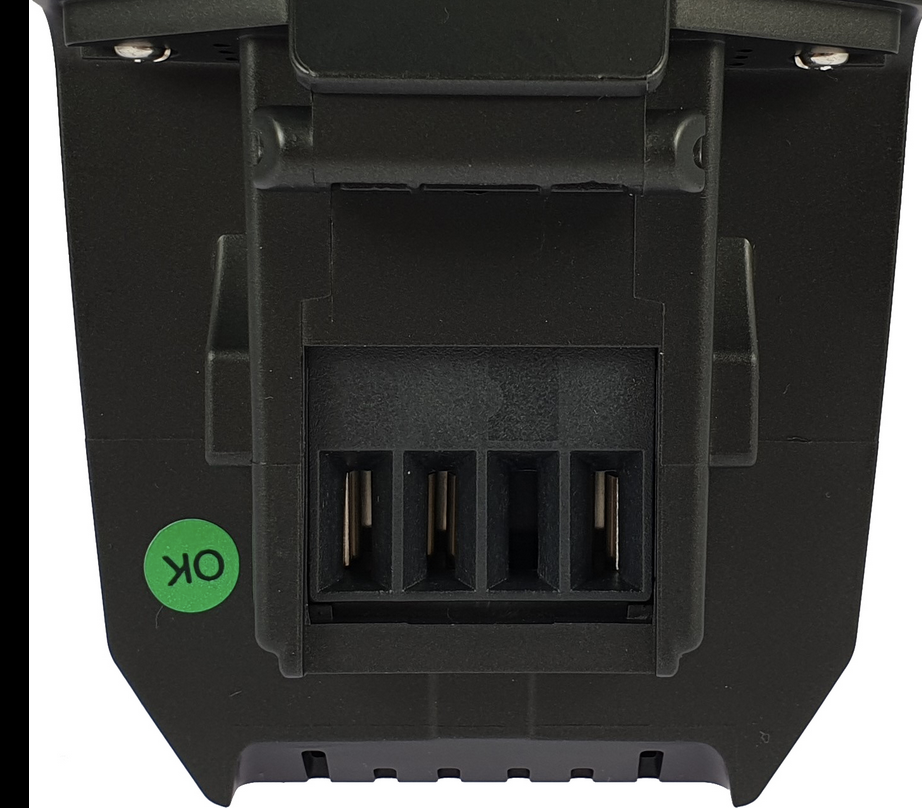

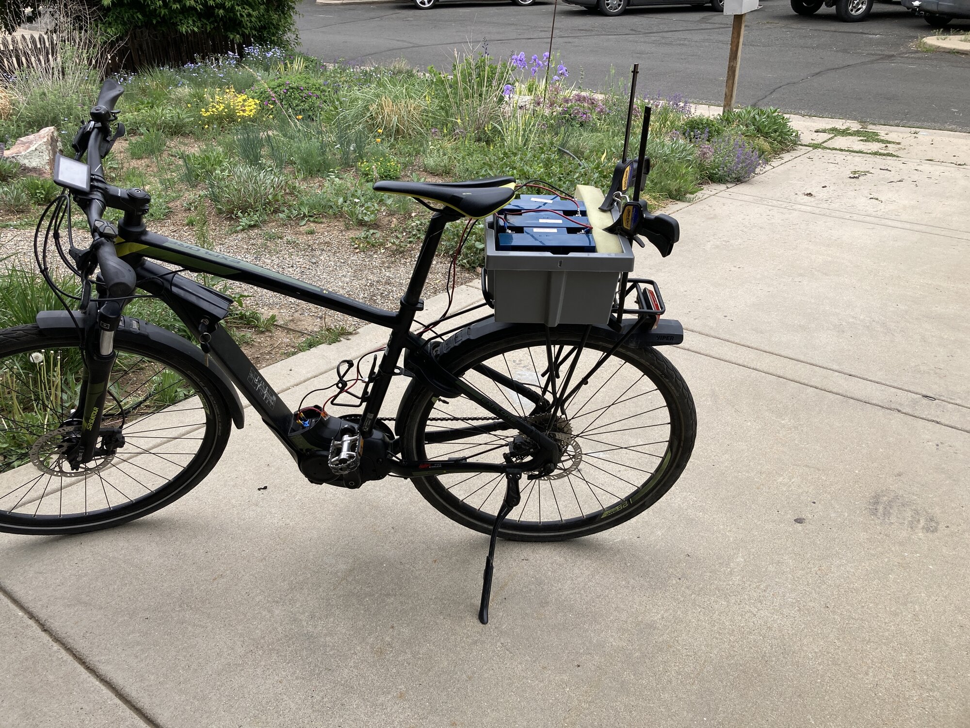

This bike uses a battery with 4 slots in it. The outside slots/terminals are the 36v inputs. I just hooked up a mcgiver's 36volt battery and rode around and everything seems to operates normally. I am sure the white wire has some purpose.... it also does not have continuity with the negative line.
Thanks.
Thanks.
