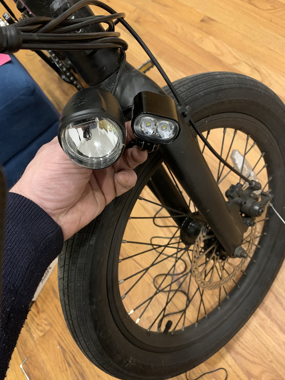

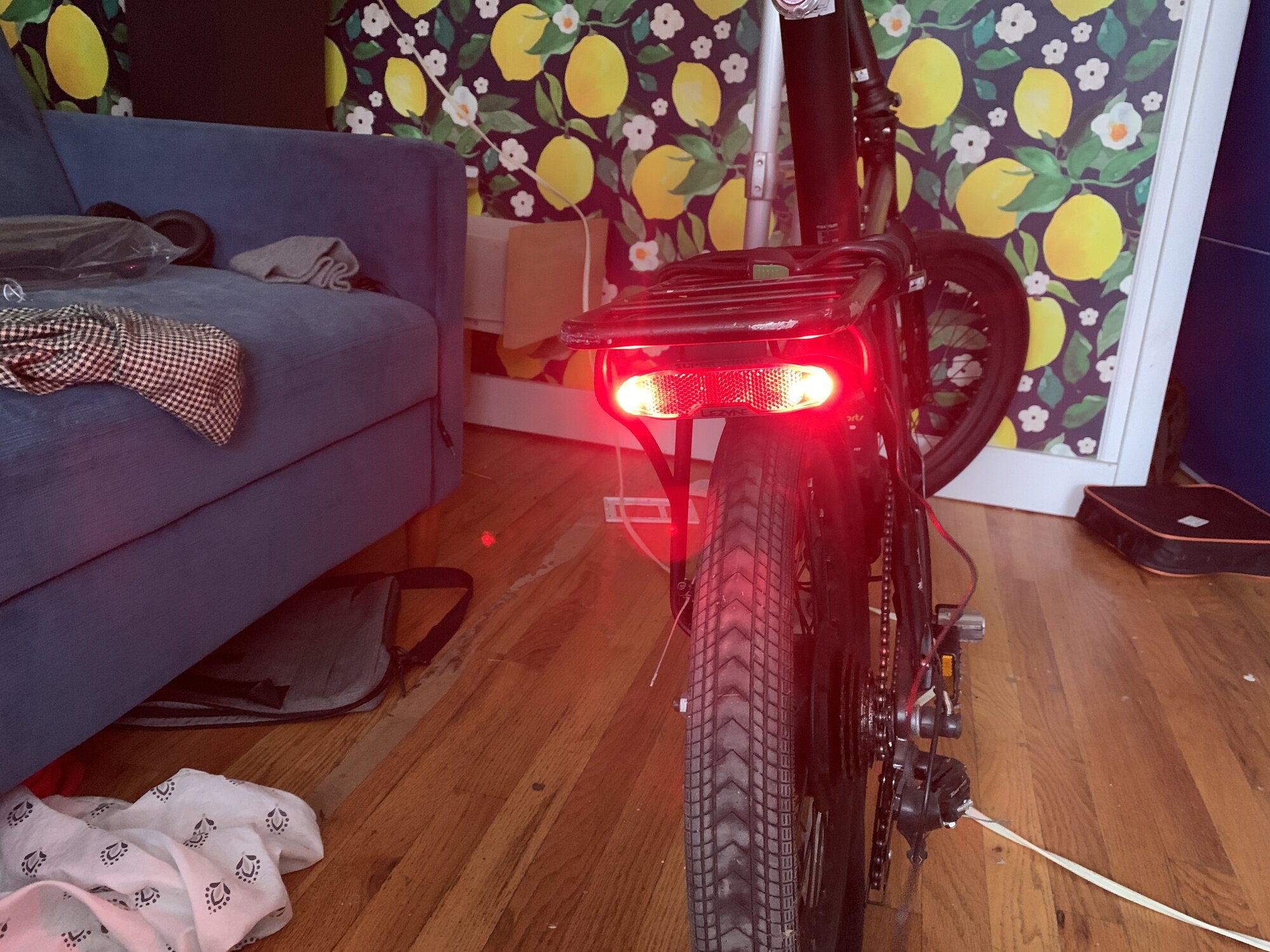

So the lights arrived and I'm very happy with them, the rear light is perfect for the rack and the front light will easily mount to the fork instead of the 3 holes I'll need for my front rack (when it arrives). I'll write a more detailed post when they are installed but right now I'm waiting on a small voltage regulator that'll take the voltage down from 36v to the 6-12v required by the lights. The lights are a special case because I want to use the same circuit as the existing light so I can turn them off and on from the display input, but conceivably I could use the same voltage regulator boards to run any dc powered device - a phone charger, a powered speaker or electric horn. The possibilities!
My plan is to shorten the existing light cable back to the controller box which gives me 36v switched from the display, add one of these - https://www.amazon.com/dp/B076H3XHXP?psc=1&ref=ppx_yo2_dt_b_product_details
Set it at 6-12v and run both lights off that.
