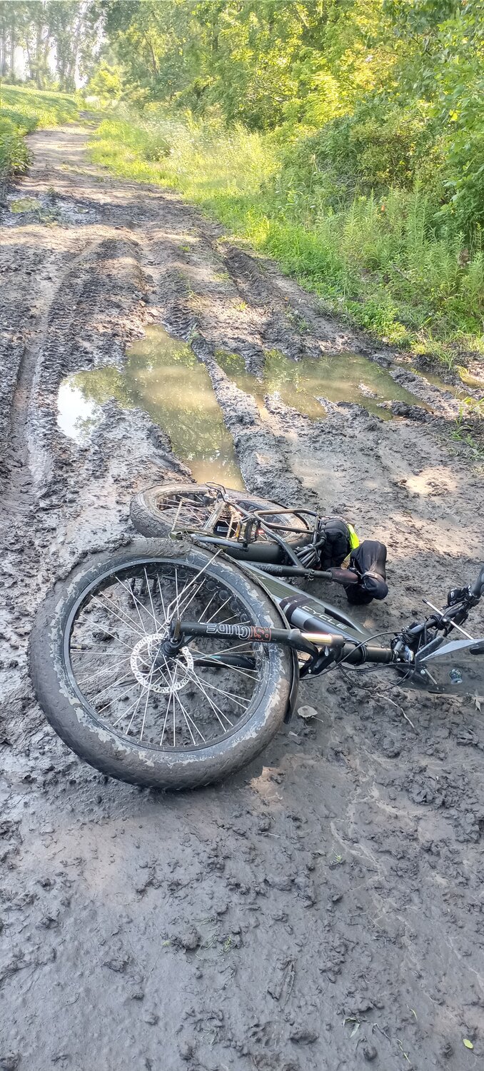

I see my ET.CYCLE on that list.
I wouldn't recommend it for hunting unless you put new tires on it.
The street slicks don't work very good in the muck. 😂
I like the bike, it's heavy but it can take a beating.
I've dropped it more than 2 dozen times with no damage.
I haven't "crashed" yet though. I just fell over at a few miles per hour.
The controller and its programming sucked though so I replaced the controller and display.
The throttle is an just an on/off switch. Full power or nothing at all
