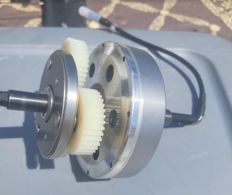

Well, I tried a different Silverfish battery and had to change the plate and prongs to get it compatible. It was a bit of pain and was a bit more range @20ah over the stock 12.5ah, but it stopped working (though it is still charged. I imagine it has a loose wire or something. I replaced the old battery and will go from there.
I was looking to see how hard it would be to put a new motor in the Hammer. I found this:
A different model but the gist is there.
I would really like to replace it with a stronger motor (more torque/climb grade capacity) which I suspect would drain the battery faster if I could find a compatible one with the electronics. Out of my depth so I if anyone can steer me in the right direction, else I will probably go with the below.
I did ask [email protected] and they had a replacement and they said they did SH-JX005 $169. I have never done such but have replaced just about everything else in a combined 20k miles over 4 bikes.
