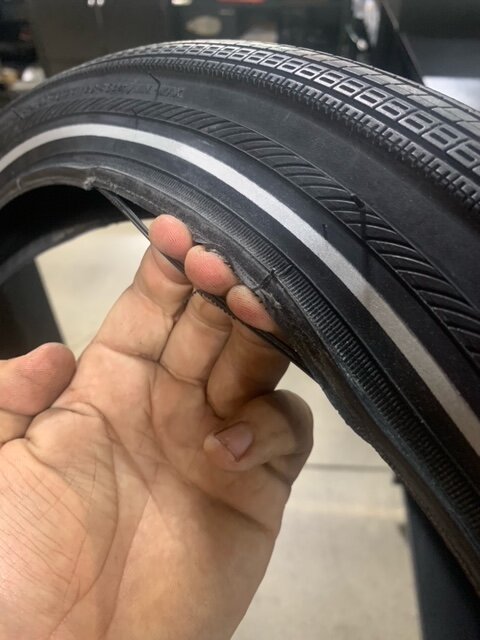

We just received my brand new Vika+ Flex. On our very first test drive around the neighborhood block, the back tire suddenly made a few clicking sound then a loud pop. The tire blew out. I took it to the local shop for repair, and they saw no nail, glasses, or sign of penetration and found a manufacture defect (see photo). Is this a known issue?

I don't think that's a defect, I've seen some stray rubber at the edge of tires (bead) often, Still, there may some defect/weakness in the bead that doesn't show in the picture that causes the tire to pop off.
Let me ask. Was the inner tube blown, or did the tire just pop off? Did they sell you a new tire and tube, or just the tire? Hope they got the axle nuts tight, They need to be tighter than a normal bike with axle nuts, Not monster tight,
Sure, send the info to Blix. They may pick up the cost of repair for the tire. They won't pay if the wheel if comes loose.
I believe the inner tube was blown when it made this huge pop sound like gunshot. The tire didn't come off; it just went flat. The bike shop will replace both tire and tube. It's a good local bike shop that I have worked with on my other bicycles and has really good reputation, so I do trust their assessment. I've contacted Blix but no response yet, but to be fair it's Friday so I'll wait for few more business days to hear from them. Thanks.
AH, it's hard to see that's a broken wire coming out of your tire bead?
All explained here in the 4th post down. You should be getting re-imbursed for your troubles. Have fun!
I got a response from Blix, they will reimburse me when I got the bill from our shop. Thanks for your help.

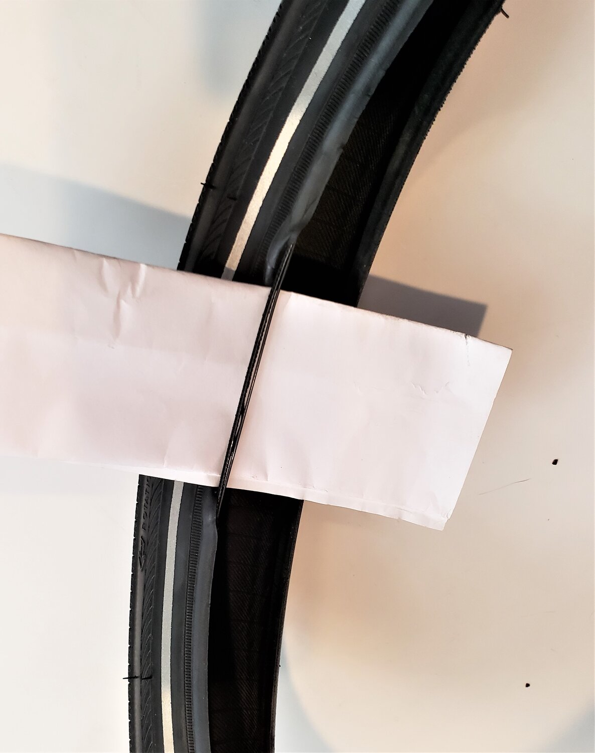

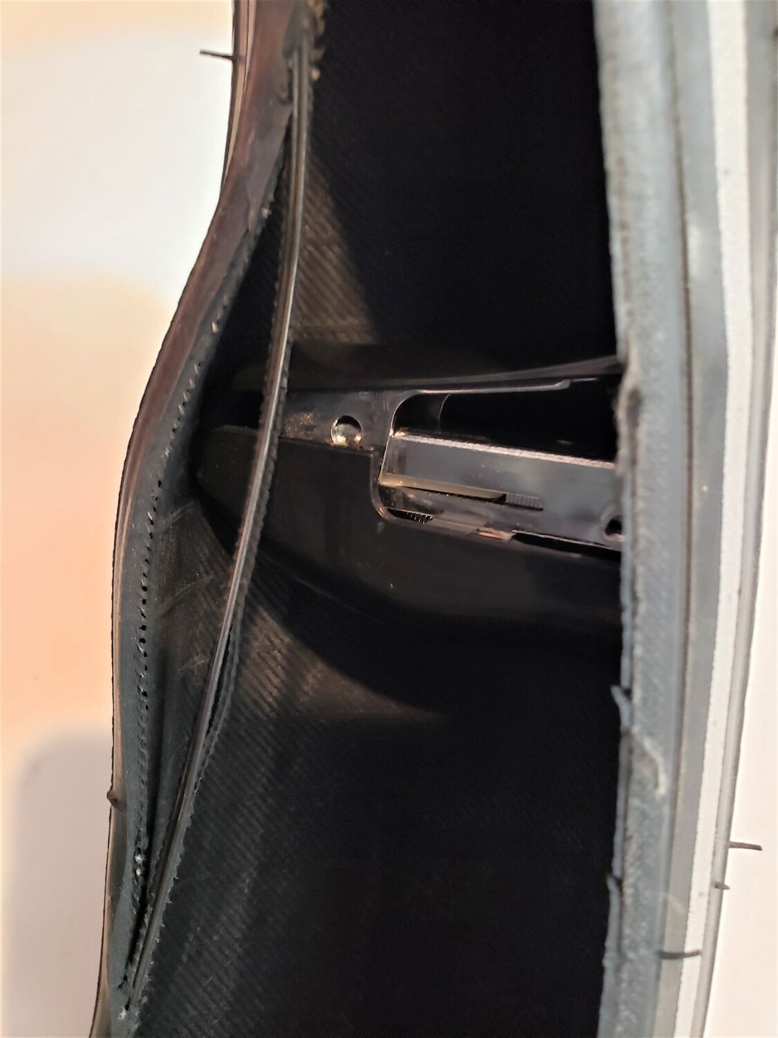

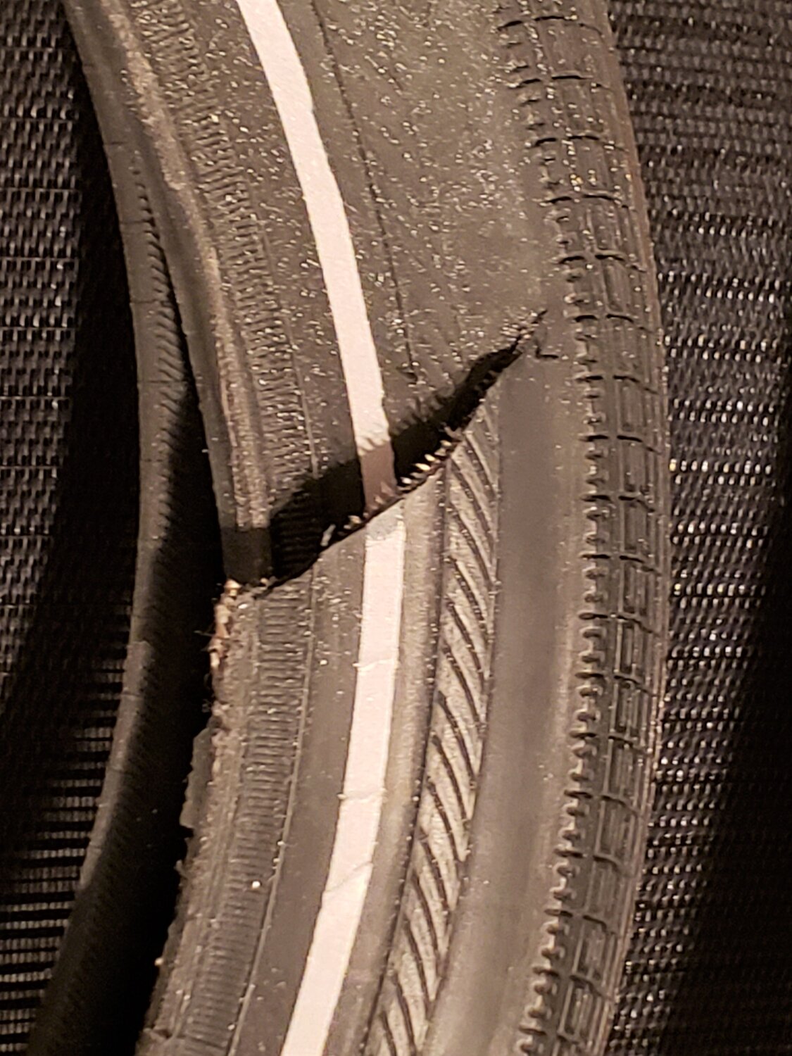

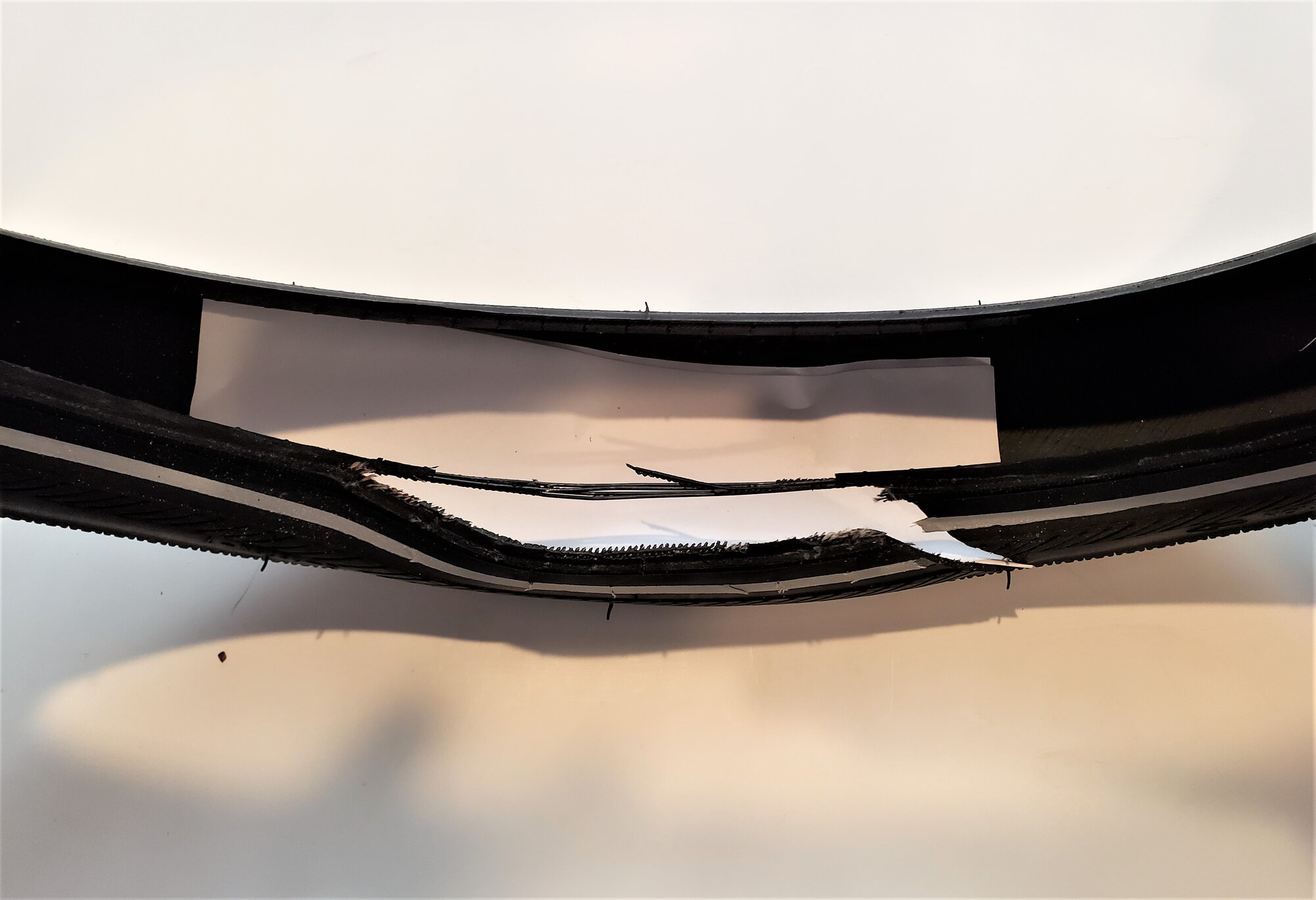

Both tires failed because the wire bead separated from the tire casing and the failures happened when no one was riding or sitting on the bike. This is a very dangerous situation because it indicates that the blowout can happen at any time. I have since replaced both tires with Amazon replacements because I don't trust the Blix tires at all. I have strongly recommended to Blix that they recall the Vika+ Flex tires and replace them with a higher quality tire. Imagine the injury if a customer was riding around a corner on pavement at 15 mph and the front tire blew out -- some serious injury could happen.
Pictures of the tires are attached.
