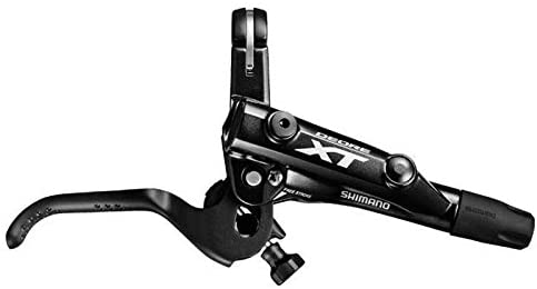

My vote-tighten a screw.
It's located (hidden) between the handlebar and the brake lever and is often used to reduce/adjust the distance between the lever and handlebar. If the lever gets too close to the bar, it's could easily be considered "loose". Give it a shot. Nothing to loose right? Go clockwise 1 turn and check it so you can see the difference. Don't go too far or your brakes will start dragging.
Seems like this did the trick. The lever feels much 'tighter' and just more like what properly functional brakes should feel like. Now I just have to adjust the other side and I'll be good to go. Thanks a lot!

Did you try using the adjusting screw that's sort of built in under the lever? Not sure, they may mention it in the owners manual.
thats just for reach.
It's the ONLY adjustment I could find on my '21 Sport.
Screw is located under the lever. Seen easiest from the loose end of the lever, looking towards the pivot point.
on mechanical brakes you adjust the pads on the caliper its self. the screw on the lever is only to adjust how far the lever is from the bar. you also don't use the nut on the lever to do it. on hydraulic brakes its only to adjust reach. if the lever is going in to much its usually either the pads are too warn or they need bleed. but they may just need tweaked. its not to hard but you need to be careful. take out the pads and squeeze the lever about 1/2 the way watch the pistons. you want them to come out a little bit and stay. sometimes it takes a few light squeezes. then put the pads back in and test the feel. if you did it too much and the pads are too close you need to push the pistons back in and try again. but if you overdo it you will need to bleed the brakes or you can push the pistons out too far and ruin the caliper. this shows where the screw that adjust reach is located on most levers. mine you can do it with the knob most you need a Allen wrench.
Understand how to adjust mechanical disk brakes fairly well. However, the Sport is using hydraulic brakes, and the only adjustment I could find is about 180 degrees from the adjusting screw you are talking about in that pic. Clearly it's used to adjust how close the lever will get to the bar.
