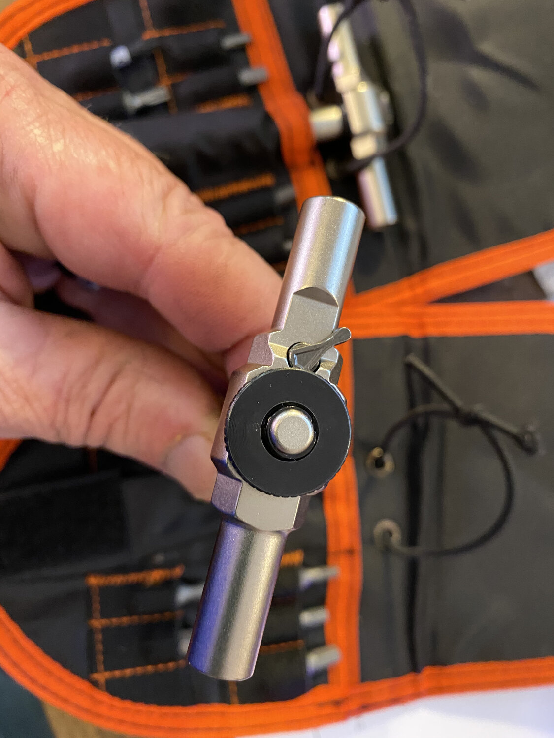

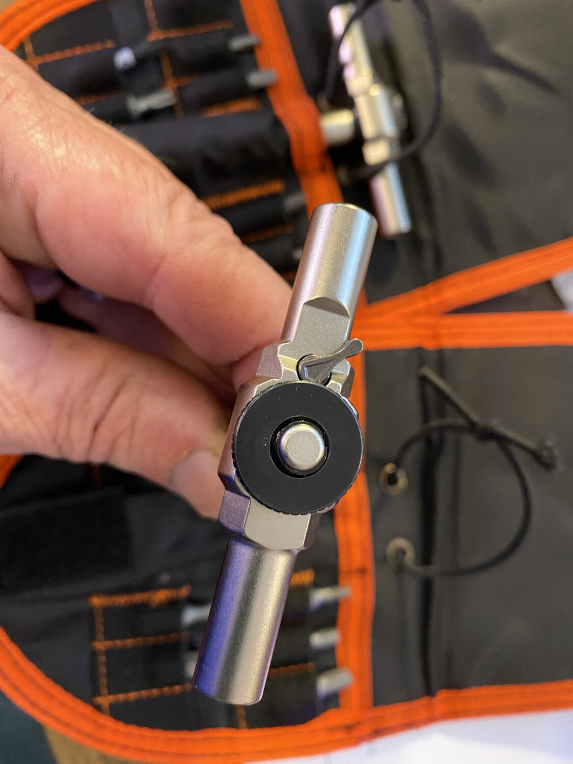

This tread is where to show others a tool and to talk about its use. What do you like about this tool? What is not so great. How do you use it?
I like that it is heavy duty and has a padded grip. I use this extendable ratchet to remove and install bottom brackets. Having extra leverage is very useful.
Remember that the drive side is reverse threaded! Both sides tighten in the direction of pedal travel under power.

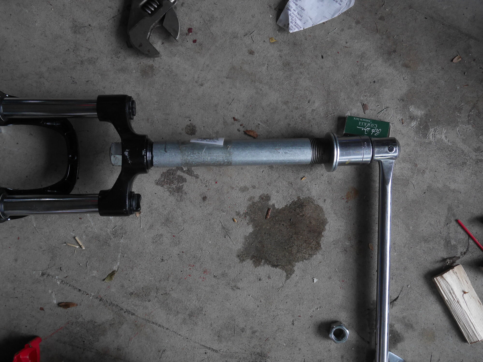

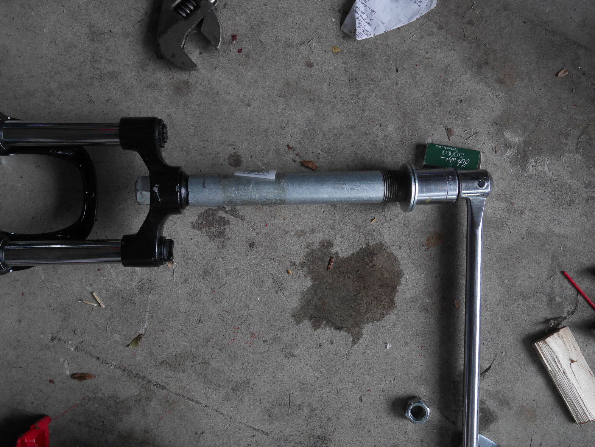

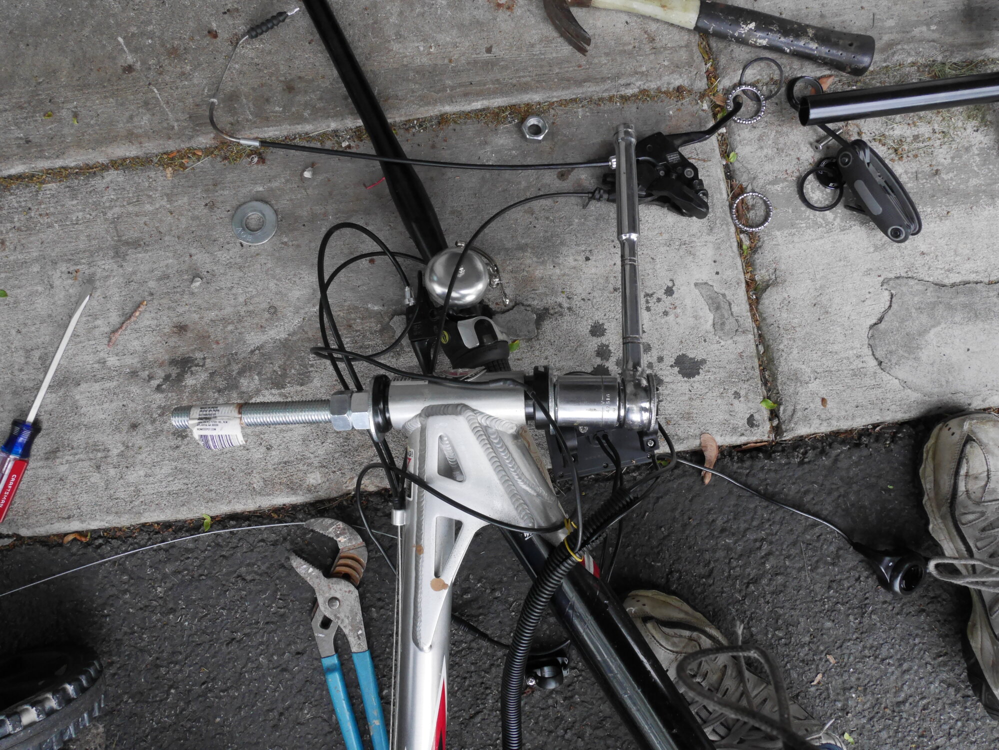

I've used this tool to install headset crowns on frames, and one balky crown ring on a fork. Half inch threaded rod with a couple of nuts and washers. Replaces a Park Tool press sold for this purpose. I like that i's inexpensive, and in addition to squeezing things together, could spread them out. It could be used to expand a steel dropout some day.
In action. For the crown bearing, I must have had the wrong size, because it took a four foot piece of pipe on my breaker bar to force that sucker on. They should just slip on.
