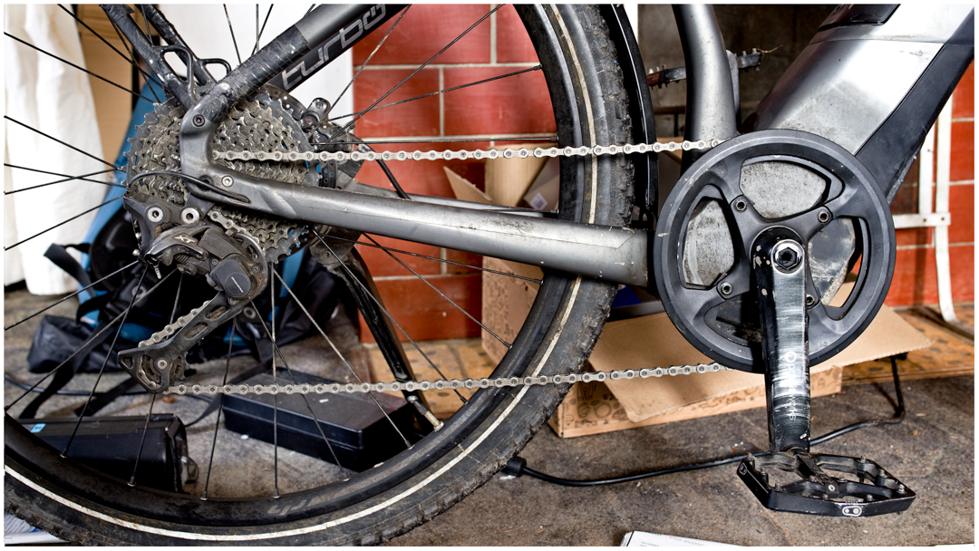

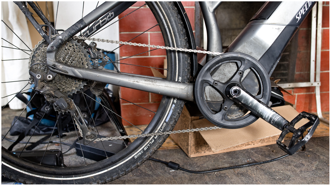

A lot of water has flown in River Vistula since :) It is 48T chainring, 46T smallest cassette cog, and Long Cage derailleur. I have found the optimum chain length is only 126 links there! Let me tell you how to find the ideal chain length:
As I have just written, my Vado with even larger granny gear cog and Long Cage derailleur just needs 126 links, so yours would need even less. After having routed your new chain (shortened to 126 links; or more like 128 or 130 if you are not sure), that is, the chain is on the chainring (in the proper Narrow-Wide manner) and the smallest rear cog, connect both ends of the chain at the bottom with a 3 mm Allen key. Now, observe: Is there slack in the chain? Probably it is. Now, replace the disjointed chain onto the largest cog, and temporarily reconnect chain ends. Is the derailleur at, say, 75 degrees forward? If this is still pointing backwards or vertically, the chain is too long.
Continue shortening the chain, two links at a time. You might have come down to 122 links. When you have found the right chain length, connect the ends permanently. (In case of using a master link, make sure the direction arrow is oriented properly). Engage the Shadow clutch if your derailleur is equipped with one.
Granny gear: The derailleur cage points some 75 degrees forward.
Top gear: No slack in the chain. The derailleur is not on horizontal. (As I had to use a connecting pin, I was extremely careful on the latest chain replacement).
The bottom line is: You could end up with 122 links.

You might end up with 122 or 124 chain links
