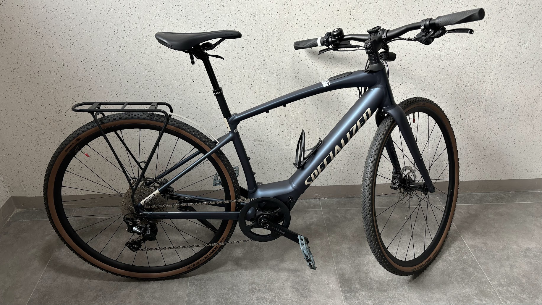

It is not so easy to find a good standard rack. After some verification of the size etc., I recommended this
PLETSCHER Quick-Rack system pannier rack
It is a Swiss-made thing that I use on one of my e-bikes. It mounts to the rear triangle with M5 screws, and is supported at the seatpost in the front, with quick release. The rack is rock solid, with the rated load of 25 kg. The rack is available in several Polish online stores, making it easy for my contact to buy.

Re-visiting the old thread. The ultimate aftermarket fenders and rear rack for Vado SL un-EQ are:
  • SKS Speedrockers (fenders)
  • Ortlieb Quick Rack (rear rack)
Both items work extremely well on Vado SL, and can be uninstalled and reinstalled again in a few minutes.

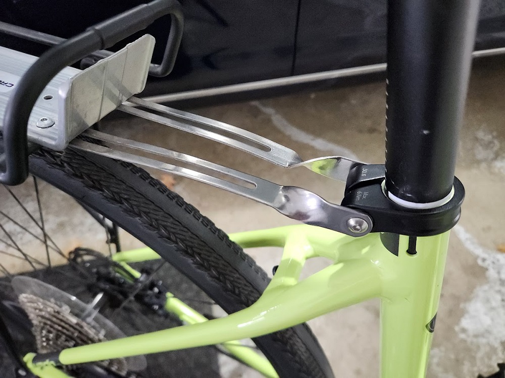

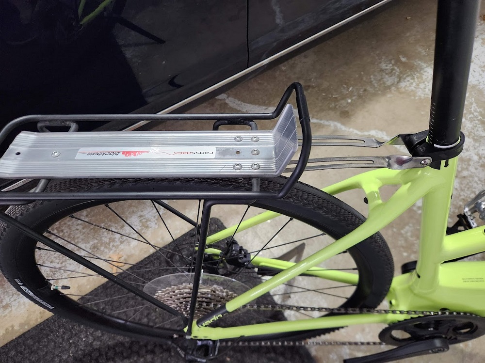

For anyone wanting to add a rack to a non EQ SL, Specialized sells a combination seatpost/rack clamp.
Part # S184700001 (30.6 mm) $20 US
I was able to buy one at a Specialized shop.
The bolts for the rack need to be short. I think the ones I used were 10mm.
I used a old spare Blackburn Crossrack. I like these racks because they don't weigh much and the thin plate acts as a rear fender to keep your back clean if the road is wet.
