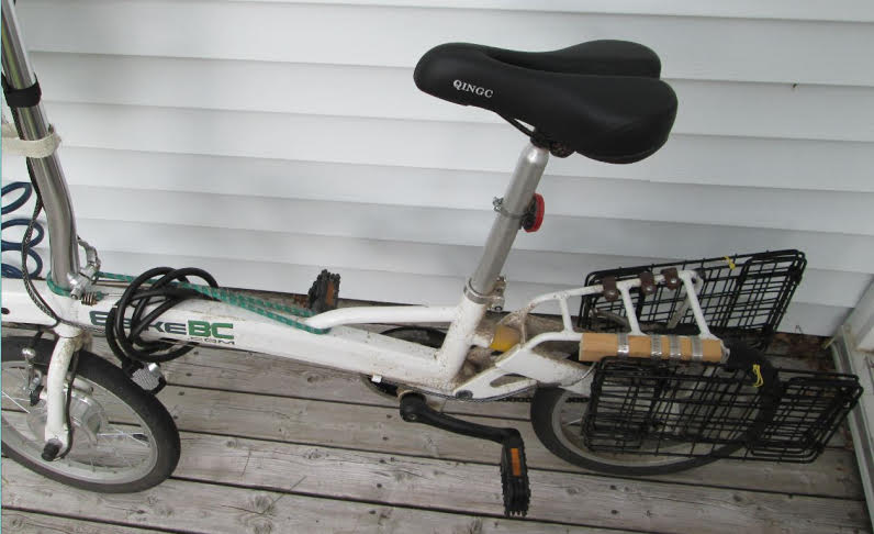

So far, after 10 months, quite well. I've recharged it 20 times; each charge is good for ca. 4 short downtown shopping trips. I've also installed 2 folding baskets. which can handle heavy grocery loads — watermelon, etc. — though attaching them was quite time consuming due to the angle of the luggage carrier sides. I'll write — or do a video — with a more detailed account of that; meanwhile, below is a Q & A from my YouTube review:

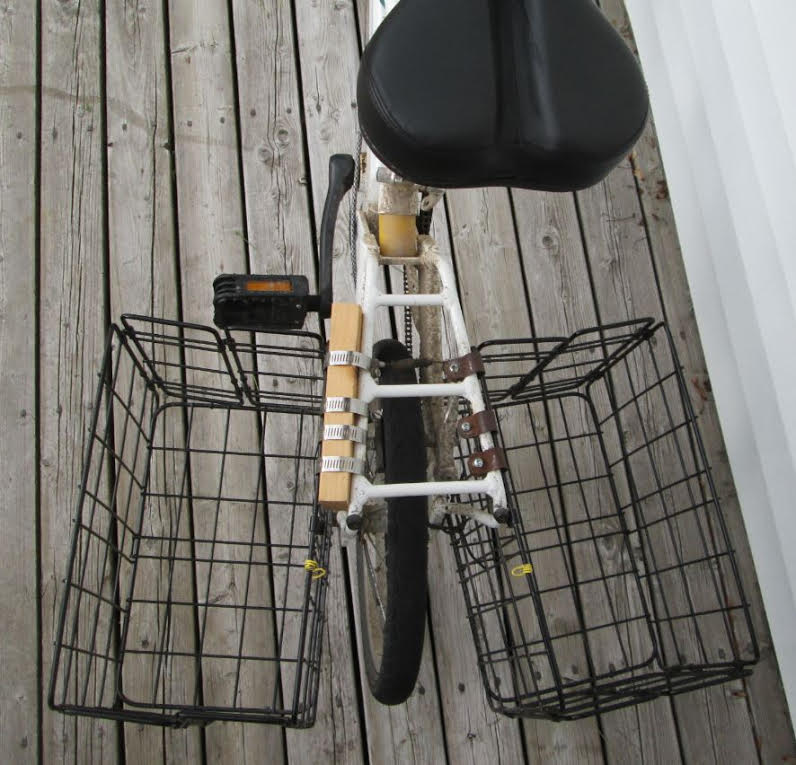

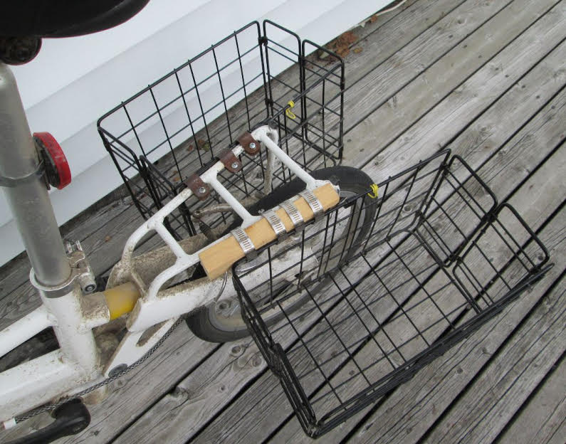

Wald folding baskets from Amazon https://www.amazon.ca/dp/B0012DZEBY/ref=pe_386430_126088100_TE_item. (avoid similar looking ones by Bell, which I still use on my manual bike, but all their very weak hinges fell off one by one, so I had to tie the sides together with wire). These are great for groceries, etc., but note one difficulty on this ebike: because of the slanted angle of the top of its luggage carrier, the basket would bump into the brake, at least on the left hand side (facing from rear). I had to jam in some pieces of wood to keep it away from the brake, and these worked for a few weeks before falling out, so now I'll have to do it better with some other kind of clamp instead of stiff twine. I'll try to post some photos or a video as soon as I can.​

Below are some photos of how I attached the folding baskets: Baskets folded: http://www.genekeyes.com/ebike/folded.jpg Top view, baskets unfolded. Notice on the left that I used a 1" x 6" piece of wood to keep the basket from bumping into the brake, and attached it and the basket with hose clamps. http://www.genekeyes.com/ebike/top-view.jpg Another view. http://www.genekeyes.com/ebike/another.jpg
