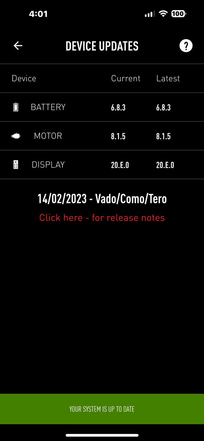

Just for fun I attach a screen shot of the firmware that's installed on my Como now:
