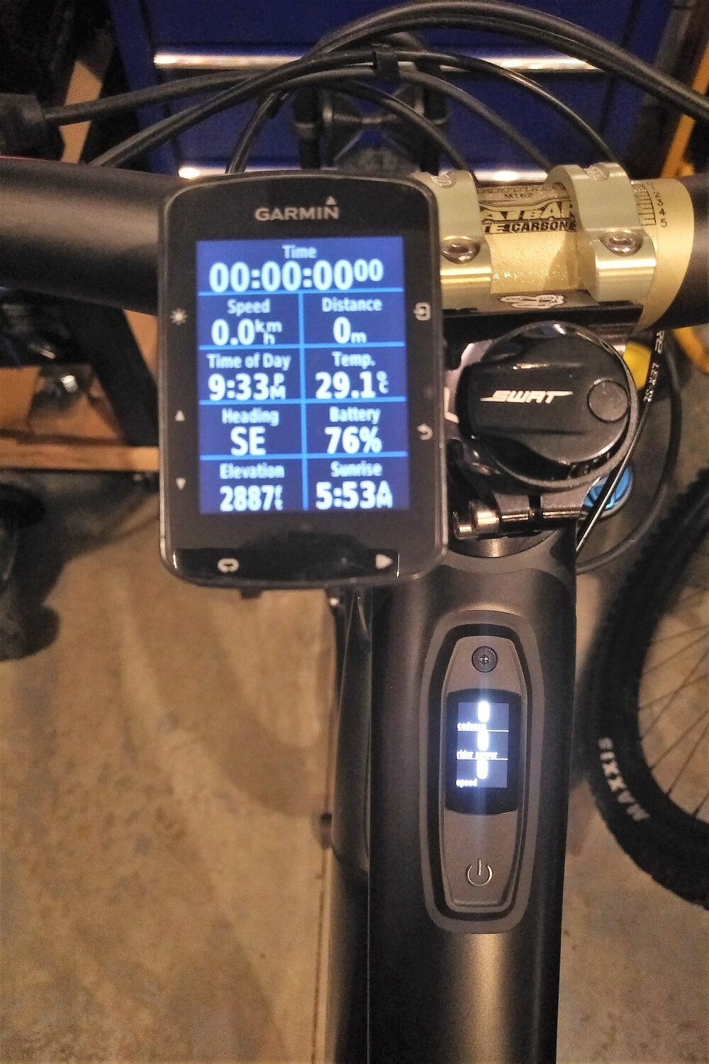

That being said, I have the Mastermind TCU on my 2022 Levo which sports the handle bar control. Overall, it’s quite a marvelous piece of tech and I do use microtune quite often but I still have come to rely upon the larger display of my Garmin head unit which is perched to the left of my stem cap simply because it’s just easier to read. Anyways, I hope that that the folks over at Specialized together with your LBS are able to find a work around for you.

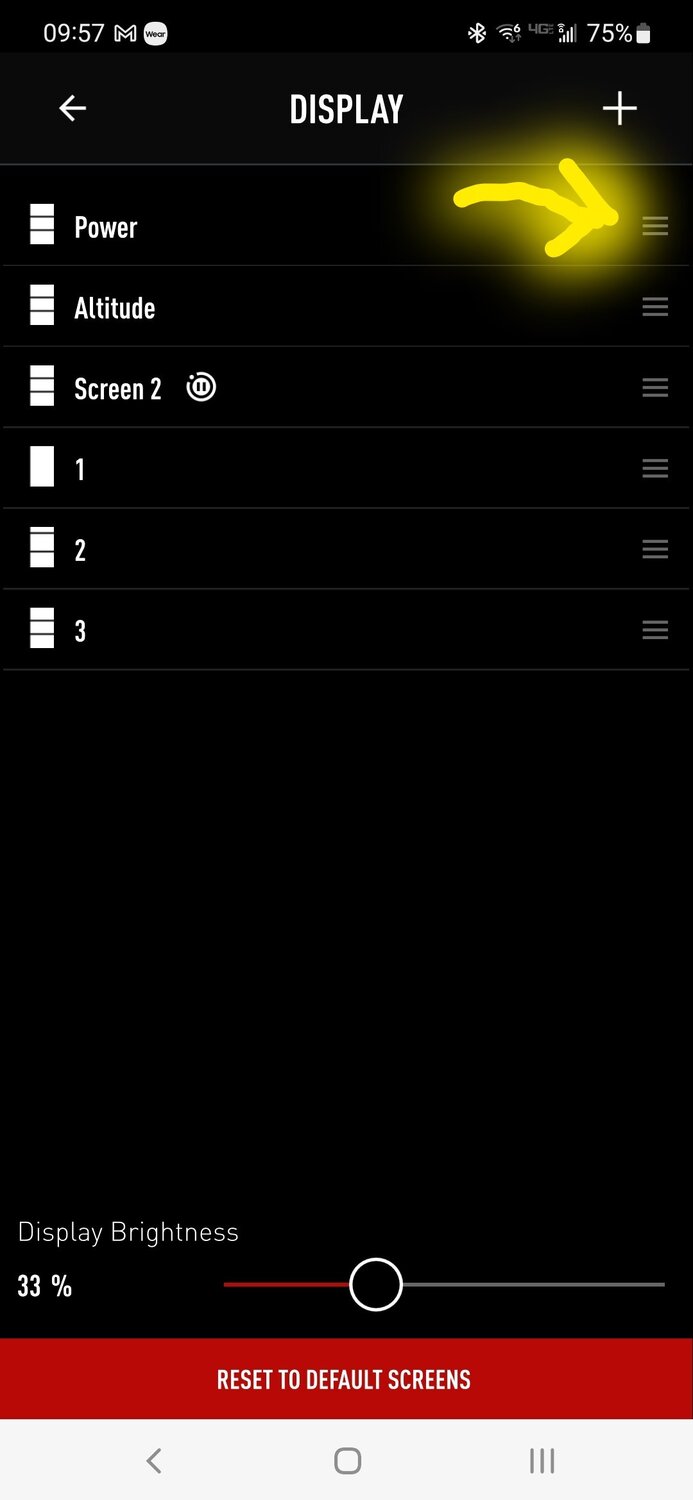

This is on an android phone.
Open Mission Control app. Turn on bike.
Select Tune
Select change display.
On that screen (image below) the listed screens are in the order they will appear on the TCU. Select the line you want for the opening default screen and drag it to the top by pressing and dragging on the three bars on the far right. Everything can be sorted like you want, not just moved to number one.
