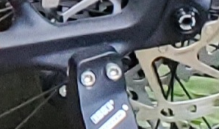

So of all these mods being discussed here, the kickstand caught my attention. What kickstand is this you are planning to buy? I hate the Pletscher kickstand on the Allant 9.9s. If the bike is pointed downhill or you give it a push the kickstand will not hold. And I lost the rubber foot as well. The Allant 9.9s has a mount on the frame for it so I figured I might be stuck with the Pletscher. So what kickstand did you find and does your Allant model have the same mount on the frame?
Alaskan recommended The Altran Rex-DV direct mount I found on Trek site. For the most part mine has worked well, but lately parked in wind I saw some teetering so I’m replacing it
