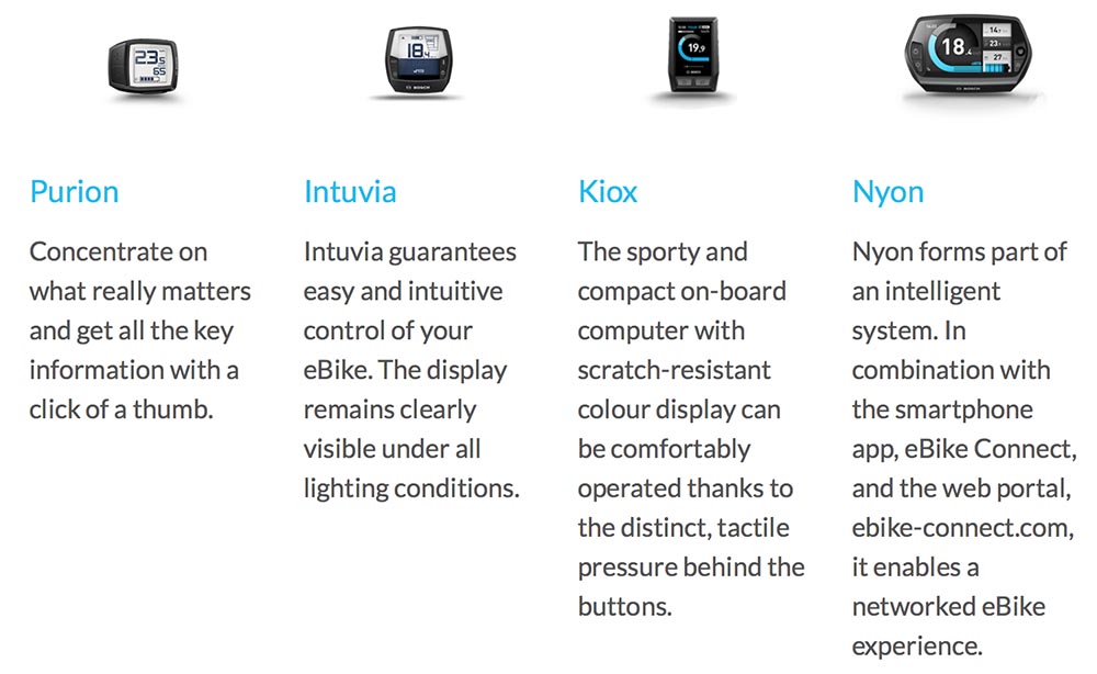

  • Does anyone know about the Kiox display?

Was the Kiox display available?
Diongi ...
I ordered the Homage with the two available options - dual battery and Kiox display. My Bosch experience is limited to the Performance CX motor matched with a Purion display which is best described as "basic" - it gets the job down but mainly it keeps the price down.
There is a little more information - and a lot more marketing spiel - on the Bosch website. Hopefully, someone (Alaskan?) can assist with a knowledgeable comparison.
Update: Court has just added a thread Bosch Announces New Kiox Ebike Display .
... David

The Kiox unfortunately is not an option for the 2019 Nevo GX Rohloff. I was looking for the added cadence and heart rate data rrecording feature. I also ordered the dual battery.
