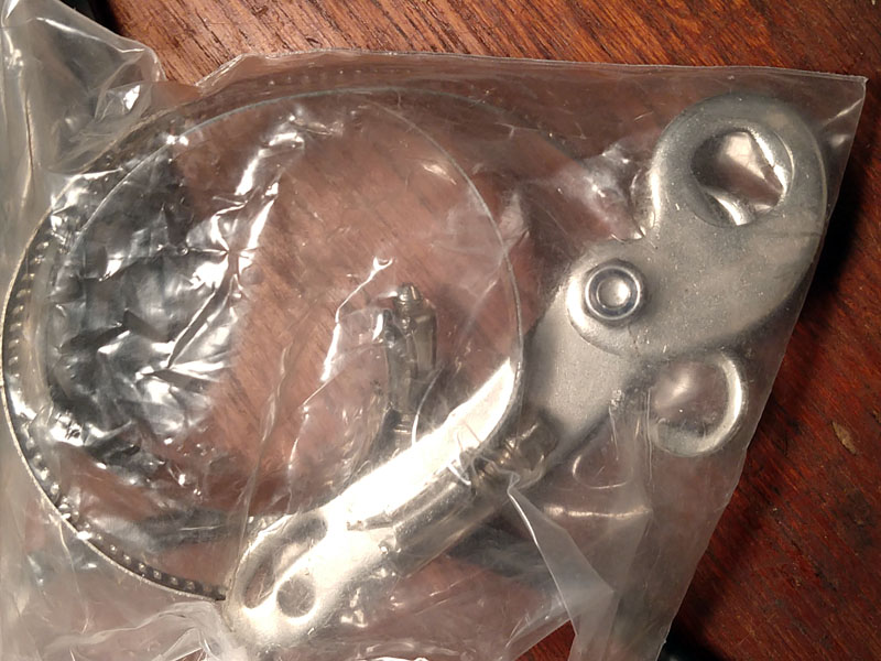

I removed all of the old hardware and replaced it with Grin stuff, (order details below.) Grin has excellent customer service, I emailed them many times even apologizing if I was being annoying, they were totally supportive and answered all of my many questions... I recommend you consider asking them if any of your hardware will work: from my discussions it seemed like none of it would work with their controller. If you tell them the *ERD of your rim they will cut the right length spokes for you to lace their motor to your wheel, you have to specify single-cross (how many times each spoke crosses another spoke) or other crossing options. I found that single cross works fine for my style of riding, all street, I haven't had any problems over dozens of trips sometimes involving going off curbs or through potholes. Their spokes worked perfectly for my wheel. I emailed the wheel manufacturer to get the exact ERD since my measurements always come up with a different number, lol. I attached a picture showing the spoke lengths they calculated for my order, and an axle stabilizer I bought on ebay as an afterthought.
