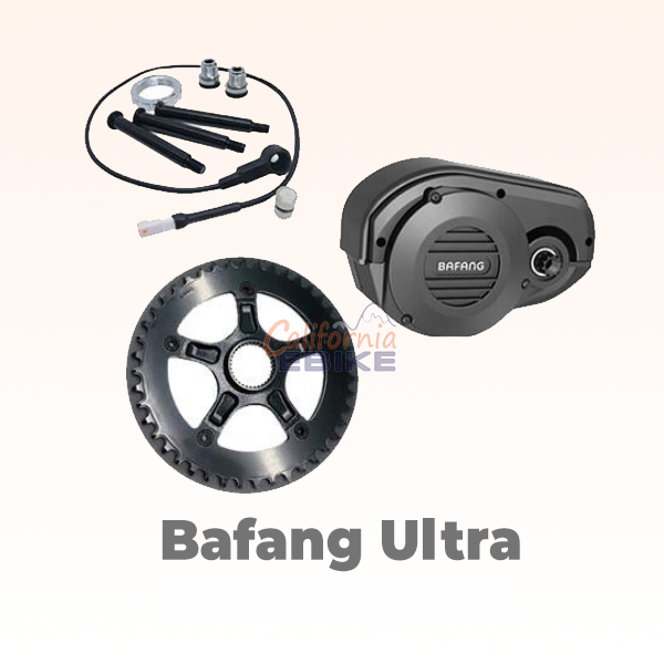

Bafang Ultra Products
Products and accessories compatible with the Bafang Ultra M620 G510 systemcalifornia-ebike.com
