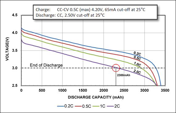

Note that the discharge rate (C) of the battery pack impacts both its available capacity and lifetime;
In this example doubling the discharge rate from 1C to 2C drops the available cell capacity by 21%.

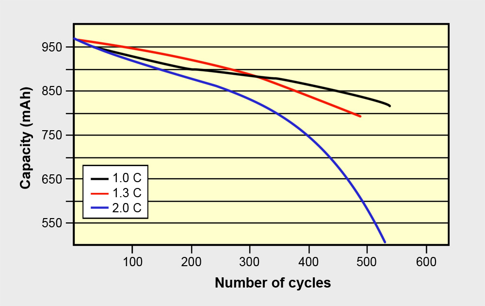

Doubling the discharge rate from 1C to 2C also decreases the useful battery life to ~450 charge cycles at 2C, ~30% less than the 1C cells. For comparison, 75% of original capacity is defined as end of useful life.

Bottom line, drawing more power from the battery pack with a re-programmed controller will improve climbing performance at the expense of battery capacity and life. How much of an impact depends on the battery capacity and its original and re-programmed power demand. For example, going from a 6A limit to 18A will have a noiceable impact on a 10Ah rated battery pack.
This can be avoided by going with a higher capacity battery pack at the same time. Kind of like a 'you can pay now or pay later' scenario. Just sayin'
