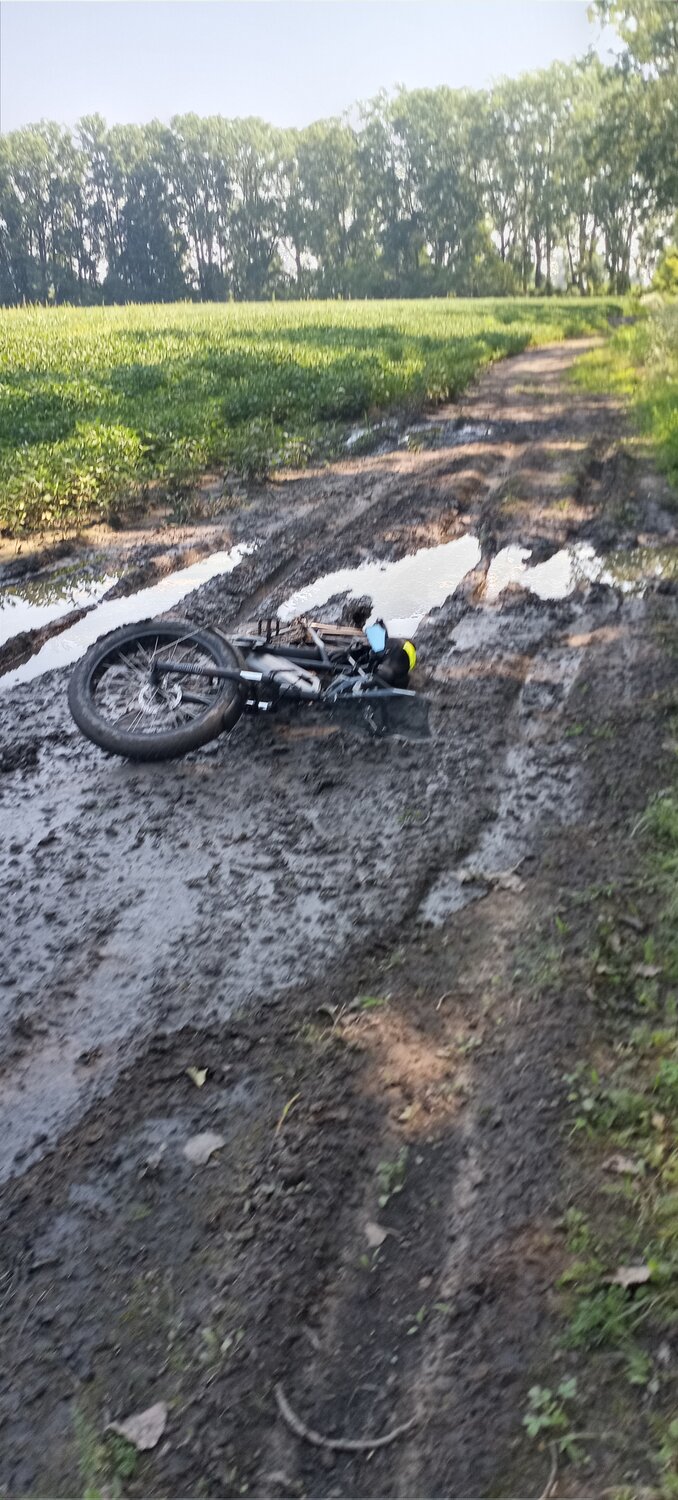

Actually, it wasn't mud at the time. I stay well away from mud after my incident last year,..
The trail had dried up hard and long grass was growing between the "tracks", so it was hard to judge the depth of the rut. It could have been up to 3" deep?

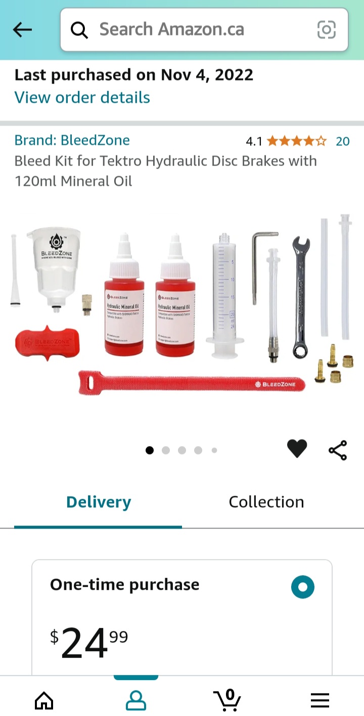

Quick update. Bought a bleed kit from Amazon. Rigged a method to hang my bike from a ladder (rear) and 1 inch webbing (front) from the rafter in the garage. Did the bleed. Lots of small bubbles. I did not do anything to the brake pads. Didn't even take the wheels off the bike. Just a lever bleed.
I found I need to push the bike over a bit to get the bleed hole in the lever to be the highest part of the system while flicking the brake lever.
Results? Much more lever. A very solid feel. However...
I must have pads and/or disc or both completely glazed. I will tackle this to see if I can get a more solid grab. Currently, I grab the brakes but the brakes don't grab the wheel.
