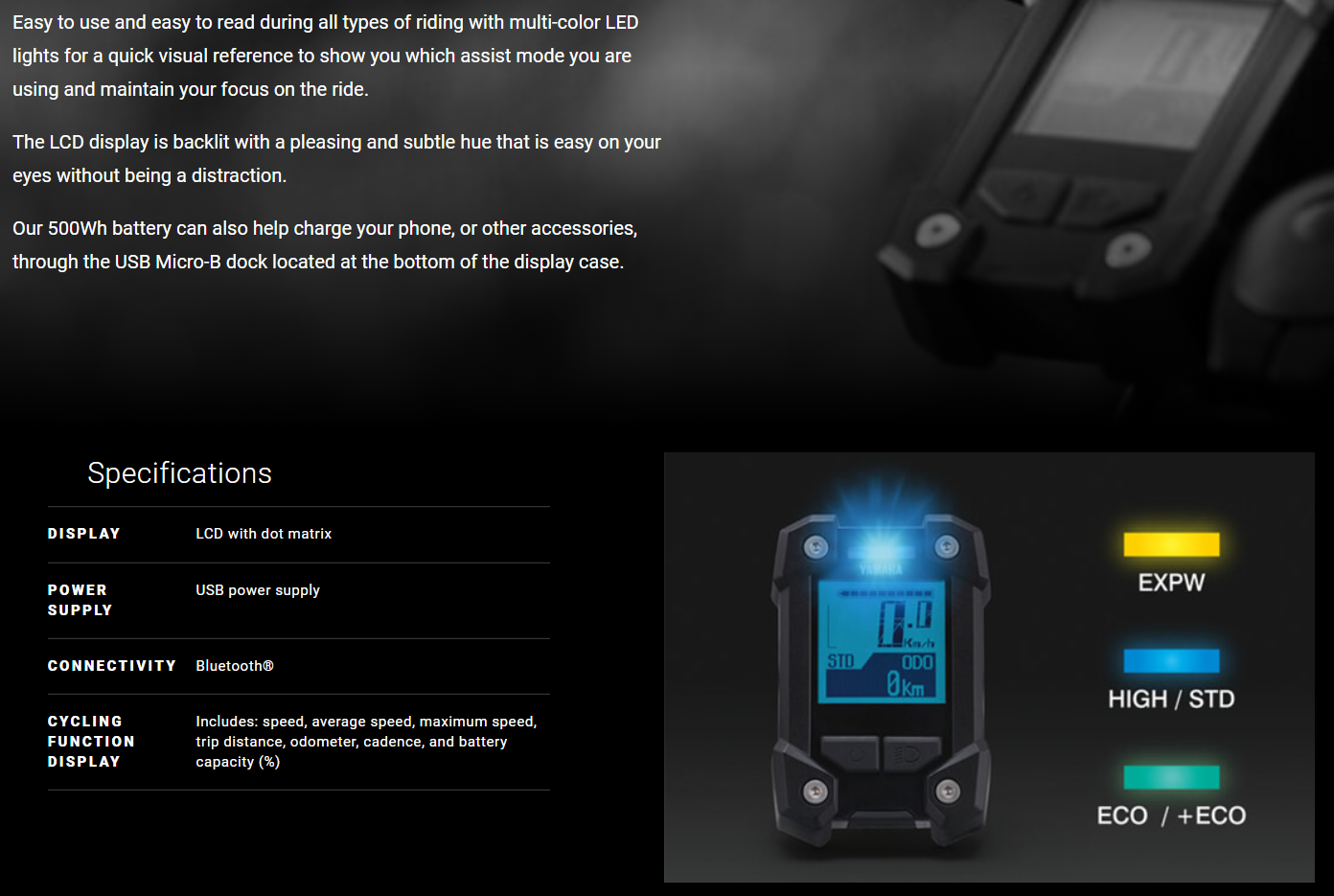

Part of me wishes the display would be a full blown cycle computer like a Garmin, but then I also know that would add to the cost and quickly become outdated, so I understand why they don't do it (but the same thing could be said of computers in a Tesla or similar...) So if it's going to be simple, then I am not so picky.
The information that can be displayed it actually a lot, just that the size means it can't display much at once, and the location and contrast means it's not particularly easy to read while riding. For example, though it can show your input power in Watts, for those doing training, etc. This can also be shared via bluetooth to an external cycle computer, which is neat.
One thing I might question is this: On the Panasonics, the display can easily be removed and taken with you just by sliding it off. I always take mine off just in case, but I have seen Panasonic bikes parked here and there, and most people seem to leave it on. I checked the replacement part price, and it's around $300, so I will continue to take mine off!
The Yamaha one is bolted on and connected by wires, so it can't come off easily. This is better for theft purposes (assuming you don't want to carry it around), but also potentially bad if you live in a place where people might vandalize it. (To be fair, the Panasonic X series seems to the the oddball, as I have not seen any other bikes where this is removable, not even their own lower end bikes).

Btw things I like/dislike about this model based on the spec sheet compared with my panasonic xm-d2:
Pros:
-display unit shows your pedaling input in watts and can share this to your Garmin unit via Bluetooth
-has usb output for charging
-unique frame design
Cons:
-Battery is not as easily removable, needs undoing two bolts each time
-Battery has no key (probably okay in Japan..)
-No built in light

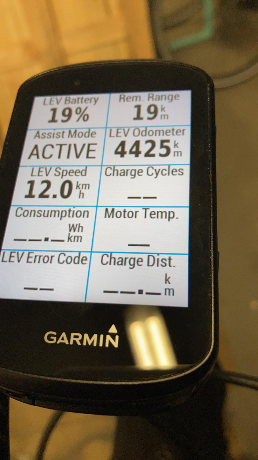

The main advantage of ANT+ is a wealth of information can be extracted from e-bike; and multiple ANT+ devices can be connected. That's the strength of Garmin.
For instance, Giant e-bikes have been equipped with ANT+ compatible RideControl ONE remote (and these e-bikes use Yamaha motors). Here's what you can get from a Giant e-bike in addition to speed, cadence and rider's power on a Garmin Edge:
It looks your Yamaha e-bike cannot offer the same...
I agree, the MT Pro does not share things like motor temperature, assist mode, etc. But those things *could* be shared with Bluetooth or ANT+.
Historically, bluetooth took more power than ANT+, so it was popular for things like heart rate monitors and speed sensors, but with BLE that is starting to change, and even Garmin has started releasing dual mode sensors now. Of course I wish my bike supported both, but my other bikes don't support either :p
You are correct, the Yamaha ebikes don't display battery%, assistance mode, battery range on bike computers. Here are some of the data fields on my bike computer connected to my Civante
