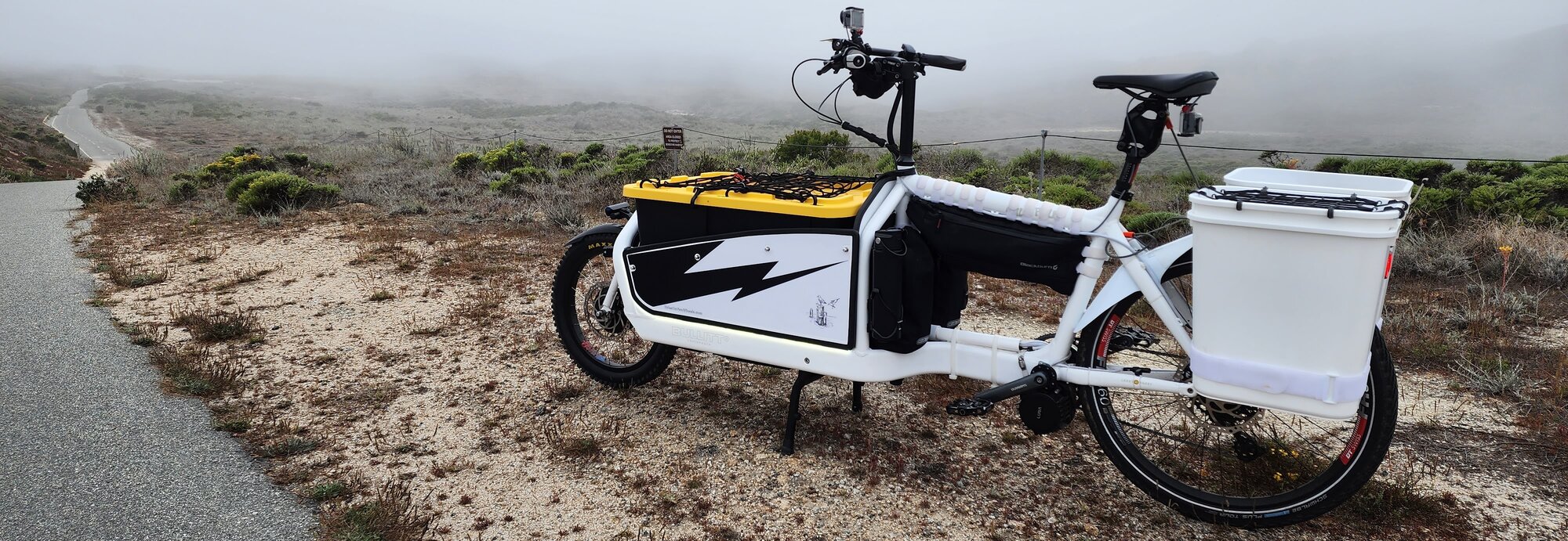

This one is my sand crawler, dedicated to recreation. But my last two cargo bikes are mid+hub as well and rely on the low-front-power, distributed traction thinking.

My cargo bikes use 45 Nm geared hub motors set to slowly ramp their acceleration curve. Similar result to what you would get naturally with a DD, which I can't use because of my small front wheel size.

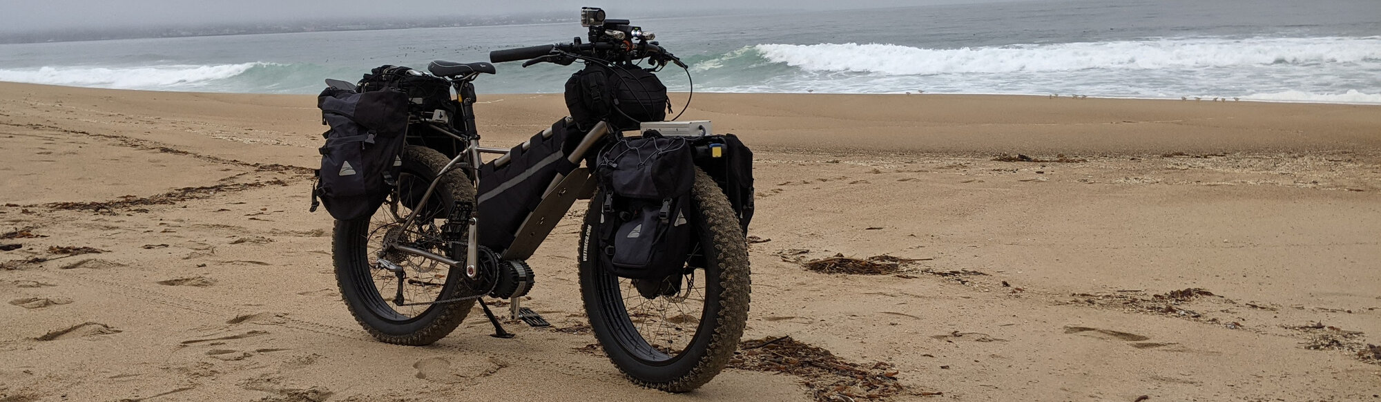

Well my 'sand crawler' pictured earlier, and my original commuter bike not pictured (has about 7000 miles on it) both have 35a front wheel controllers and 80Nm motors, backed up by a nice big 52v pack with a BMS big enough to feed both motors at once.
The key to performance with these higher torque motors is simply to set them to slow-start - a feature KT hub motor controllers have. This makes all the controller amps available to the motor (there is also a way to dial those back, too) but rolls the power on with a shallower curve. This keeps the front wheel from doing a short burnout when you decide to use front wheel throttle and also keeps you safe in case you start pedaling with the front wheel turned sideways.
Front torque on unimproved surfaces (read: trails) at 15-25% sounds about right. Bear in mind I have a BBSHD in back of the sand crawler, so lot is coming out back, especially if I have it up on a big cog. But on pavement, two equally-powered motors (I slow start the back one, too) is freaking great. No issues except lots of fun and it seems the effortless acceleration from the distributed traction is just how a bike should work.
In actual deep beach sand, the sky is the limit on front motor power. You need more, and if you hit a drift you have to climb over, its all axles on deck. Just on flat dry sand, you need the power to the front wheel to keep it from submerging. The rear wheel pushes the bike forward and the front wheel wants to burrow in (but the motor in front keeps the wheel on the surface). On the remote beach I ride, I have never seen a single-motor ebike get more than about 30 yards, and those yards were torture for the bike and rider. Me I can go until the bike runs out of battery, which is extremely bad given how remote the area is. thus I have two 16ah packs parallel'd directly together, and the beach parking lot I arrive at a few miles down has an open power plug at the bathrooms.

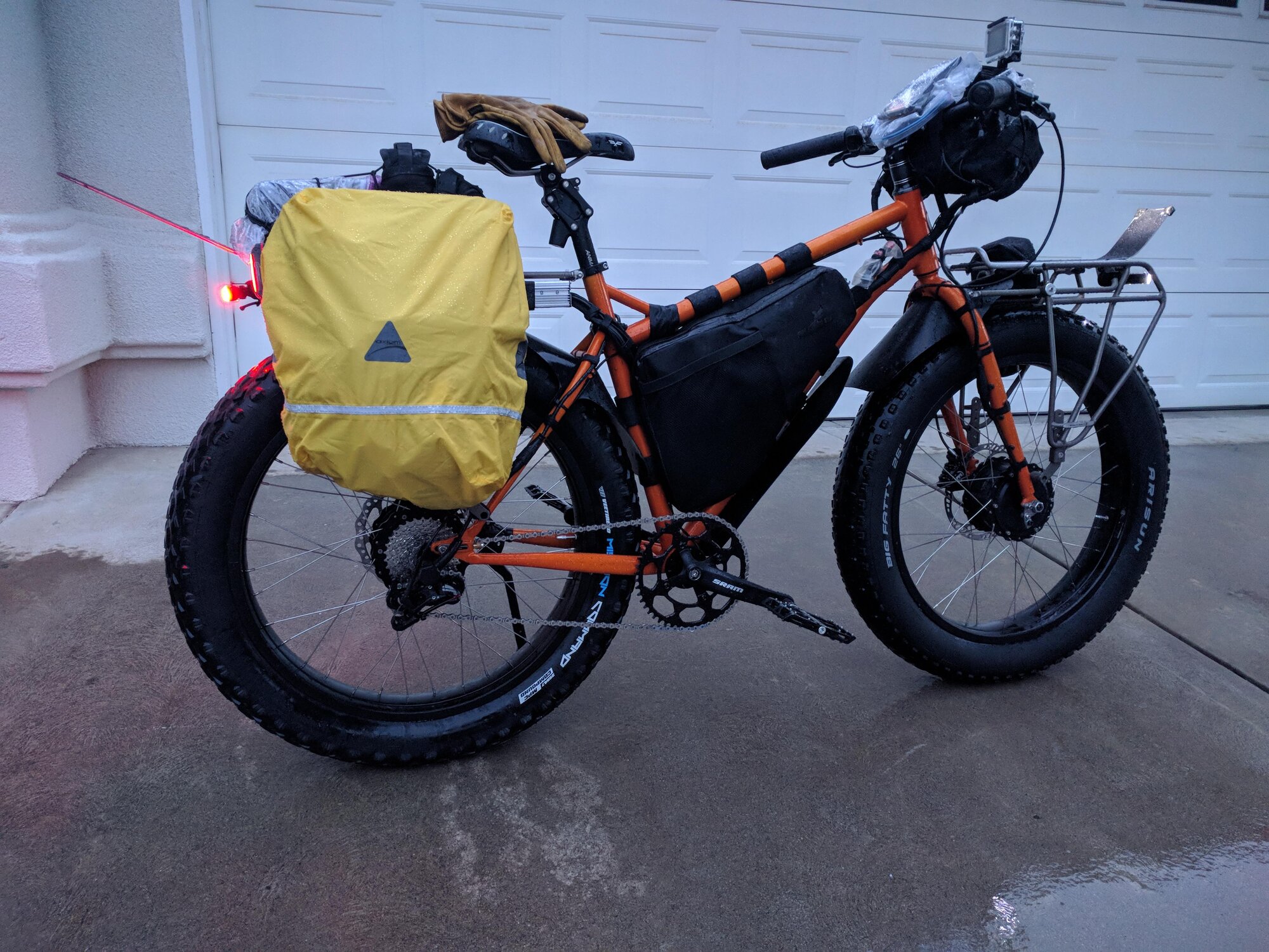

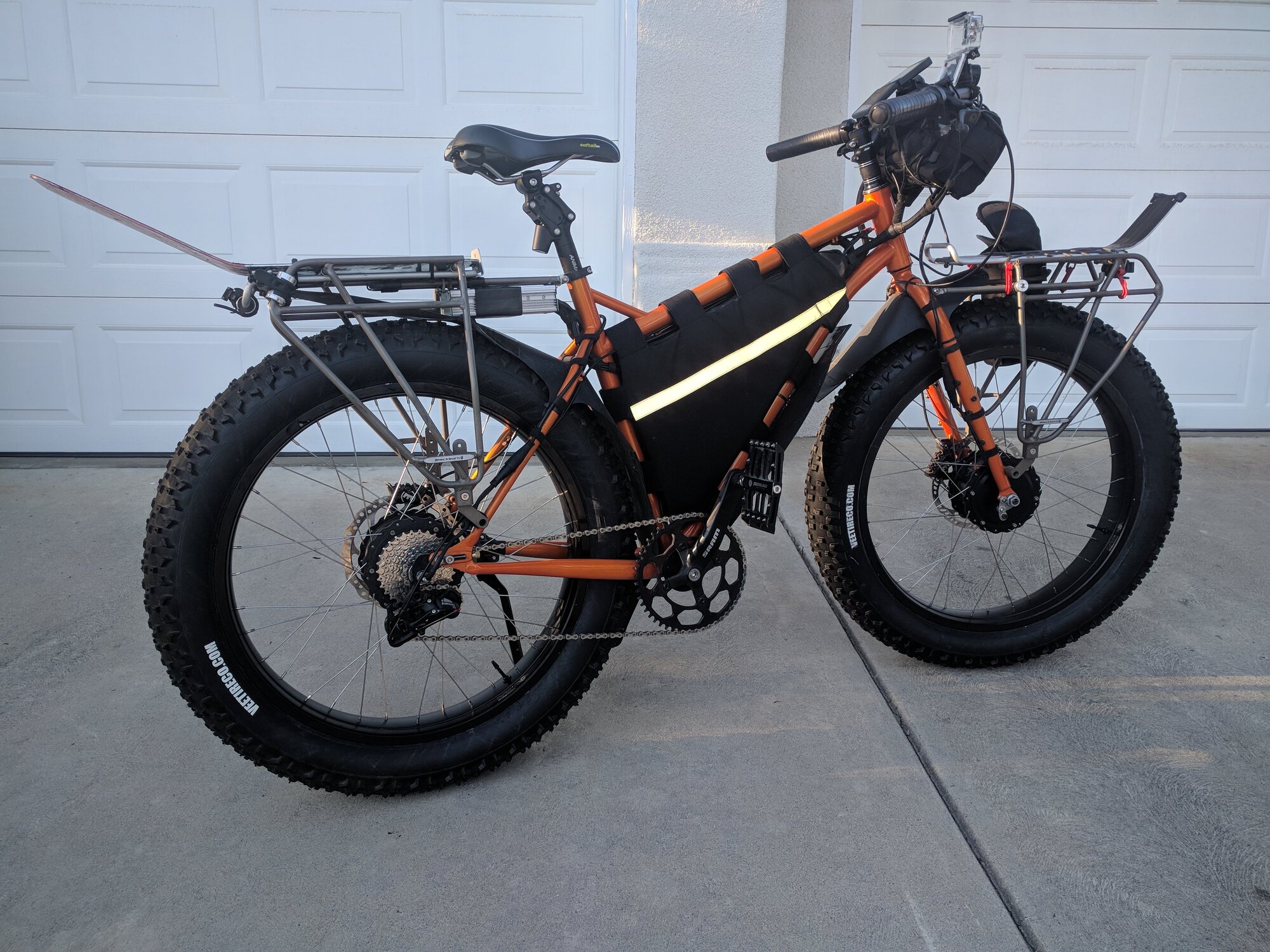

This is the commuter, running 4.8" tubeless Snowshoes.

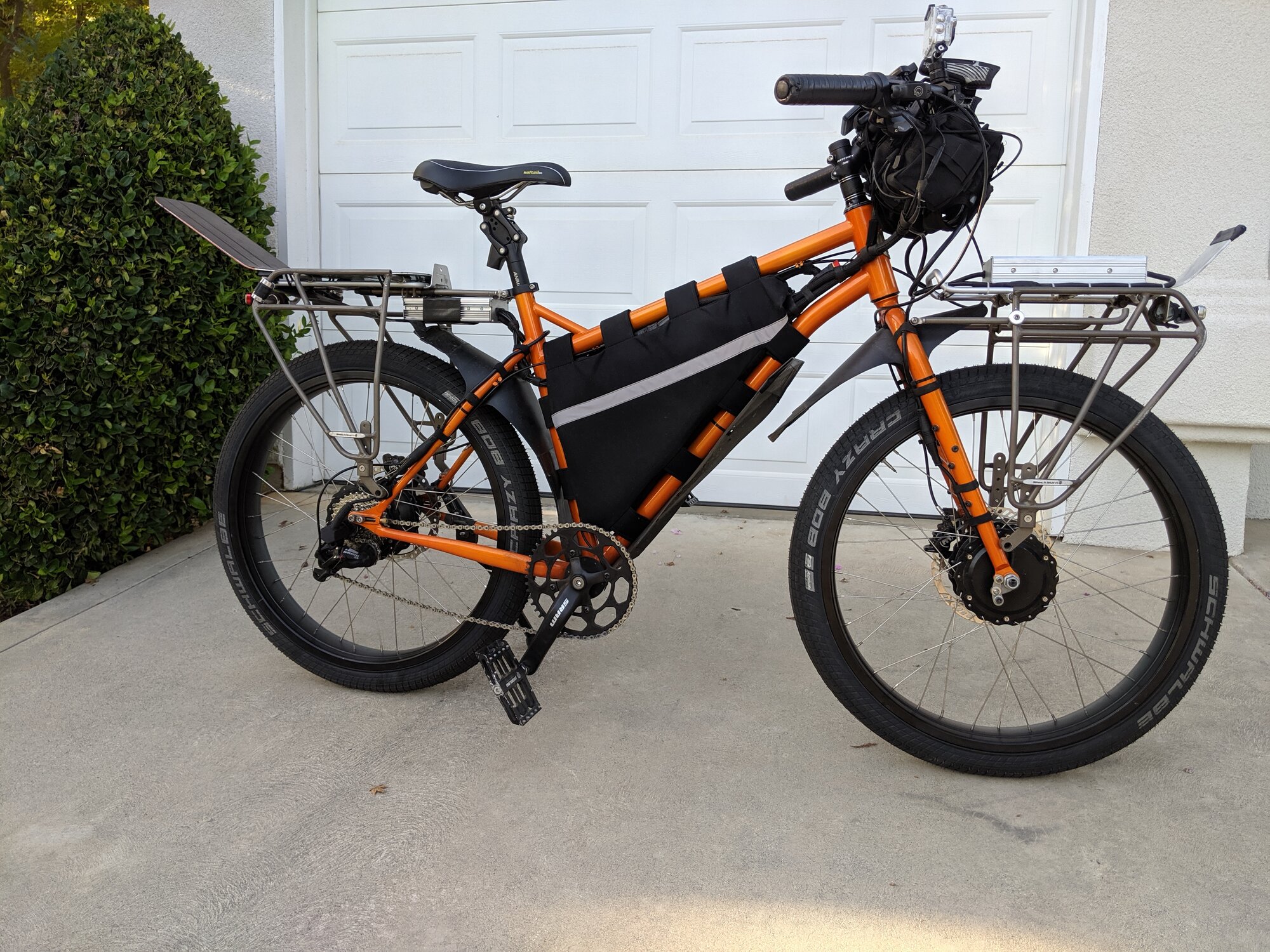

This is the commuter when I tried 2.35" tires on 80mm rims. Worked great. Rolled smooth forever. Looked stupid. Ride comfort did not exist. Rattled my teeth one time too many and changed them for slick 4.0's after a thousand miles or so.
