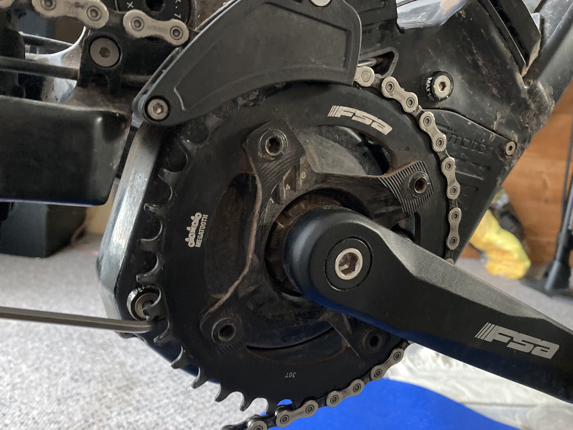

Good news, I am able to access that bolt on the drive side hiding under the chainring without having to remove the chainring, and the little plastic clip that the sensor wire feeds through is in fact split, so once I get the replacement cable I should be able to feed it through the clip.

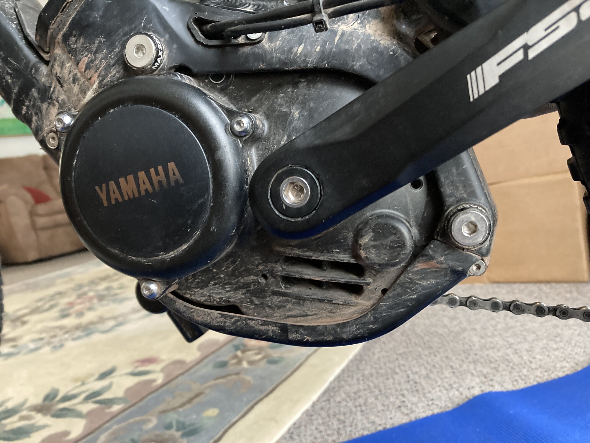

On the drive side of the bike, there is an 11nm bolt hiding under the chainring, another 11nm bolt just below the battery terminals, and five 3mm bolts around the skid plate.
On the non-drive side, there is a 22nm bolt near the back of the motor (by the rear wheel), another 22nm bolt under the battery terminal, and two 3mm bolts around the skid plate. There are also three bolts surrounding the part containing the Yamaha logo.
I am not sure which bolts require removal, but I believe I will do a better job taking my time than a local dealer will, and plan to do the job myself.
On a side-note, Mike, you mentioned that to remove the chainring from the spider I will need a special nut for taking out the PW-X crank. At some point that chainring will need replacement, as I am at 3000 miles on the bike.
I have never removed a chainring myself (on any bike), and am not sure how it disconnects from the spider, but if I need a proprietary part for the pw-x to replace the chainring, then this sounds like another guaranteed problem for down the road.
The issues I observe about the Yamaha are the same with Bosch, Brose and Shimano. Read on the ebike forums about the awful track record of the new EP8 motor by Shimano over on MTBR. It's abysmal. Link: https://www.mtbr.com/threads/new-shimano-ep8-failure-anyone-else-out-there-with-a-warranty.1182976/
This is the special spider nut gear socket that you need to remove the spider: https://ebikemotorrepair.com/product/yamaha-pw-x-and-pw-x2-chainring-spider-nut-tool/
But first, you need to remove the crank arm and this is the crank arm puller that you need: https://ebikemotorrepair.com/product/crank-arm-puller/
The chain ring is by FSA and there is a US distributor. It is where I got my replacement outer big chain ring. That ring is held onto the spider with special nuts and bolts that you can get through FSA. There is a special tool you need to hold the backside chain ring retainer nut. Park Tools likely has that. Having these tools on hand means you don't have to pay some shop alot of bucks to repair what you can do at home. I did it and I've no doubt you can, too.
Those two items are carried by the US seller who is connected with Performance Line Bearings out of England. They also carry a motor bearing replacement kit for our Yamahas in addition to carrying the main bull gear inside the motor. Take a look at their site.

you should NOT need to remove the crank to remove that 36T chainring- anything over 34 T can be juggled around to slide over the crank . At least a 34 t race face slides off easily - nb a 32 t is VERY tight but at least a one up components 32 can just slide on....

Mike,
When you dropped the motor housing on your PW motor, which bolt did you use as your pivot, to keep the motor housing from falling off? On my PW-X, on the drive side, have an 11nM bolt hiding behind the chain ring, and another 11nM bolt closer to the battery terminal. On the non-drive side, I have two 22nM bolts, one near the rear and another near the battery terminal.
Any tips in general for dropping the motor housing? I don't want to mess it up.

Bill, the pics I posted there in Post #7 are self explanatory. But in your case, the clear access I needed for the top-forward part of the motor is not what you want.
If that were my BH, I'd take whatever screws there are off from the chain ring side; then remove the big bolt that is at about the 3-4 o'clock position on the non-chain ring side. Then.......loosen up the top left big bolt......that will act as your pivot. You can even then snug it up to keep the motor in whatever swung positon you want.
Of course, the skid plate and related screws comes off first.
Just be mindful to tuck all wires back in position with a careful emphasis that the wires are not squeezed by the motor casing/motor frame bracket; when setting the motor back into it's proper position.
