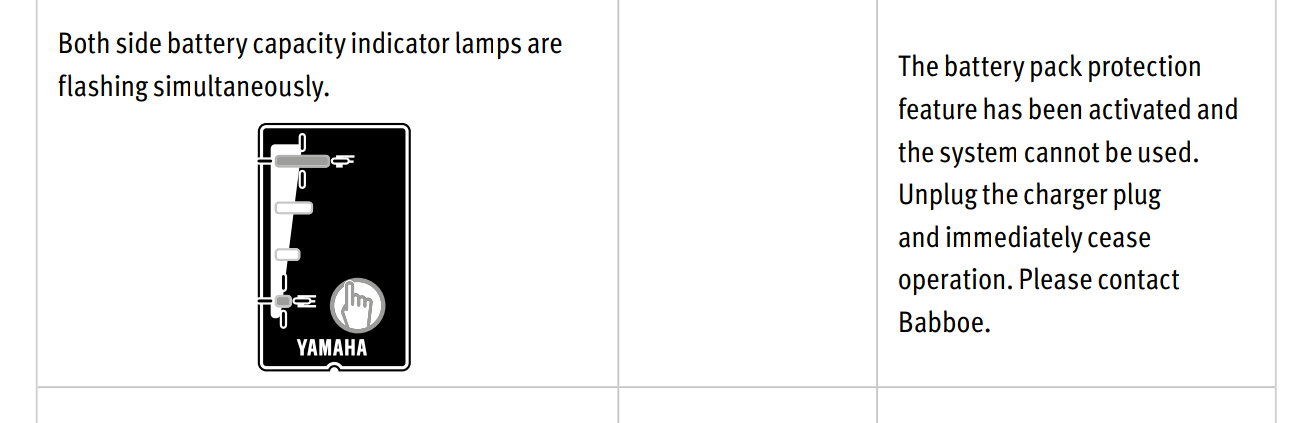

Is this a similar fault Im not sure what E and F mean except empty full?
The battery pack protection
feature has been activated and
the system cannot be used.
Unplug the charger plug
and immediately cease
operation.
Thats the error code with just E and F, if both top and bottom pair blink per 2 it would be a charger contact issue.
operation.

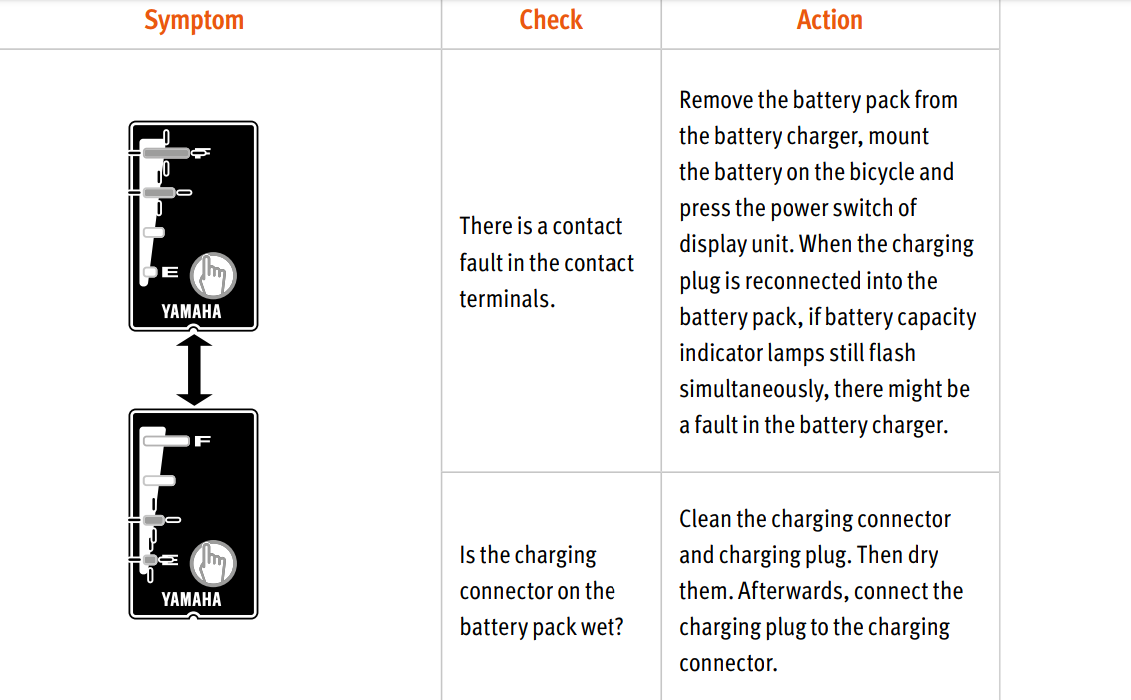

It's both the top two and bottom two lights that alternate blinking, so it is different from the picture you shared.
When I put the battery on the bike, whether it is on the charger or not, it seems to be working fine. I can use the display and motor controller normally. There is no error on the display.
Even when it is charging when the top two and bottom two lights start blinking, the display does not show an error code.
However the battery does not take a charge.
Charger connector issue
You need the Yamaha X94 service manual to access the error codes, Bill. Find a free copy of the manual on the 'net and download it. There, you will find all you are looking for.
Thanks Mike. Looks like I just have to clean the charging connectors. Anything special I should use for that? 90% isopropyl alcohol? How many miles do you have on your fatbike now?
I'll second @DaveMatthews suggestion of Deoxit. But I do question just how corroded these terminals really are. I highly doubt you are pedaling in a salt water environment nor leaving the charger and battery in a humid situation. Those battery terminals are well plated and require no lubrication whatsoever. Ditto to the charger. Let us know what comes of this.
