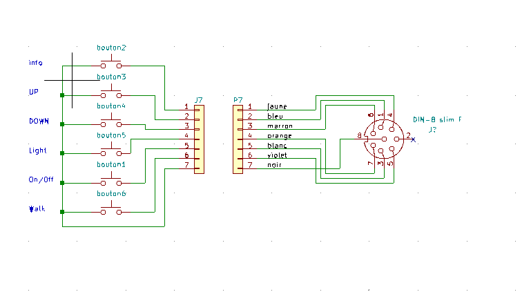

I like my BH gravel X with PW-SE motor but a major flaw is the walk assist is disabled, as on some other brands of bikes that use the Yamaha drive. I've searched the internet in vain to find a solution. It seems that Yamaha and others have implied that it is a firmware programming issue due to the end brand preferences and there isn't a way to reactivate it. But looking up the PW wiring diagram took me to Speedbox where they state that the Speedbox can be activated by the walk button unless the walk button function has been disabled. Is it possible that it is a wiring/hardware issue rather than firmware? The easiest way to disable it would seem to be to delete the pins for the violet wires in the harness connector?

Has anyone else checked the wires and connectors on a bike with this function disabled (maybe while they were installing a speedbox)?
