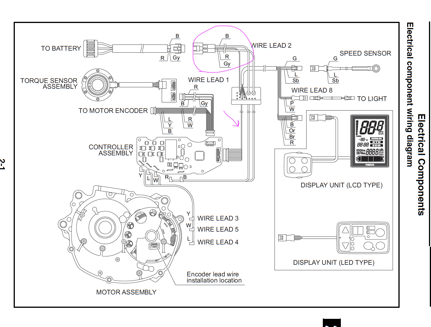

Hi,
I have a plan to clean up my bike cockpit and put all cables and wires inside handlebar. But... Yamaha Interface X has two part - switch and display and I have to disconnect these to put wires via holes in handlebar and connect it again. Did anybody tries to do it? Have you electrical diagram of this system? Have you a method to open switch unit? Oranother way - where can you buy micro connectors to connect the cutted wire.
Thanks in advance...

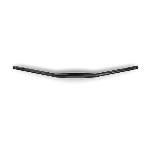

Hi, I didn’t have to drill anything because the handlebar already had the necessary holes for routing the electronic cables. The only holes I had to make were for the brake cables. I already had the X Interface with the bike, and I use Bluetooth with my phone instead of a Sigma display, which is convenient for navigation on longer rides.
