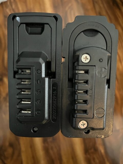

XP 3.0 on left XP 2.0 on right
Again, first batch, just asking if anyone received one of these besides me.
And they are both Lectric XP battery's, Not XP step-thru

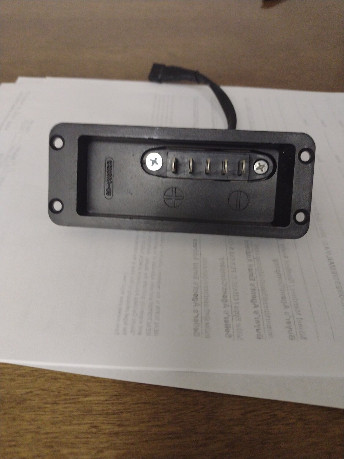

Looks like either battery would work in a 1.0 or 2.0. the 1.0 discharge port below is pretty wide open in the center. I have several like the 2.0 pic ebikencleveland posted and they work in the 1.0 XP. If the early 3.0 came with a different discharge port then I could see how the center might be too narrow top to bottom or even side to side to handle the standard batteries. If you have this problem on a 3.0 bike I would like a pic of the discharge port for documentation and will get clarification from Lectric then post . They definitely feel that the current XP 1.0, 2.0 and 3.0 batteries should be interchangeable as that is how they list them for sale. My guess is they'll send a replacement discharge port like the one below for anyone having an issue. On the 1.0 the port is easy to change, just 4 screws and plug the new one in. Seems weird they would send a $300 battery to fix instead of a $5 connector.

Those don't look interchangeable to me.
No, they are not. They said they would send a plate, u will have to change every time u switch batteries between the XP 2.0 and the XP 3.0 battery's :-(
But they do not have plates or a compatible battery for the first batch of XP 3.0 yet
Yes, u are correct. They said they would send a new plate, when they start to make them. No ETA yet. Pain if have to switch plates
every time u change the 2.0 battery and the 3.0 battery on the side of road even if takes 3 min. Not home, cannot take picture.
