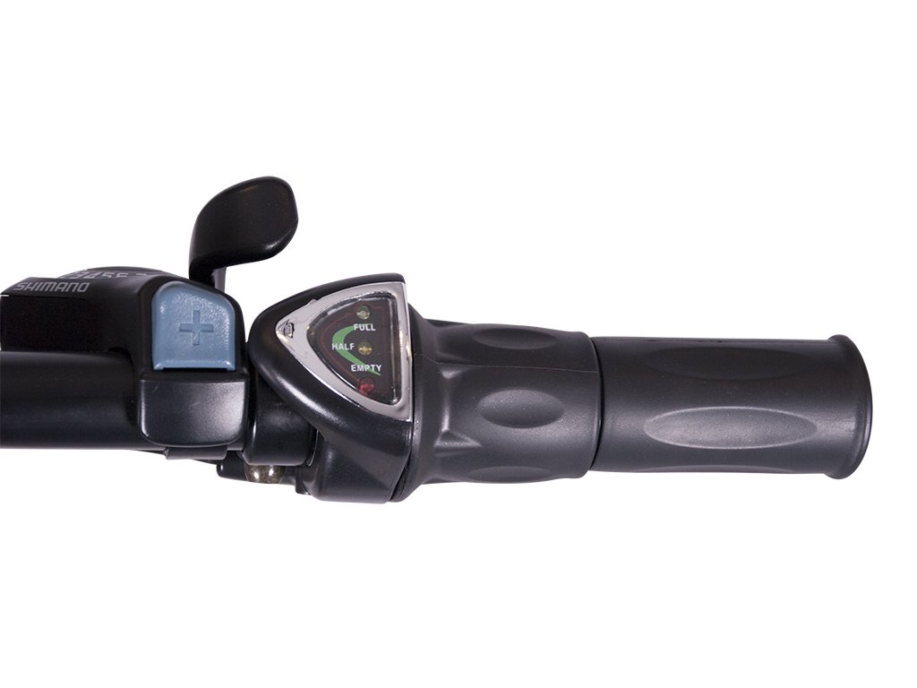

When you use the throttle while riding on the road, does the battery gauge dips down to the red color?
Or does it have a battery gauge at the handlebar?
No battery gauge on the handlebar on this bike. Only on the top of the battery which is behind the seat post.
