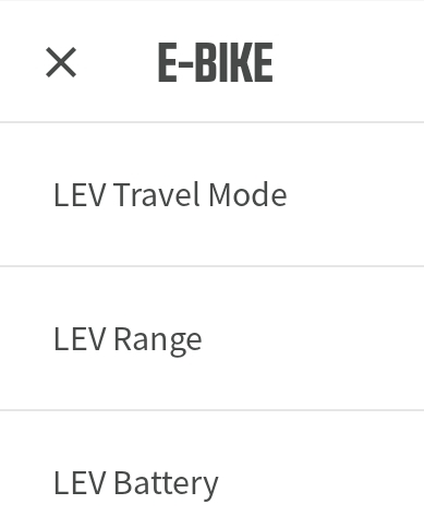

Wahoo shows the following e-bike data:
  • LEV Travel Mode: it is read from a specific e-bike type (so it would be SPORT on Vado/Como/Creo/Tero or TRAIL on Levo/Kenevo, or Giant specific name on Giant e-bikes)
  • LEV Battery (showing the internal and RE levels individually)
  • LEV Range (only for e-bikes supporting it, that is, Giant or probably Specialized Mastermind TCU).
Verified for Wahoo Roam v1 and v2, Bolt v2.
Interestingly, the Smart Control is displayed as SMART on Vado SL but TURBO on older Vado :)

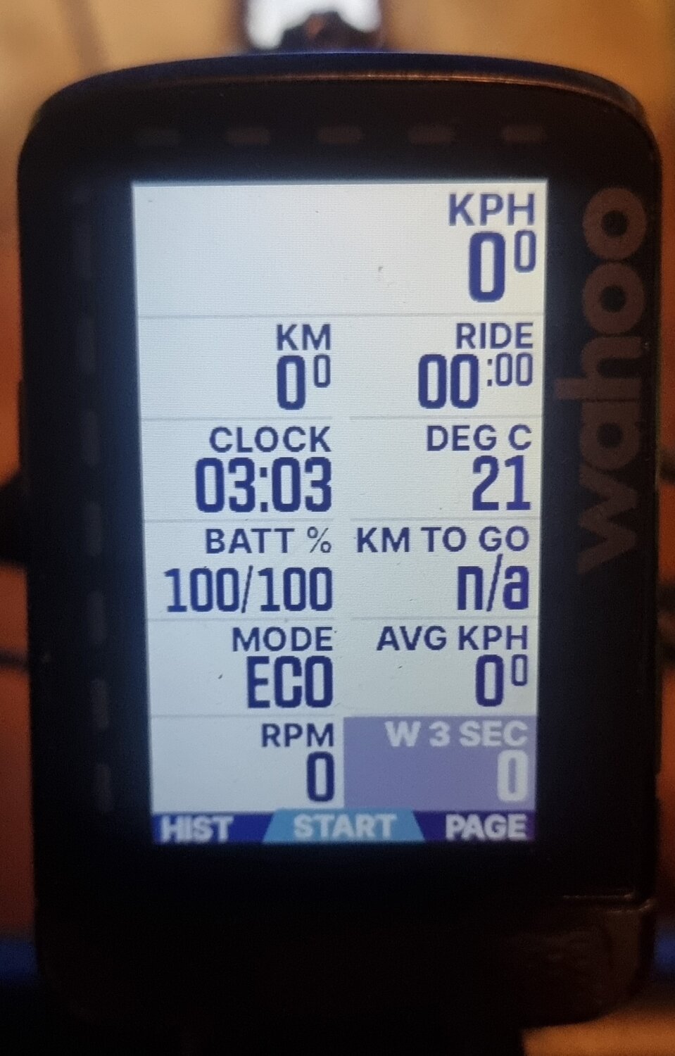

Oh boy. Now I’m learning that Wahoo is better than Garmin for the Creo because it will natively show me the assist level and both battery levels. In 5 seconds of research looks like the Roam V2 is the nicest one.

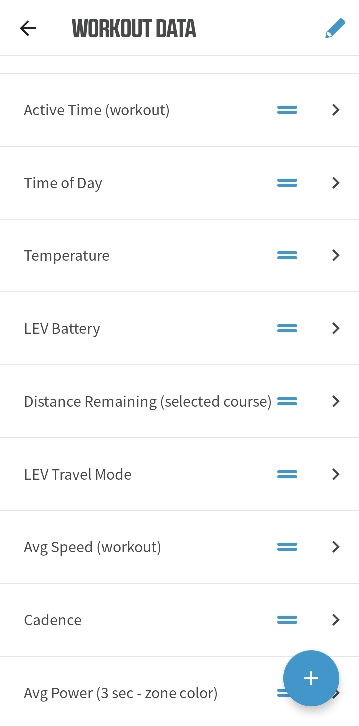

Well if i can get my power on Creo, percent battery for both batteries, and assist level on Wahoo out of the box, count me in.
Well... 😊 Not out of box; you just select up to 11 desired data fields for the Workout data page using a smartphone app:
E-Bike Data.
I have shown 9 of 11 available data fields for the Roam Workout data here (still in the app). My screenshot does not show the current speed and distance ridden here.
Whenever you are making any change in the app, the Wahoo screen reconfigures in front of you.
You can add any desired fields to Summit, Lap Data, or Strava Live Segments data pages as well.
