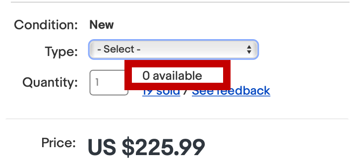

Would either or both of these ebike batteries be OK ?
https://www.ebay.com/itm/313541943085
That price is for the 10Ah battery. The 20Ah battery is around $320.
