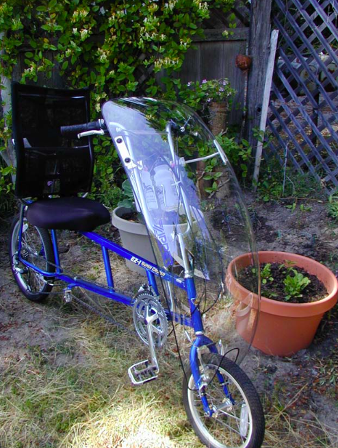

The new trike will have a winter fairing. Not my trike but my fairing will be VERY similar.

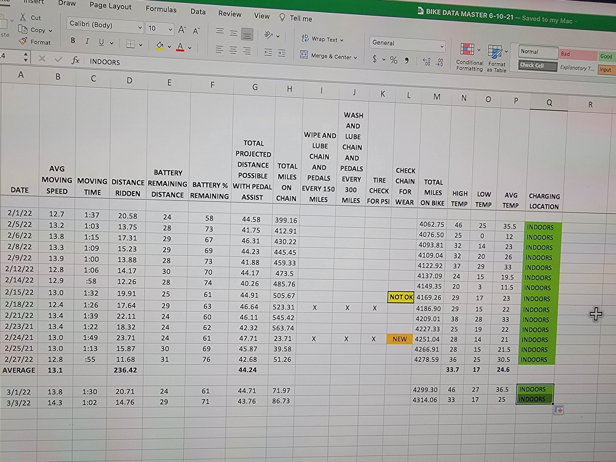

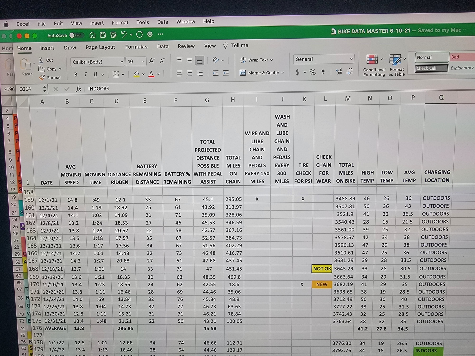

It is okay to "run" the battery in temps below freezing. I have kept extensive records since purchasing my ebike. The batteries range is effected by colder temperatures. I see a 15-20% decrease in range from warmer months to colder months.
In January 2022 I began charging the battery indoors to protect the battery per the manufacturer (Bosch). I have seen no difference in range by charging the battery indoors.
December 2021 the average temperature was 34.5. The battery was being charged outdoors in my shed. The average projected range was 45.58
January 2022 the average temperature was 24.8. The battery was being charged indoors in my house. The average projected range was 44.31.
February 2022 the average temperature was 24.6. The battery was being charged indoors in my house. The average projected range was 44.24.
So January and February 2022 was 10 degrees colder than December 2021. The range was consistent over the three month period whether the battery was charged indoors or outdoors.

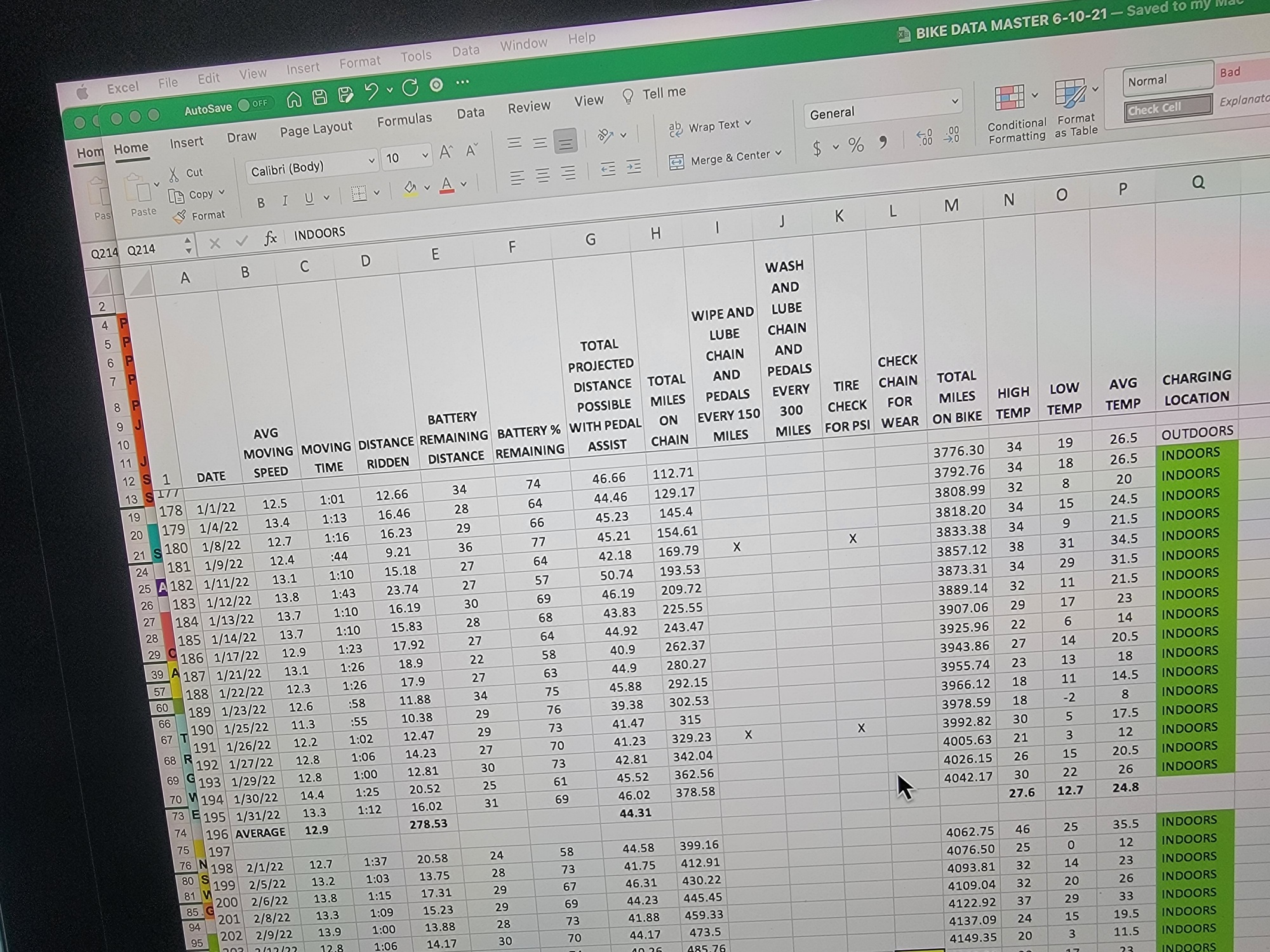

I have attached three months of data from my rides.
The computer in the battery is very smart. It will give a projected range for each ride and it is generally within a couple of miles of the actual range attained. Granted there are lots of variables such a wind, hills, boost, etc. but in general the battery computer projects distance at the beginning and during the ride very accurately.

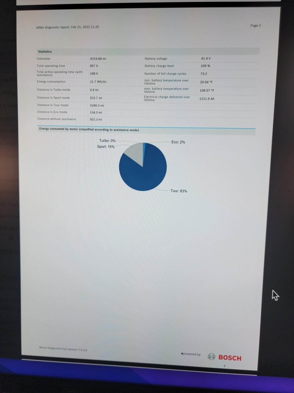

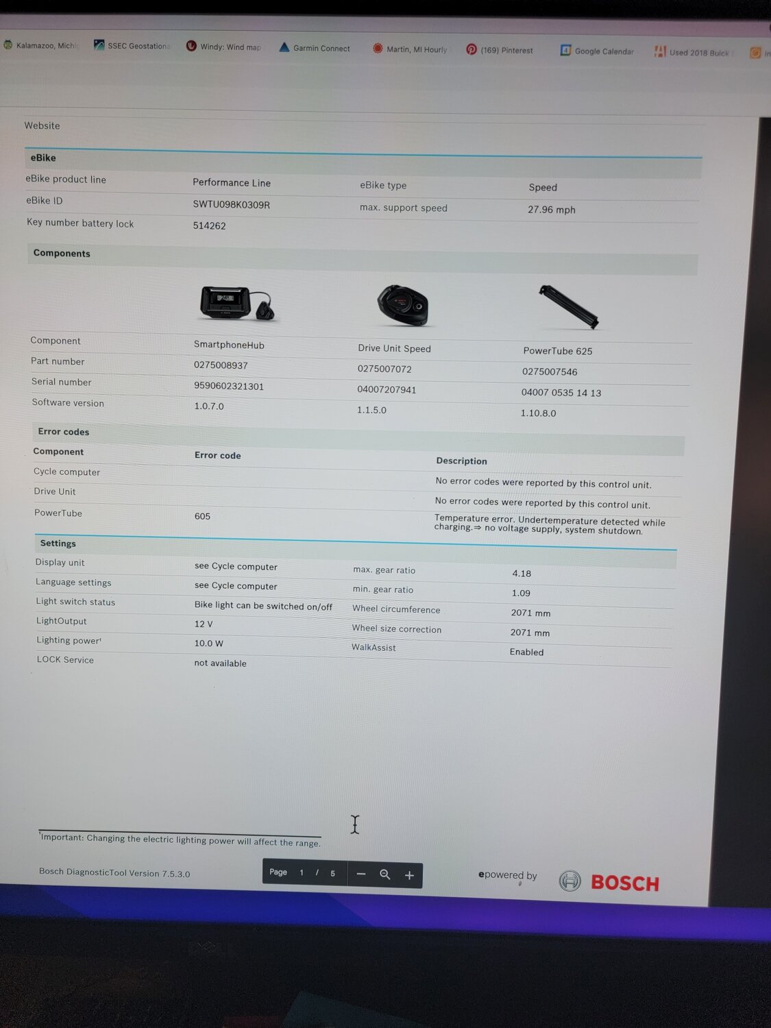

The battery in my Trek keeps track of a lot of data. It has a temperature sensor that collects data on the battery when charging. I got a printout of part of the data that is available. I have attached several pictures of that data printout.
