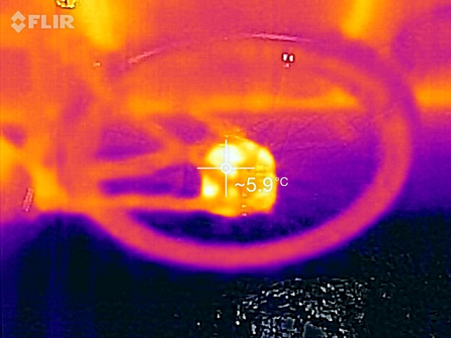

Motor temp immediately after ride, outdoor pic. For reference, the bike frame and wheel should be around +4 C here, and the ground is subzero (actually ice). Reading might be inaccurate.

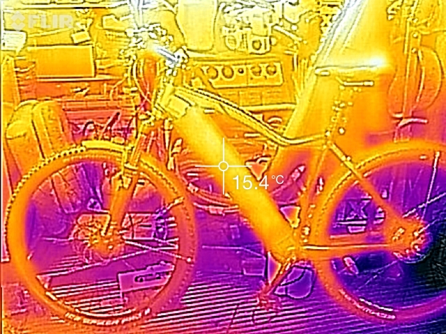

A minute later, bike indoors, cover still on, warming up towards ambient temp (15C). Fenders are matted plastic just like the battery, for emissivity, scale and reference. Though this won't be an exact science.

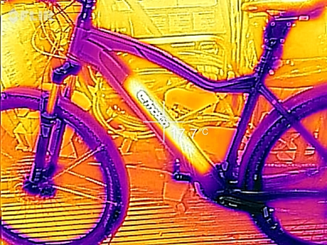

Cover off, battery temp (gain?) 17.7 C, clearly warmer than ambient. Notice how the underside of the alloy downtube has transferred the outdoor ambient temp almost uniformly down the frame, despite the thick protective cover. So the downtube is a bit of a heatsink for the battery, though the rubber pads on the battery and the gap between the battery shell and the bike frame should help isolate the battery from the cooler frame.

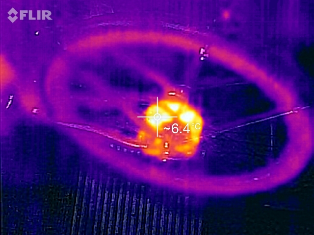

Again, motor immediately after the ride, outdoors pic. Reading is inaccurate, but obviously some heat generated and sustained by the motor even after a long ride, so definitely not just residual indoor ambient heat stored in the dense mass of the motor.
Cool is good for electric motors, but I wonder how the plastic planetary gears do at even lower temperatures, like -20 C.

Cover off. Almost right on the money compared to my earlier short 7km run: 18,3 C. So stopping briefly or taking a long ride will not kill the battery temperature so long as the current draw (resistive heat), thickness of insulation and outdoor ambient temperature meet optimally, and the battery temperature neither plunges nor climbs. Near 20 C is the optimal operating temperature for many li-ion batteries, and is achieved here by pure coincidence.

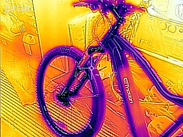

The bottom bracket seems to be one of the coldest spots on the bike. Possibly due to mass and the cable holes on the underside that let cold air circulate within the frame.
