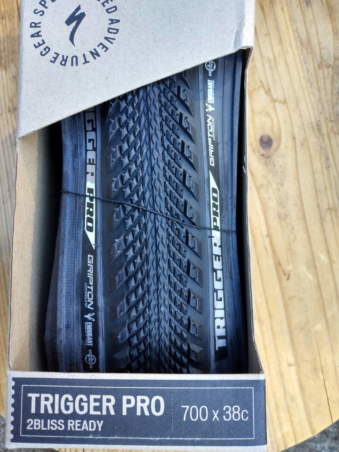

The one tire that I've installed that was actually tubeless ready went pretty easily but I wouldn't have wanted to do it without an air compressor. Trigger pro just delivered, hopefully it will go on just as well.

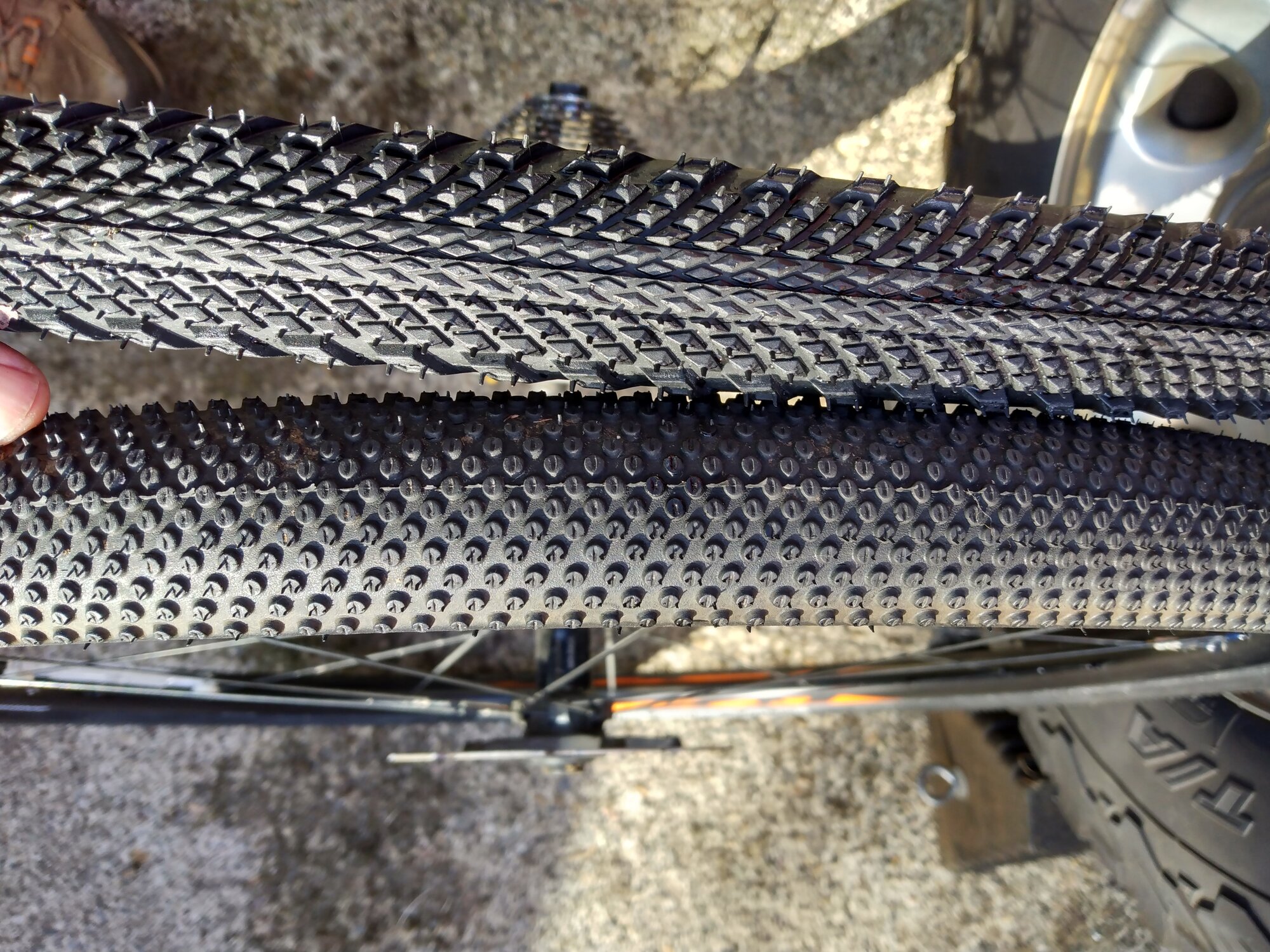

I thought the G-one went on easily enough but the Trigger went on even easier. Just minutes and no leaks whatsoever with soapy water test.
At 50 psi measures 36.5mm on a 17mm i.d. rim, about 2mm narrower than the 700X40c Schwalbe.

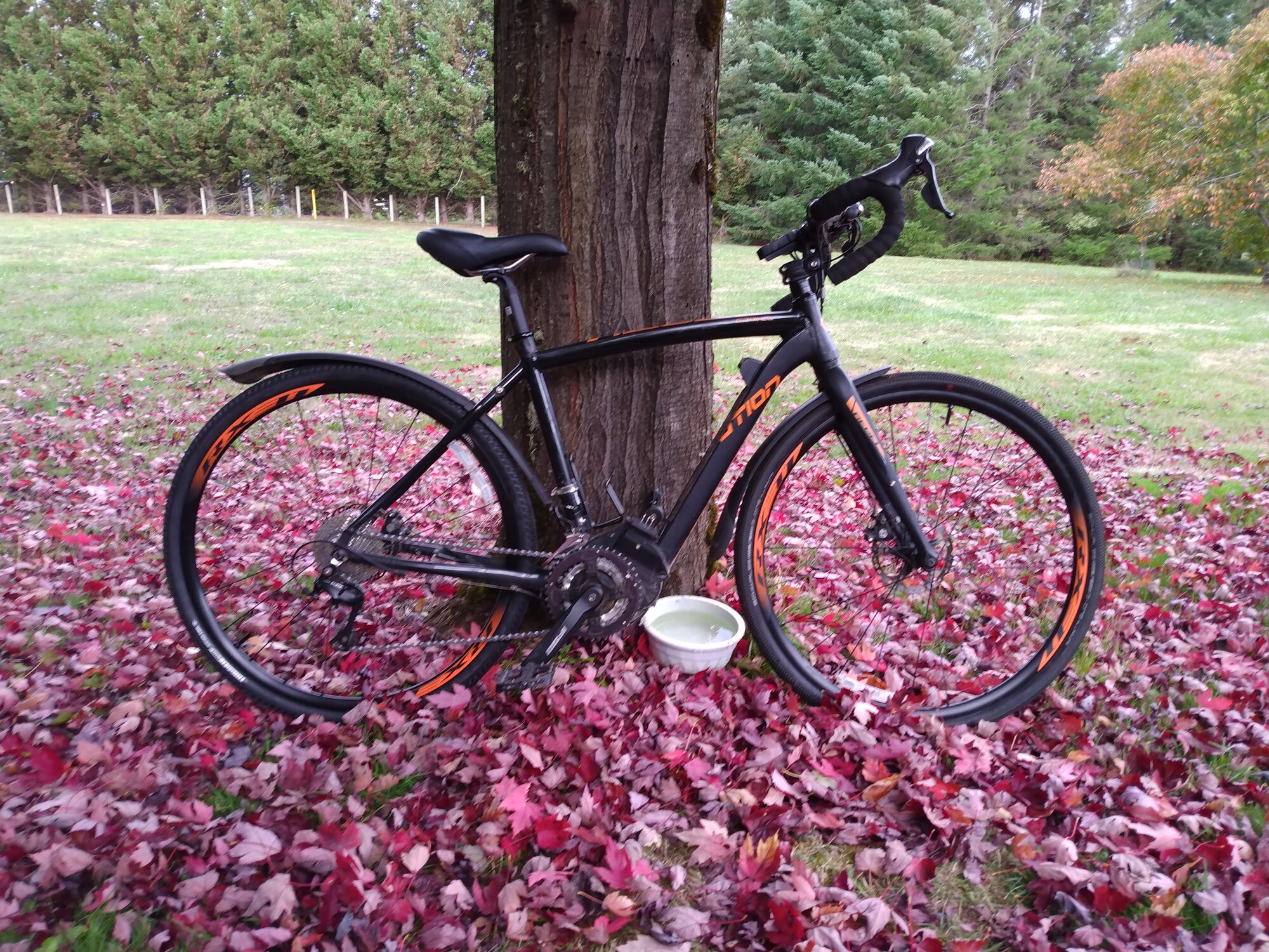

It's a 2019 BH gravel bike with Yamaha PW-SE. Nice bike with the exception of walk assist having been disabled by BH. I'll never forgive them for that.
Seems to be more road bike equipped including Shimano 105 derailleurs and narrow rims.
Trigger pressure range is 45-90psi, Specialized recommended running in that range including tubeless per the tire review video on their web site. G-One pressure range is 45-70psi. Doesn't handling get squirrelly at lower pressure and increased rolling resistance at lower pressures? Not great weather today but I plan on riding with different pressures to see what it feels like.

The Trigger pro works well for me, about 25 miles 50:50 mixed asphalt and smooth gravel. Holding pressure steady at 60psi for about a week as is the G-one tubeless with gorilla tape and orange seal. I like it and it was inexpensive

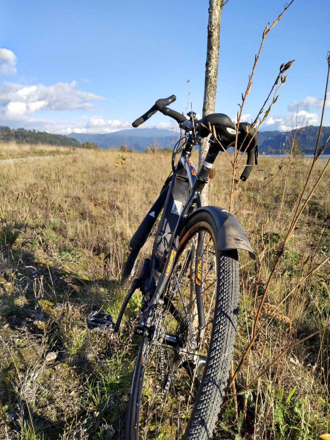

I’ve got 47mm Tracer Pros on my 2023 Vado SL 5.0. The clearances are a bit tight, 3-4mm at the fork.
