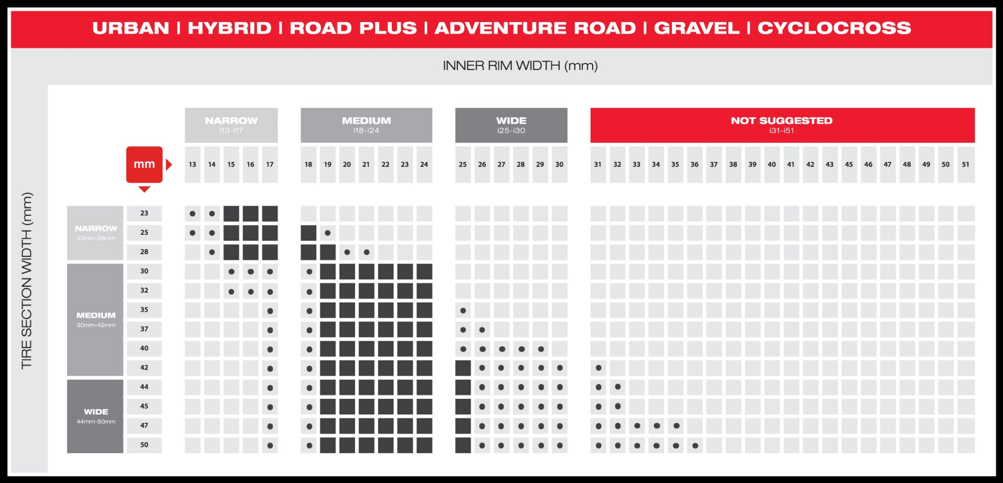

5.0 rims are 22 mm internal width, 23 mm depth. 4.0 rims are 21mm width, 22mm depth. How to determine tire/rim compatability.
Going the other way, what would be the widest tires? I guess frame and fender (if eq) would be considerations as well. Any good 700c tires for off road use?
You should be fine with the 28mm tire on the 21mm rim width, not the 22mm rim width ... see the attached chart for tire/rim fit guidelines. 😉
