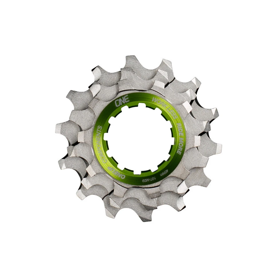

The XTR freehub body is quiet coasting. Very smooth. Hunting quiet, spooky quiet. Use the e-11 chain for a high class build. The 10-T cluster can be changed without a new cassette with each new maintenance chain on the XTR.
I have 2 sets of replacements for the four smallest cogs. I have also installed an Onyx instant engagement sprag clutch hub that goes silent while coasting. I also added the Sram wireless AXS 12 speed derailleur which is just as easy and cool as it seems.
