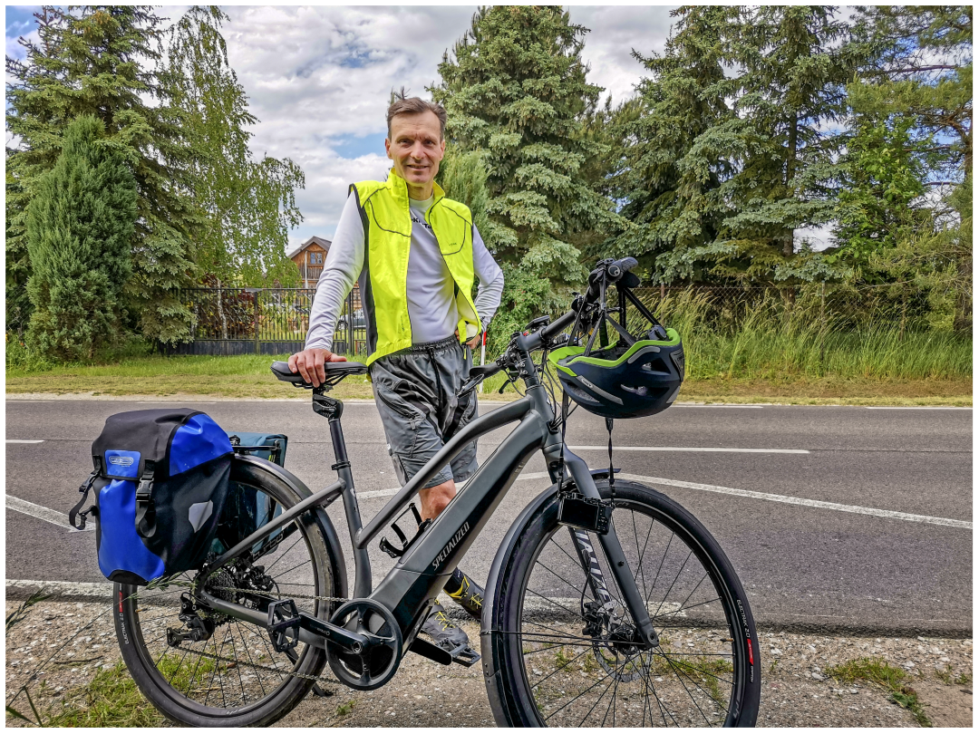

My 2020-upgraded 45 km/h Vado, fully street legal in the European Union. 5978 km ridden in 15 months, zero issues.
