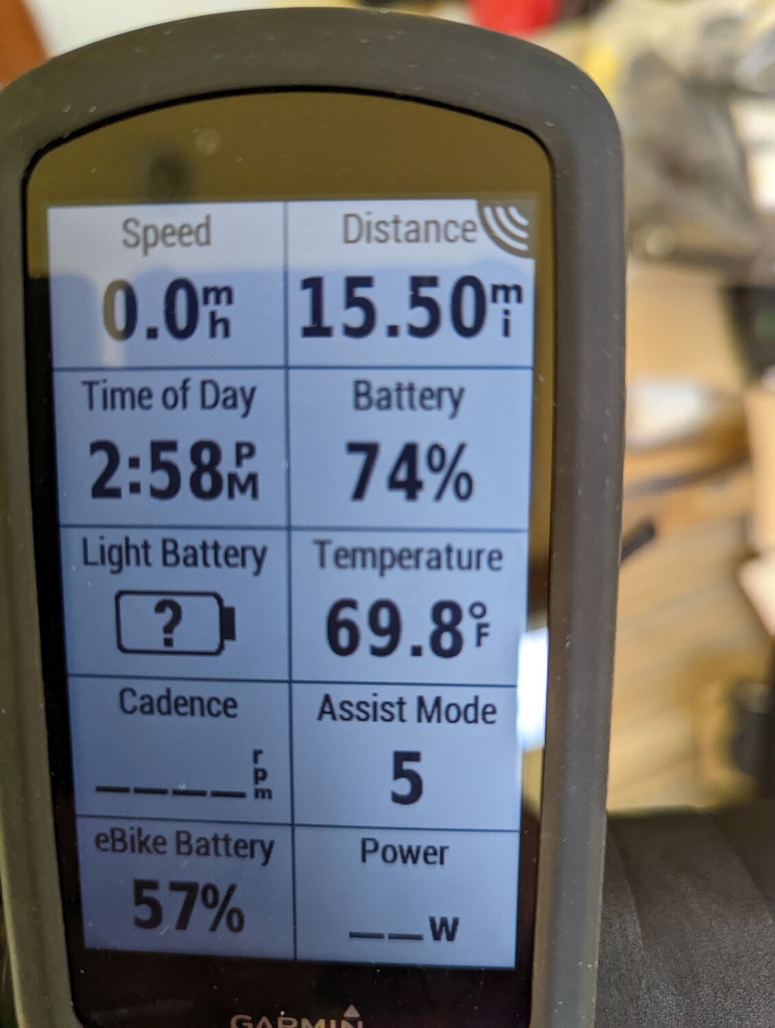

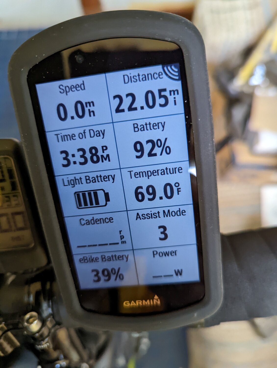

Garmin 1030+ and Specialized Creo.
I chose the e-bike sensor and then picked fields that made sense, kind of. Before going the e-bike sensor route, I did pick other sensors and I believe it showed Cadence. I don't recall about Power. There must be 20 or more POWER options like 10s and 2s and other arcane options.
I accept that Assist Level is for another model as it increments: 1, 3, 5, rather than 1, 2, 3.

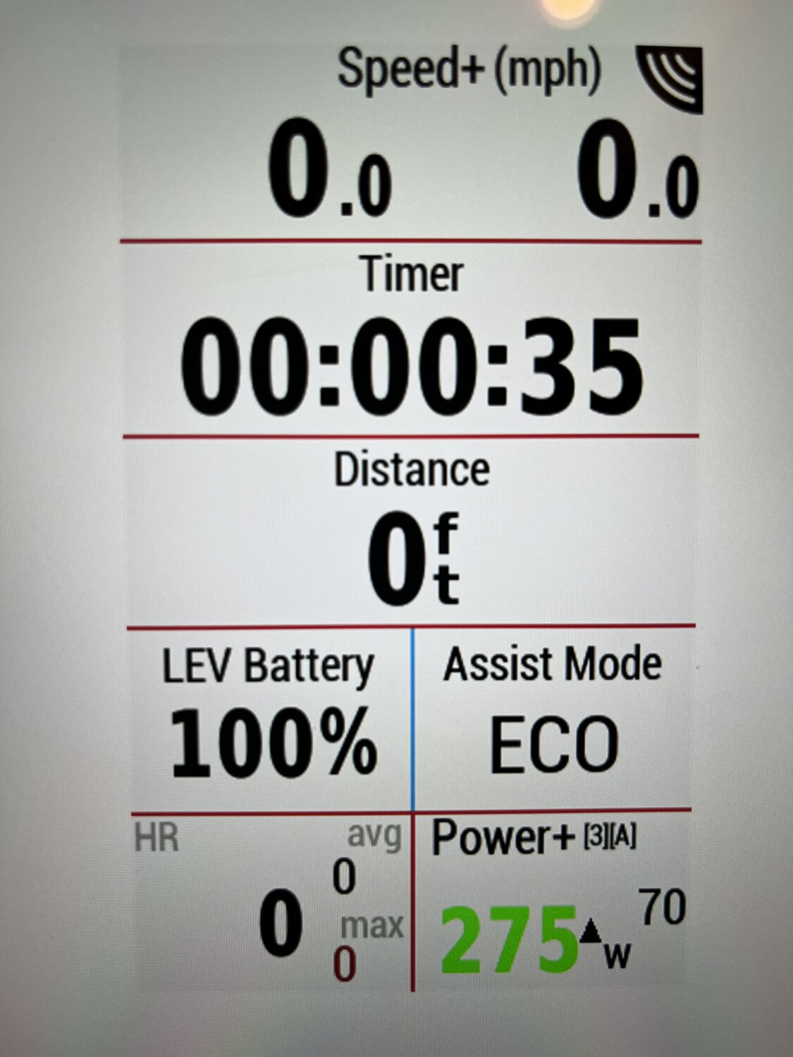

I have had no difficulty with Ebike Multifield provided I disable the Creo Ebike sensor connection and of course Creo power sensor is paired. The 4th row on the attached screen shot is the Ebike app pared down to 2 fields. Creo power is displayed in the bottom right field.

You say “creo power is displayed in the bottom right field”. I see two numbers, 275 watts and 70. Do you mean the 70 is the motor power? If so, I didn’t know any app besides the Specialized ones and Blevo could show motor power. Ebike Field (not the Ebike Multifield that you are using) only adds battery level and assist level. I’m assuming the 275 watts is your rider input 3 sec. Average power. Please clarify! Thanks!
It is another data field I have loaded. 275 is the power (3 sec averaged). 75 is the average power for the 35 second ride . I only ran this for < 1 minute in my indoor garage without GPS signal. Hence, the 0 distance reading.
