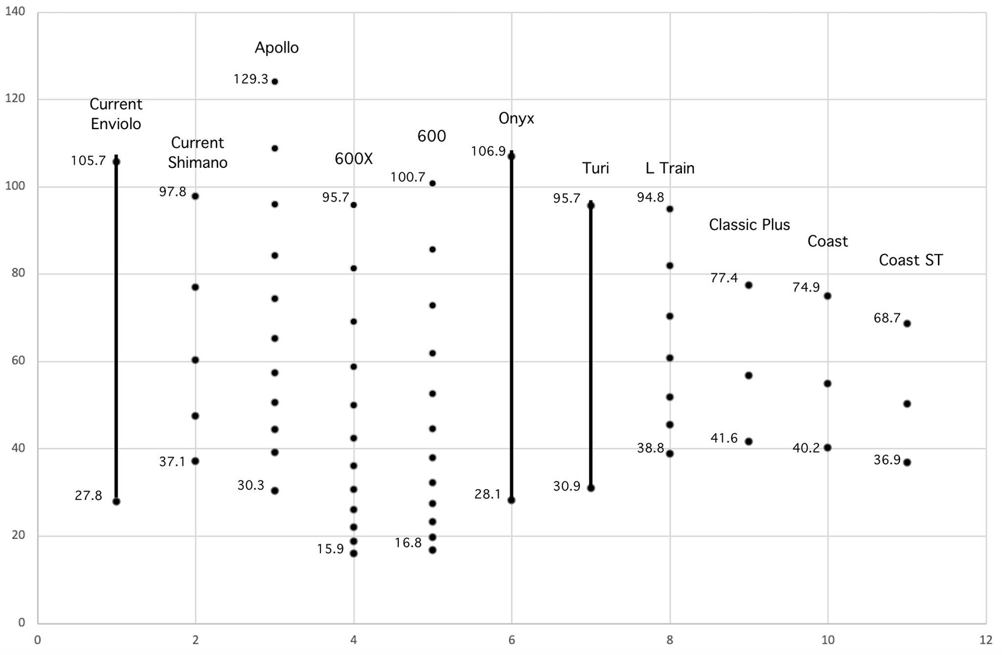

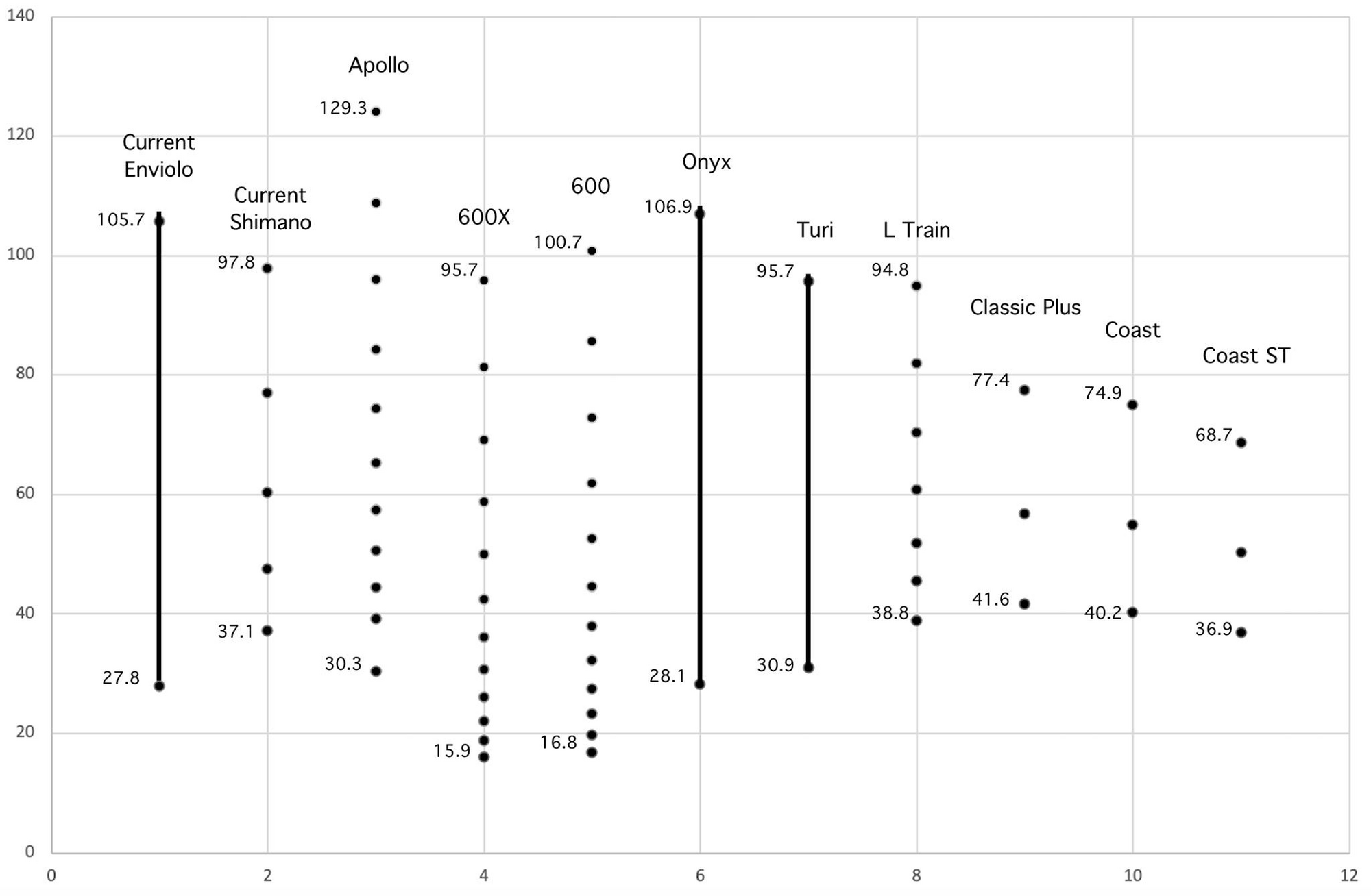

You can refer to this chart to understand the gearing differences.
Thank you. so the bottom lower numbers are "low gear"? I also read the comment from priority that they feel its easier to go faster on shimano. I wonder why its that since enviolo has a higher top gear ratio
Yes, in gear inches. Honestly, I never understood that claim either. I also have never ridden the Enviolo Current, so I can't even compare what it feels in real life :/
