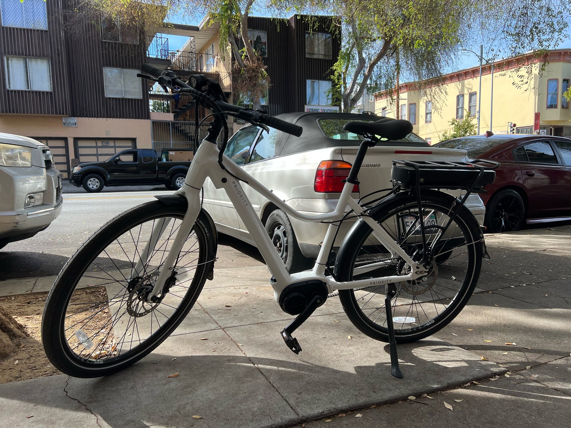

I just received my Current a week ago. A few months ago, I did a test ride on a Gazelle (Shimano shifter version). I'm not sure why, but riding the Gazelle didn't feel quite right for some reason. So, two weeks ago, I decided to take a chance on ordering the Current.
This is my third ebike in the past two years. The first was an Ecotric (which I sold), the second a Gocycle GX (which I'm keeping).
As for the Current, I love it. I bought the Shimano version. Because of shortages, the tires that came on my bike were Goodyear Transit Tour, 27.5" x 2.0". These aren't as slick as the WTB tires they were using, so I like them better.
One minor QA issue - when I unboxed the bike, the display was hanging loose and was missing one bolt. This didn't happen during shipping. Priority didn't comment on the flopping display, but did quickly send me two new bolts. Otherwise, the box and bike arrived undamaged. It is actually double boxed.
Do watch the assembly video that Priority posted. I found it helpful. They also have a video on how to change the rear tire, and other videos.
I have ridden it several times this past week. A one mile ride, a two mile ride, a six mile ride and two 12 mile rides, for a total of 33 miles. Some on paved bike paths, some on small town roads, with and without bike lanes. So far, the rides have been on mostly flat terrain.
I was surprised on the short ride (to the bike shop because of a squeaking front rotor), that when I was returning, I forgot to turn on the assist, and didn't notice it for several blocks. The reason it is easy to forget to turn on the assist is partially due to how quiet the motor is. The belt is silent, but the motor produces a very low whine when in use.
On relatively flat terrain, this bike has more than enough assist and gearing. I rarely used more than assist level one, and almost never used fifth gear. One time I used fifth gear, and hit 23 mph without even trying (the motor cut off at 20 mph). First gear is low enough that you almost don't need it on the flats, but I'm sure it will be helpful on the hills.
I did buy the optional mirror with the bike. It turned out to be the exact same mirror that I had gotten on Amazon for my first ebike (same price, too). I had to move the left brake lever and button pad inward, so that I could move the mirror as far left as possible. I still get a bit of my arm in the view.
Unlike a lot of ebikes, mud guards and lights are standard, but strangely, no bell. I like the rotating handlebar stem. I move mine up 30 degrees, for a more upright position. Of course, this much rotation also required that I reposition the brake levers, display and button pad.
Although a gel seat comes with the bike, I found it a bit hard. I bought one of these, which I also have on my Gocycle:
Wittkop Medicus Air (touring version): https://www.amazon.com/dp/B0845PGYYZ/

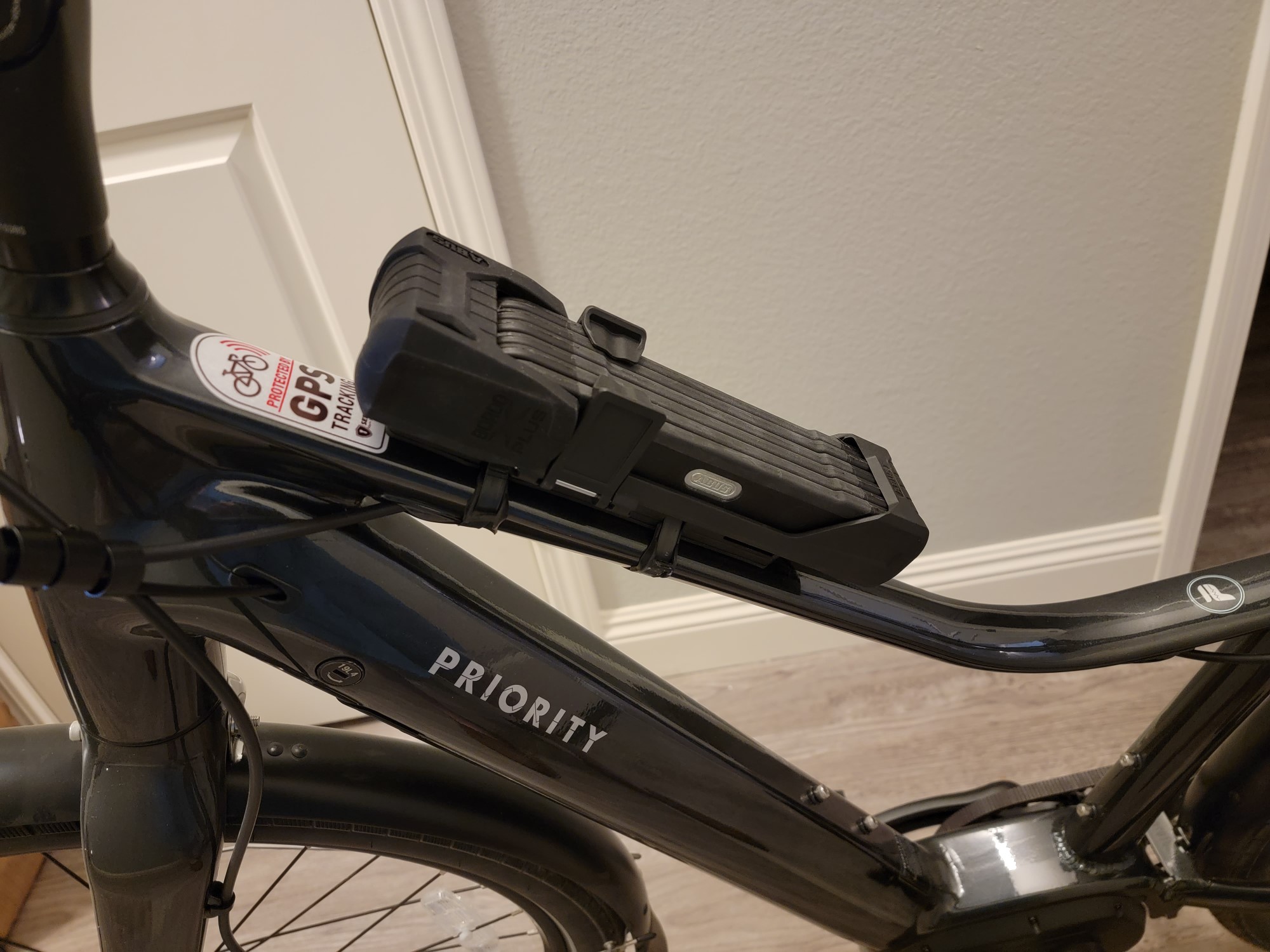

I had an Abus folding lock already, so I installed it on the top tube. Just yesterday, I added a Kryptonite Ring Lock (cafe' lock). I was going to get a cafe' lock from Abus, but I found a local bike shop that had the Kryponite lock, and it comes with mounting straps, for less money. It looks like the Kryptonite lock and straps are made by Axa. You have to be careful when mounting a cafe' lock, so you don't pinch the brake line. I mounted the lock on the underside, and got the straps to just clear on either side of the brake line mounting lug. These Axa mounting straps have two straps per side, so look to be more secure than the ones Abus sells.
It may be overkill, but I'll use the folding lock to secure the frame and front wheel, and the cafe' lock to secure the rear wheel, making it harder to steal parts. Speaking of stealing parts, the seat post clamp is a quick release, which I also replaced (30.9 mm).
I am still on my first battery charge. With 33 miles ridden (mostly on assist level one), the battery gauge shows five out of ten. I'm going to keep riding it before recharging, to see if this rate holds up. I'll stop when I get one bar, as I don't want to push my luck.
I have the large frame. I am 6', 1" and have the seat post up about 5" to the seat brackets. I had it a bit higher, as measured to the "correct" seat height, but liked it a bit lower, for less leg extension.
With my experience so far, I would be willing to tackle some more challenging rides with this bike. The ride from Carson City to Virginia City is mostly uphill. Most of the way, it isn't too steep, but the last few miles from Gold Hill is very steep. I feel that there is enough motor on this bike to do it. I'll have to wait a bit to try this, as I'll be away for a few months very soon.
Before buying, I read all the reviews and watched all the YT videos. Now that I have a Current, I understand why they all liked this ebike, especially for the price.
I'd love to see some photos of mounting of the locks, specifically the cafe lock. I haven't seen many of those in the US but want to get them for all my bikes.
I also want to change the quick release seat stem clamp lever. What was the pitch and length of the bolt? I guess I could just go over to the hardware store with the bracket...

I'll take some pics later and post them.

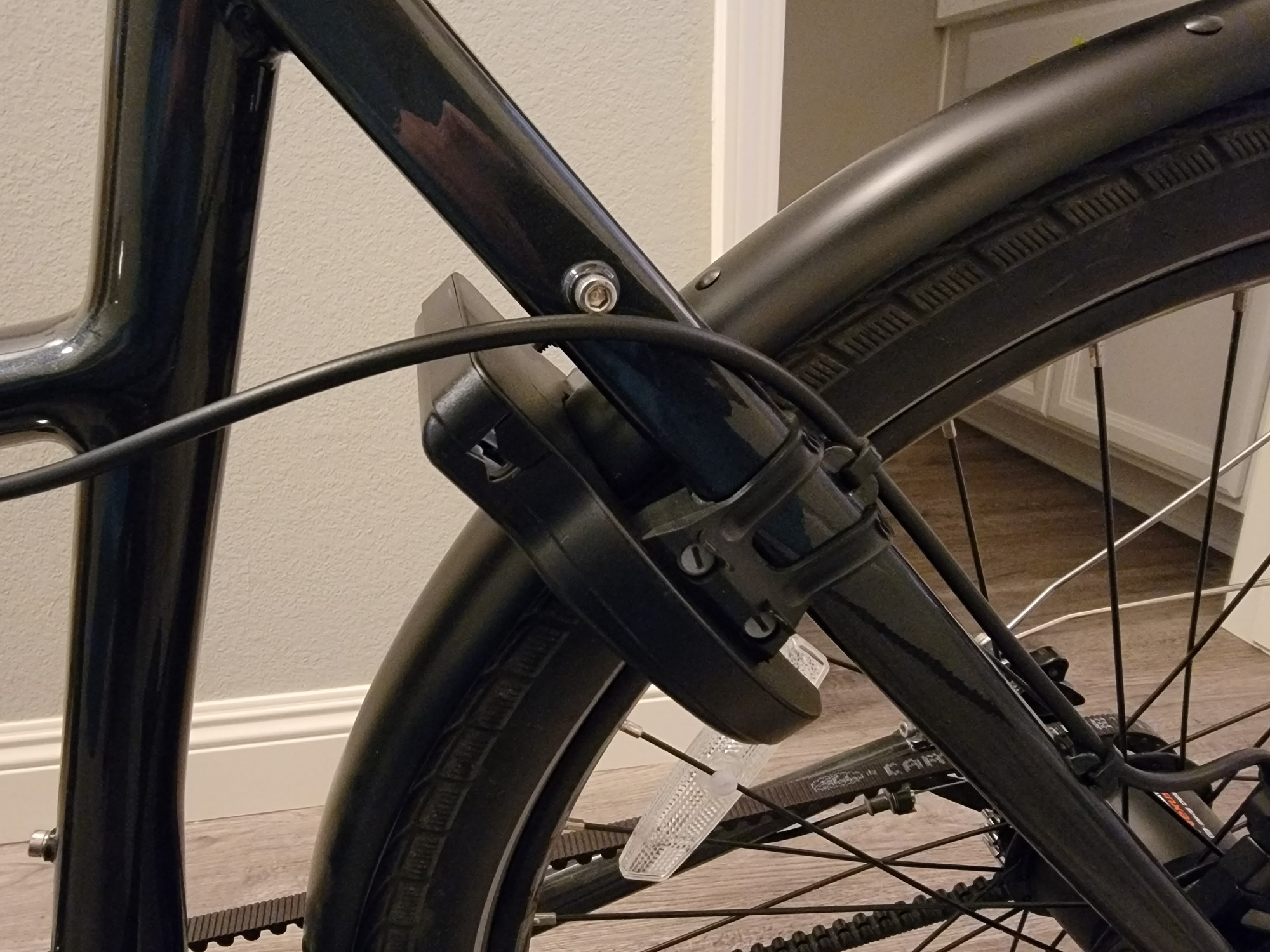

Here are the pics.
The Abus lock is the long one, so it won't mount on water bottle bosses. It has to use the included straps. The only other place to mount this is on the lower portion of the frame where the seat tube goes. I originally had the lock mounted lower, but had to slide it up to clear the J-hook clamp on the bike rack I just bought. That is one advantage to the Gocycle - no rack needed :)
Speaking of bike racks, after reading/viewing numerous reviews, I bought the Hollywood ebike rack that mounts into a 2 inch trailer hitch. And of course, the COVID excuse added $100 to the old price. I had a hard time finding one, as no one had stock. Even the local shop that is a Hollywood dealer couldn't get one for me. Despite this, I can say that I am pleased with this rack. It is very well built, and when properly tensioned, doesn't wobble.
The cafe' lock is mounted upside down. The included mounting straps give enough clearance, so the lock doesn't hit the bolt that holds on the rear mud guard. You can see that the mounts have two straps per side. There is just enough space between the straps to go on either side of the mount that holds the brake cable. As I said in my original post, I'm sure that this lock and mounts are made my Axa. The Abus version would have cost more, and the mounts would have cost extra. The Kryptonite/Axa cafe' lock is a much better bargain IMO. And for those who want to know, you can remove the key when the lock is unlocked, which is how I prefer it.
It just occurred to me - I hope that the cafe' lock doesn't interfere with the rear rack, if I ever decide to buy the extender battery. You can see the mounting bolts in the picture. Update: After watching the installation video for the rack/battery extender, it doesn't look like there will be any clearance problem.

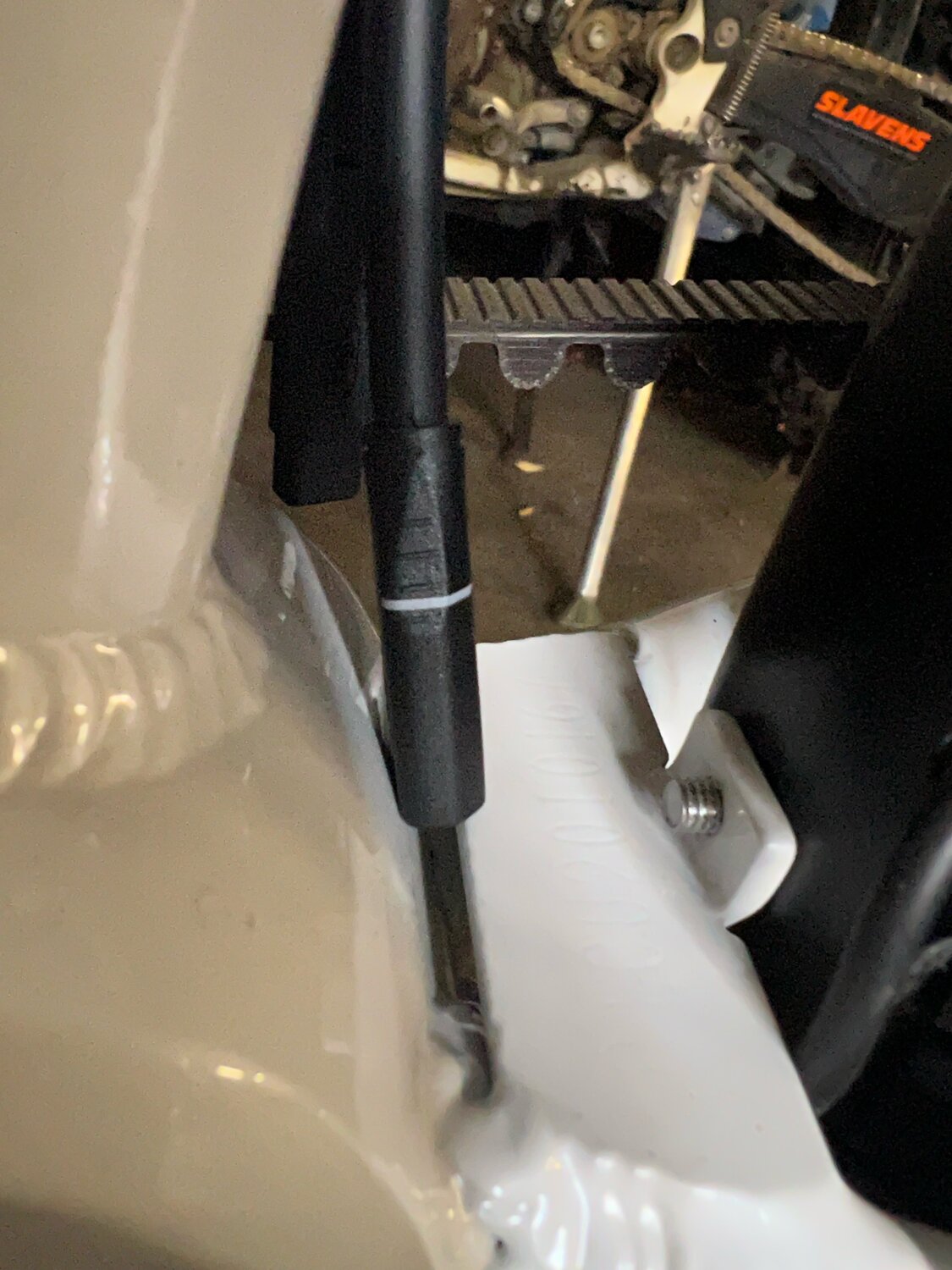

One additional item that I bought is a Gates Krikit (pronounced cricket) gauge for checking belt tension. I don't trust the accuracy and repeatability of that phone app that has you strum the belt like a guitar.
There are a few different models of Krikit gauge. You want the one that has a range of 30-150 lbs. It looks like Continental makes a similar gauge.
Gates recommends a tension of 26-40 lbs, which is quite a range. I emailed Priority to ask what they recommended, and was told "45 Hz using the Gates app", which should equate to 36 lb using the Krikit gauge, if I did the conversion correctly. What I actually measured on my brand new bike was 40 lb. This was very repeatable, using the gauge. I'm going to leave it at 40 lbs, since the belt is likely to stretch a bit with wear.

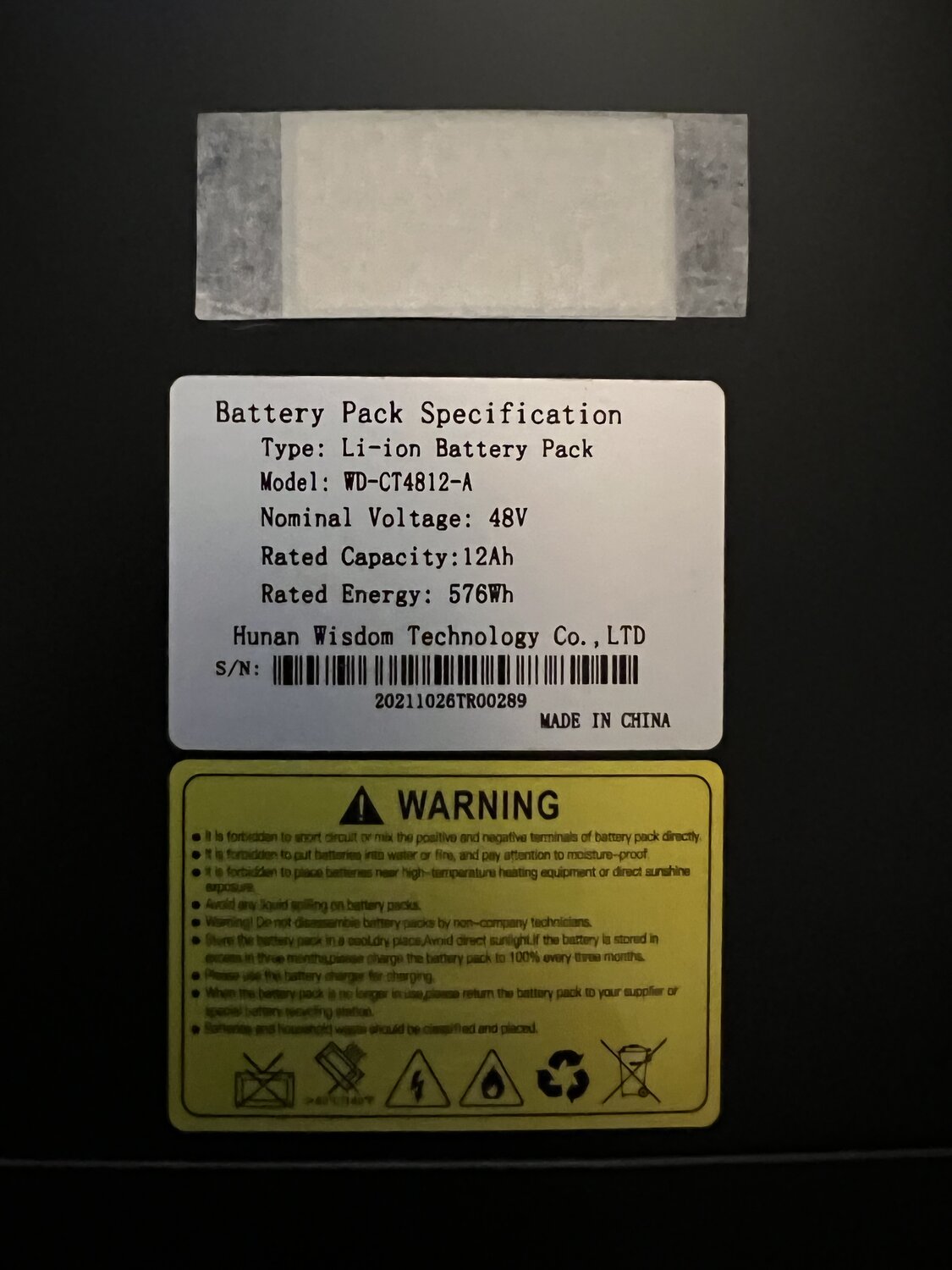

Thanks for the update. Good info. I'm sure you meant 572 Wh (or the video says 576 Wh).

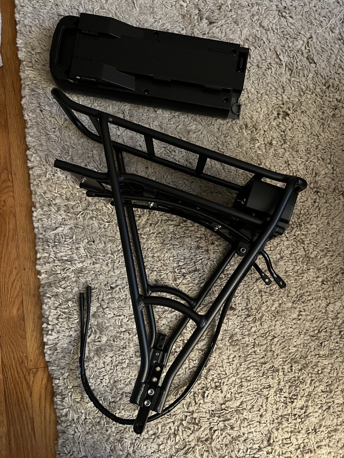

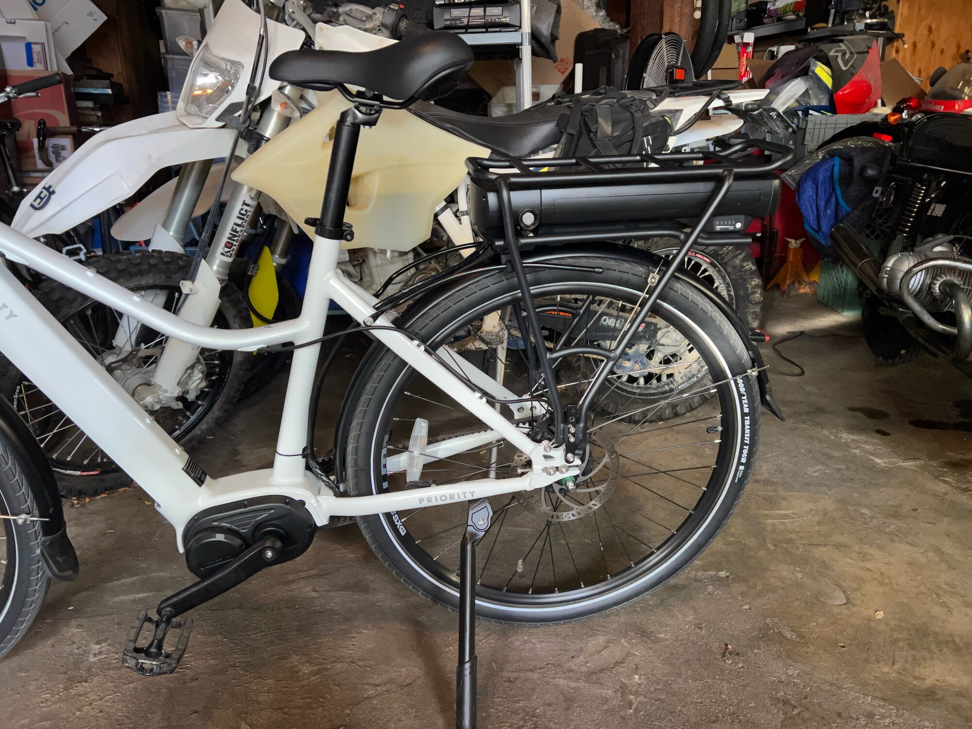

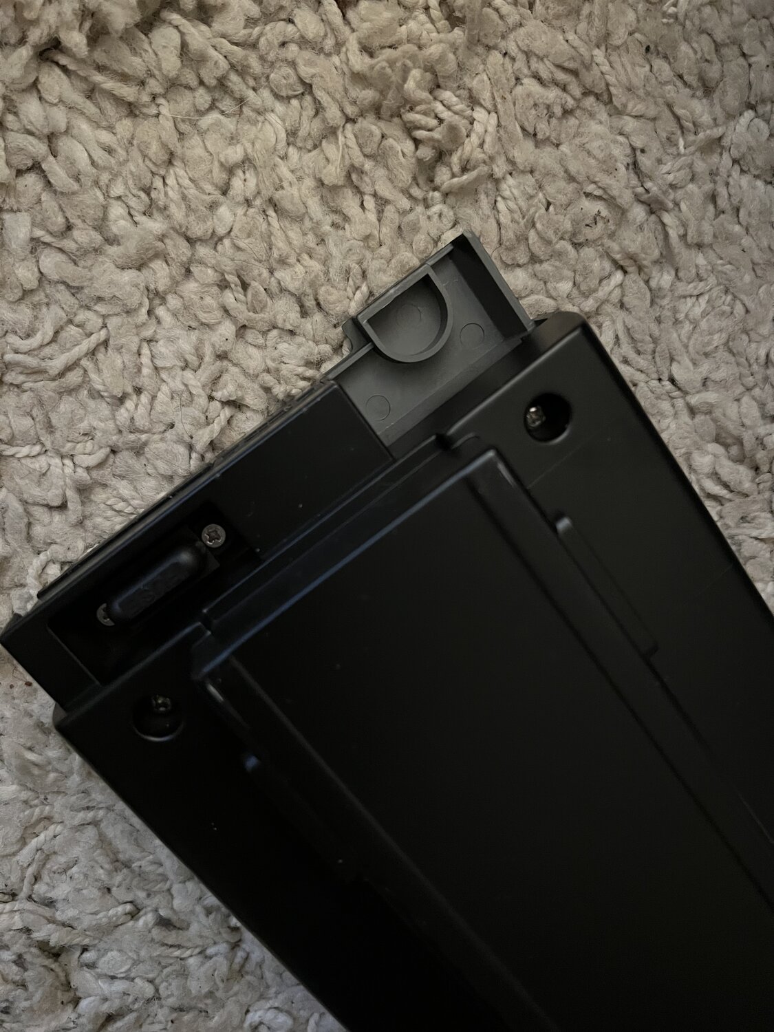

Battery extender showed up today. Less than a week after order so that’s nice. Again, well secured and protected with no visible damage or scratches. The rack looks fine, as expected, but I’m a bit surprised that the battery seems like a drop in fit, finish and quality from the bike. Very plastic-y and basic design. I didn’t expect that this kit would be different in terms of these things gs than the bike but it certainly is - for example - the plastic tab that locks the battery in could be pulled apart with one hand, rough plastic seams…. I suspect a drop or blow would do some real damage to the battery pack. Not what I was expecting for what I think was a premium price for the kit. Putting it on the charger now for a 100 mile weekend ride.
- I wish there was a dummy cover to slide I
into place when I’m not using the battery. Even an empty shell would be a nice storage compartment and also protect the exposed connections
- The key tumbler is different than the bike so my hopes of having the locks re-keyed is over
- I don’t care for the stickers on top of the battery - very visible when battery is mounted - but some black tape will cover them

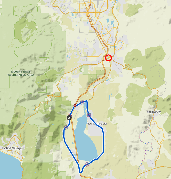

I am on my second battery charge, so I thought I'd report more data.
The weather was great today (sunny and 60-ish), so I went for a long ride. I had planned on a 20 mile loop ride, but I was enjoying the ride so much that I didn't pay attention, and missed the turnoff (I'd never done this ride before). By the time I realized it, I was half way to Reno. By the time I got back to the truck, the 20 mile ride had become 37 miles.
The route didn't have steep hills, but had several long grades. I did use level 2-3 on those for brief periods. I also used level 5 for a few seconds. On the last seven or so miles, I was tired, so I used level 3 for most of it. Also, during the last hour of the ride, the wind had picked up, so I had some headwind and crosswind at different points.
Within sight of the truck, the battery gauge dropped to one bar. The final mileage on the trip odometer read 37.2 miles. I could have made 40 miles on the battery with level 3, but if I had a bit longer to go, I would have had to drop to level 1.
Attached is a map of my ride. This is from www.komoot.com. The planned ride around the lake is in blue, starting at Davis Creek Park, and riding North. The red circle shows where I got to before turning around.
If anyone plans on doing this ride, for most of it the shoulders are wide (even the part I didn't intend to ride), and in some places are marked as a bike lane. The exception is Eastlake Blvd (which strangely enough, is on the East side of the lake :)). For much of it, there is no shoulder at all, or it is dirt/gravel and is a bit too rough for a road bike.
It looks like I need the extender battery.

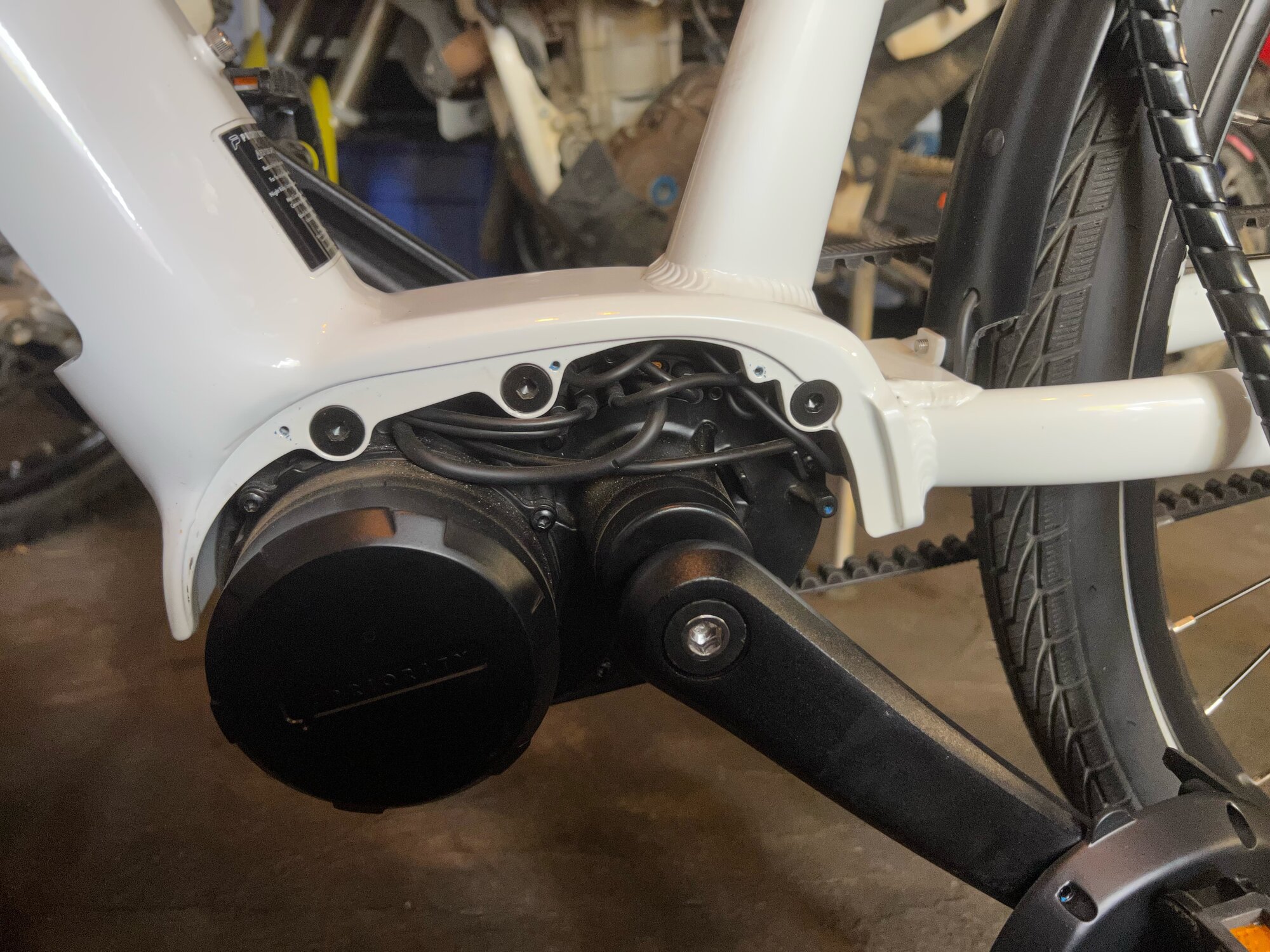

Installed the battery extender and did a short ride around my hood. Installation was easy but some differences between the video and reality are:
- the nuts to loosen on the support arms was 3/8 not metric (weird)
- the cable routing will never happen between the swing arm (not sure what it's called on a bicycle) and the brace as they say is optional in the video. I was thinking about dremmeling out a slot but will wait. For now I routed the cable over the brace and will watch to see if there is any wear on the insulation of the wiring. It is too close to the rear wheel in my opinion. The connector is bigger than the space is wide. See attached photo.
- the 3m stick on zip tie stays don't flex enough / have the wrong curve to match the oval shape of the down tube. I had to use the provided zip ties all the way around the the down tube to to secure the wiring
- there are many connectors under the plastic engine cover but look for the largest one and disconnect that one. I took a few others off and realized that most of the others have a different connector anyway so little chance in messing things up but I didn't expect this. This is a tight space to work in so make sure all connectors are in place before closing things up
- I've been looking for a place to secure an Apple Airtag and under the engine cover is perfect. I think I'll put a dab of adhesive on the inner cover and stick it there
- I contacted support to see if they sold a blank battery that I could slide in to cover the exposed connectors when I didn't have the extra battery in place. I also thought it would make a nice storage container. None for sale and in fact no extra batteries for sale either
- On a side note, thinking about battery wear, it looks very simple to open the extender battery case, a few screws, and I suspect you will have access to the entire battery pack to replace / upgrade it if you want
60 mile trip planned for Saturday so more details to come
