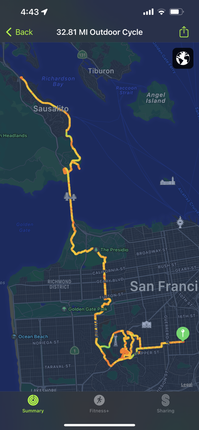

Nice 42 mile ride on Sat - from the Mission, up to Twin Peaks, through Golden Gate Park, through the Presidio, over the Golden Gate Bridge then dropping down into Sausilito. My observations were:
- This is the perfect city commuting bike. I strongly recommend this bike if you are looking to go to and from work or errands that are around 10 to 15 miles each way.
- My complaints about stock gearing being to low didn't apply at all. I found on steeper hills that using PA1 / gear 2 was perfect - low and slow - even on the return ride up the switchbacks to the bridge. There were very few long straights so riding at 22mph was fine.
- My complaint about range is the same. I originally planned on carrying the power adapter and recharging over lunch. Still might do that. It is becoming clear that I will be using the bike for long casual rides and most likely will order the range extender, still on the fence, leaning very strongly to buy it. I made it home with 1 or 2 bars but was VERY conservative and turning PA to zero on flats - which was fine - but most of the day, all I did was think about how much power I was using or battery status. I kept thinking, "Wouldn't it be nice to never think about range again"
