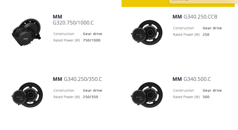

great, was not aware, just doing my research before buying. any idea why the BBS02B is not listed on the Bafang website?
Likely a motor that will disappear. here's their latest.
