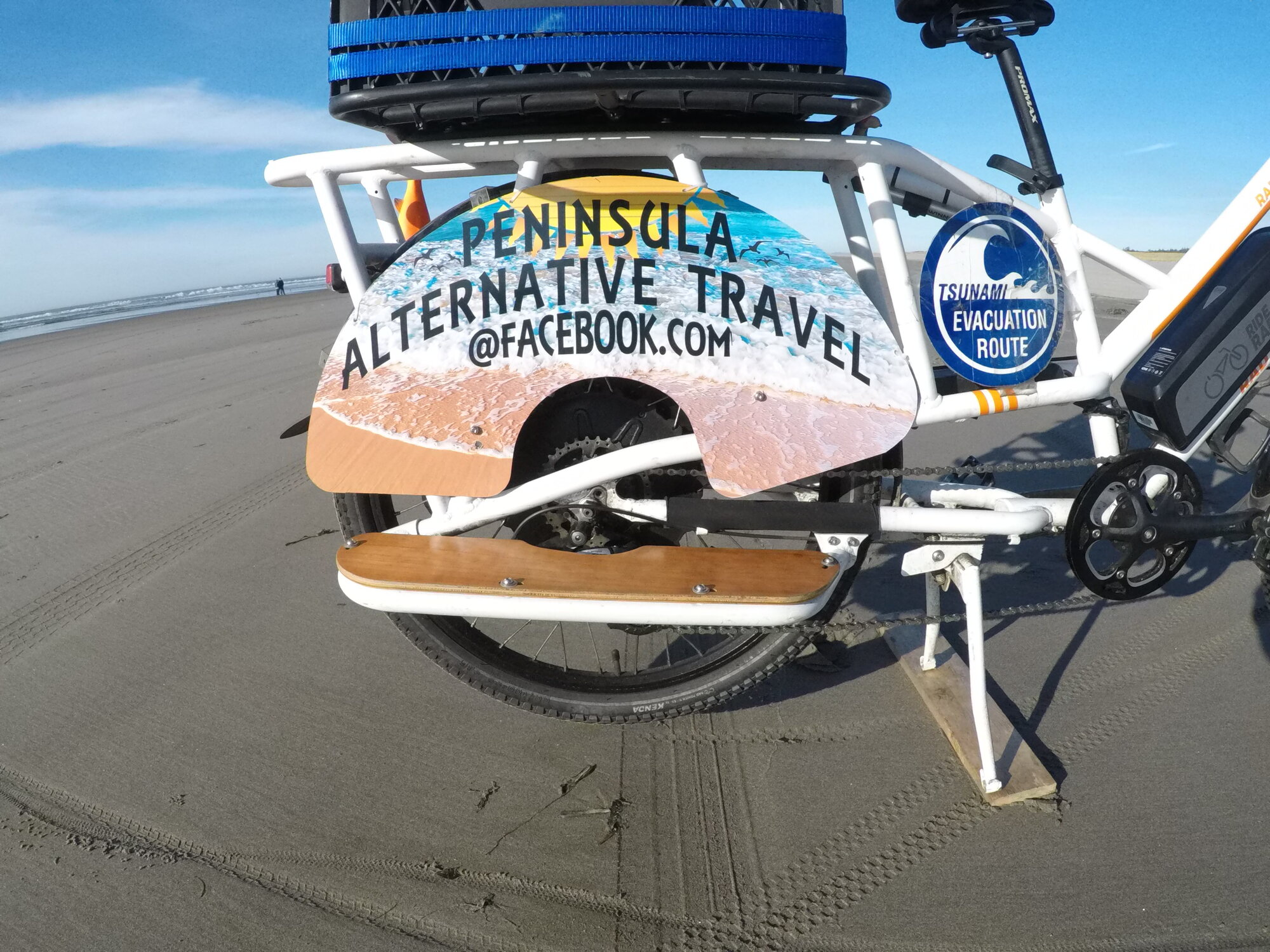

where can i find radrover bottom brackett specs ?
just trying to get some idea what we are dealing with on the radrover sand blaster , it spends its daily life on the beach by owner / admin @ beachcombing - facebook . along with many other beach related issues the bottom bracket needs replaced now , we need the replacement spec / link & any sand tips you may have , rad has been incredable with this bike & parts replacement along the way but an upgrade is a good thing !

just trying to get some idea what we are dealing with on the radrover sand blaster , it spends its daily life on the beach by owner / admin @ beachcombing - facebook . along with many other beach related issues the bottom bracket needs replaced now , we need the replacement spec / link & any sand tips you may have , rad has been incredable with this bike & parts replacement along the way but an upgrade is a good thing !View attachment 51600
The bottom bracket is 100 mm Square taper
