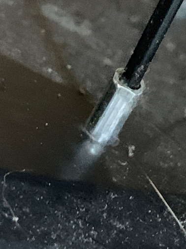

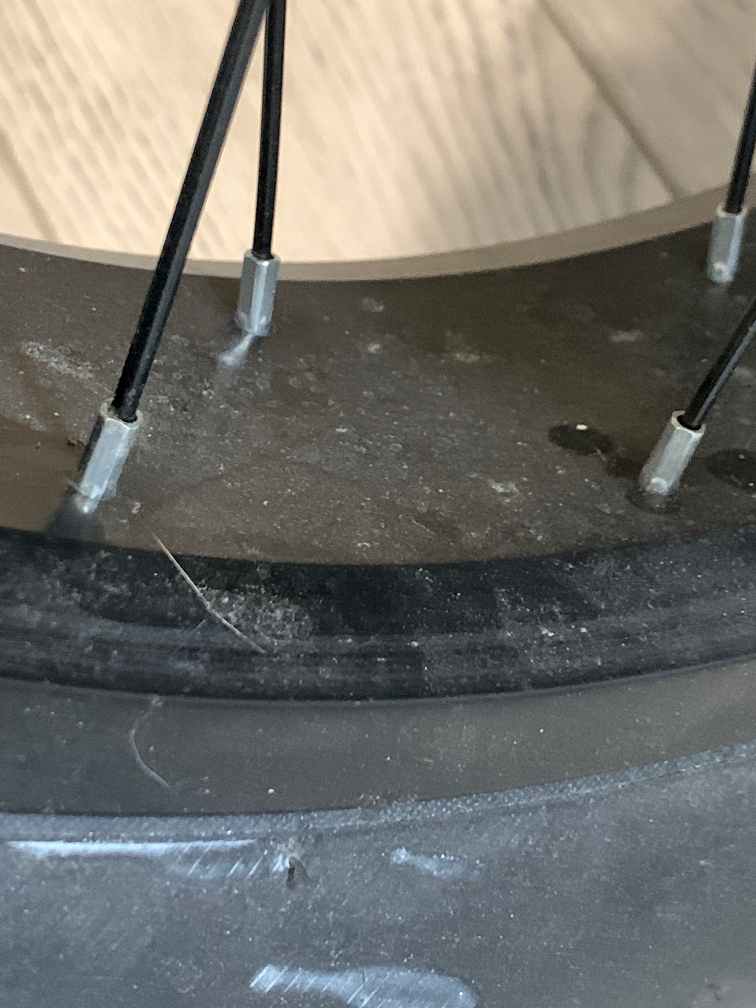

Can you take a look at this pic and possibly recommend the Park Tool spoke wrench I need?
The tire is a CST/CHAOYANG 20x4.
I don't have info on the rim.
Here are a couple of pics. Any help appreciated.

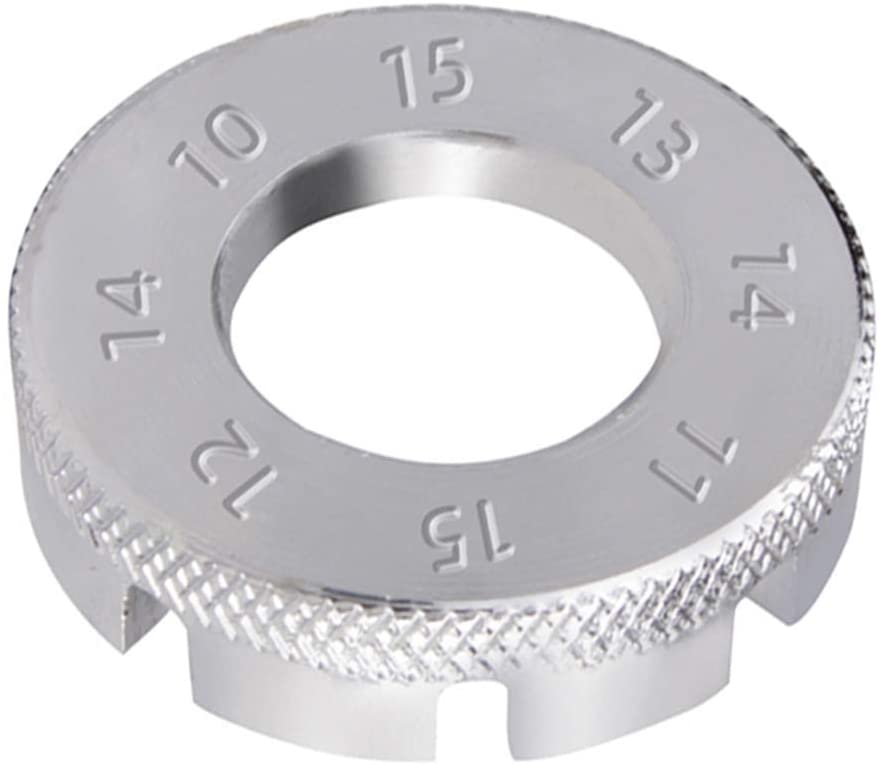

why not just buy one of these:
LETUSPORT Silver Road Mountain Bicycle Bike Spoke Wrench
I built a wheel using one of those wrenches. I had a replacement on order before I even finished it. That particular wrench is very difficult to keep track of which slot to use. Works OK from that point, but wasted a lot of time figuring which to use every time you pick it up.
The flux capacitor wrench is good. I have a drawer filled with touch up paints. I mark the 14 red so it corresponds with the SW wrenches above. It wasn't explicitly stated by @tomjasz, but there was no way to scale your photo. If you put the edge of a dime on one side of a nipple and a nickel on the other, that would have helped.
But still helpful for someone on a tight budget?!
I need to be honest here. I keep a spoke wrench for emergency service but leave truing snd replacements as well as builds to a talented LBS. actually pretty cheap to have them sort it. My local does not support kit bike eBike components but happily does basic repairs. At fair prices.
Yes it's a cheap wrench, but the OP could get it fast, figure out which size he has, and order a better one. Better, IMHO, than having a set of individual wrenches where only one will be used, the rest probably lost. These multi-sized units are good to keep around when you might be dealing with a variety of bikes, and only needing to do minor adjustments on a spoke or two.
Building a wheel? You knew in advance what size you needed, yet you still cheaped out?
That wrench was more like a learning experience - as in purchased because I didn't know any better. I do admit, it WILL get the job done, it's just a PIA to use on the scale I was using it at. Agree as well, it's not a bad shot in the dark, something to get you going....

When building on a wheel with this particular wrench. I just tape up the slots that aren't used. The individual ones are nicer, fit better, and I have those, somewhere.
