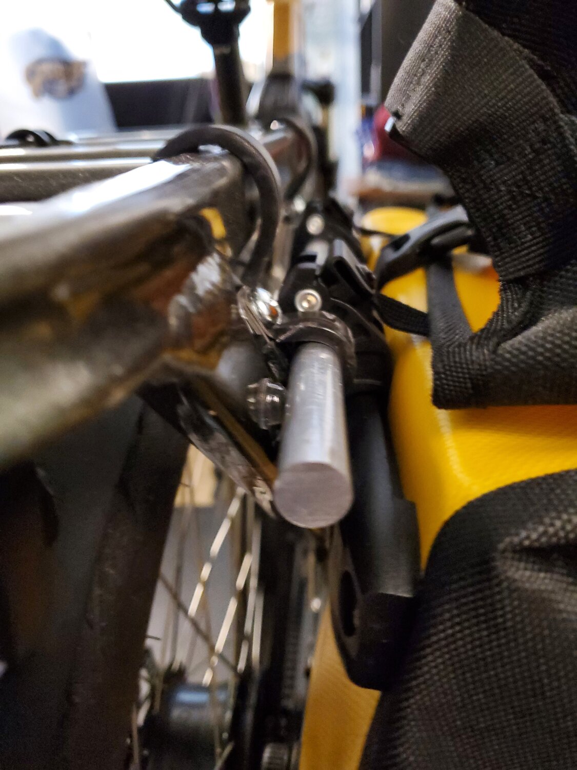

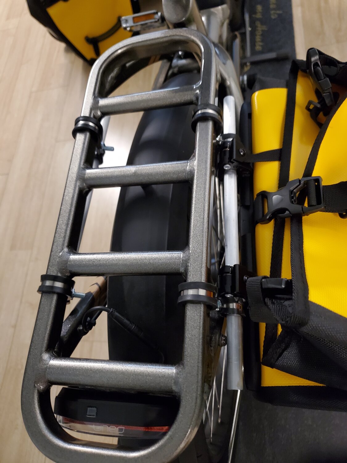

As someone who has the Aurora Limited and was racking my brain on how to fit some panniers since some of the popular ones like the Ortliebs just would not fit even with the biggest adapter they have (20mm). So I followed this post's instructions and it works perfectly. I did have to modify it a bit. For example, the 5/8 in is too small, you have to use 1 in. for it to fit the Aurora securely. I also added a little bumper on the side of the frame to avoid metal on metal since the paint scratches easily (could also just wrap it with electrical tape). I can use my Ortliebs now!
