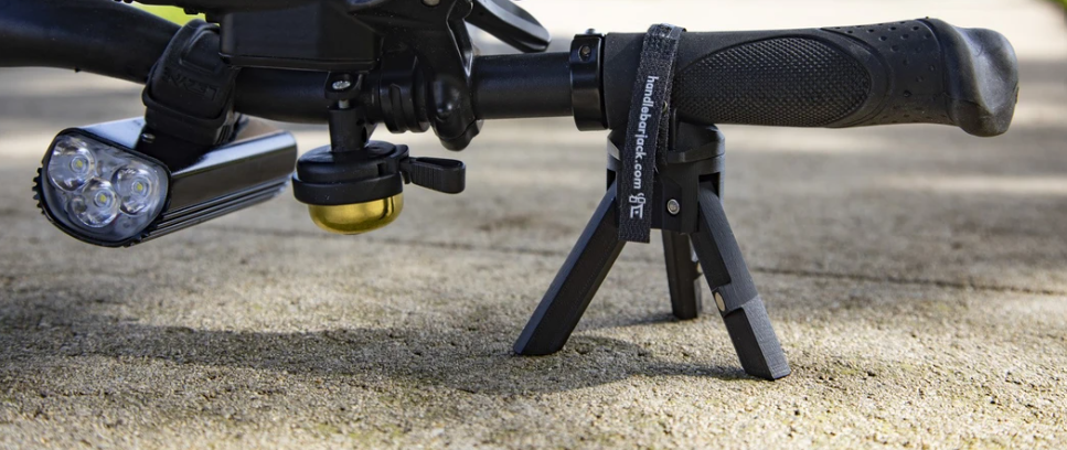

Here is a link for the Handlebar Jacks:
Another vote for the handlebar jacks... perfect for repairs on the road or trail. ;)
