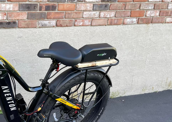

Something like below but without the wood... any ideas on how I can do this?
There is the Grin bracket (https://www.amazon.co.uk/dp/B09BH3ZJJK) that I suppose I can use? But want something somewhat clean.

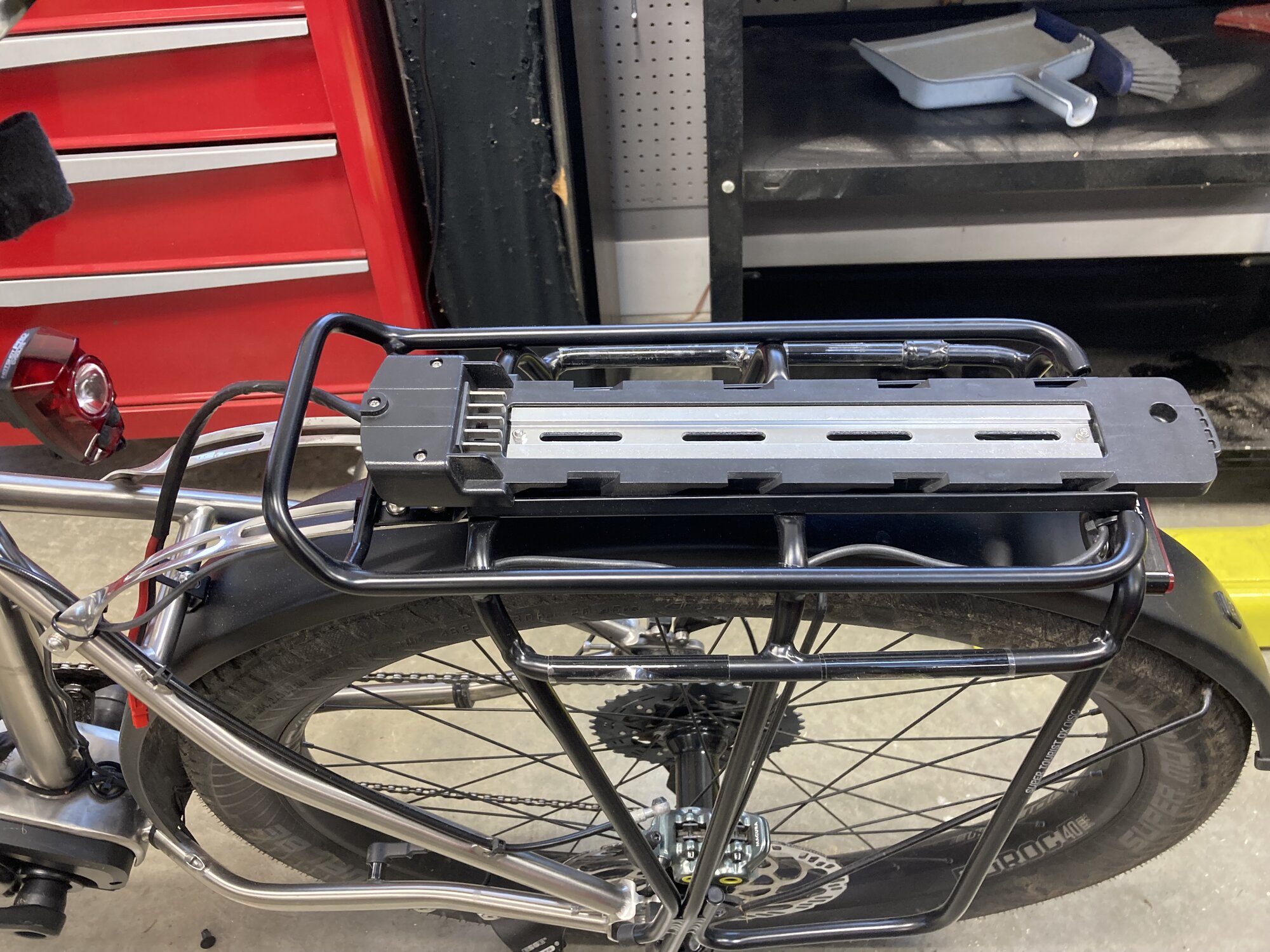

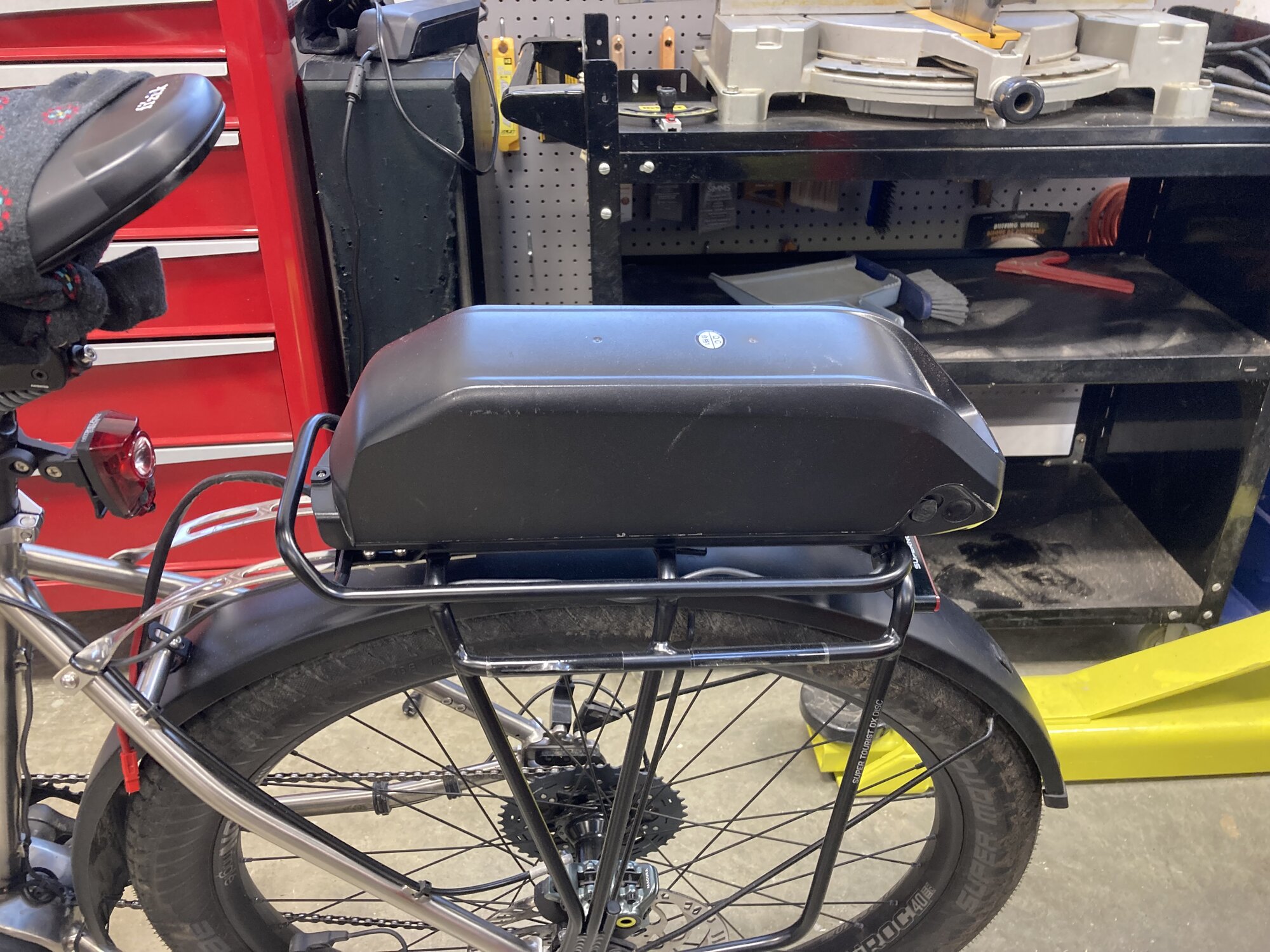

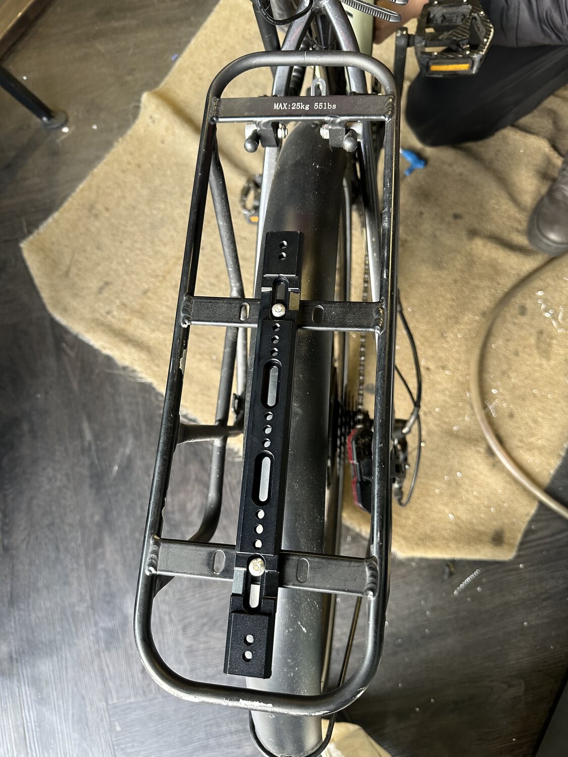

If you could provide a picture of the actual rack you plan to use you might get a better response?
Since there is very little stress, you could mount the battery "install plate" directly to the rear rack in most cases with two or three bolts.
The battery is fixed to the plate. If your rack wiggles sideways, then you need a better rack, I carry 6 pound batteries routinely on bike racks.
Yes my rack is tight so hopefully it will be ok, thanks Harry!
Do you think the battery will be stable? My worry is that it may rock side to side, not the actual plate but the battery itself.
If the lateral g-forces are strong enough to dislodge a properly secured rack, mounting plate, or battery, you probably won't be able to hang onto the bike anyways.
It’s exactly the same one in the picture 👍
If you can mount the plate directly to the rack and still be able to slide it on and off easily then that is all you need. Just fasten it down as well as possible using loctite or zylock nuts because vibration will loosen the fasteners pretty much guaranteed if you don't.
