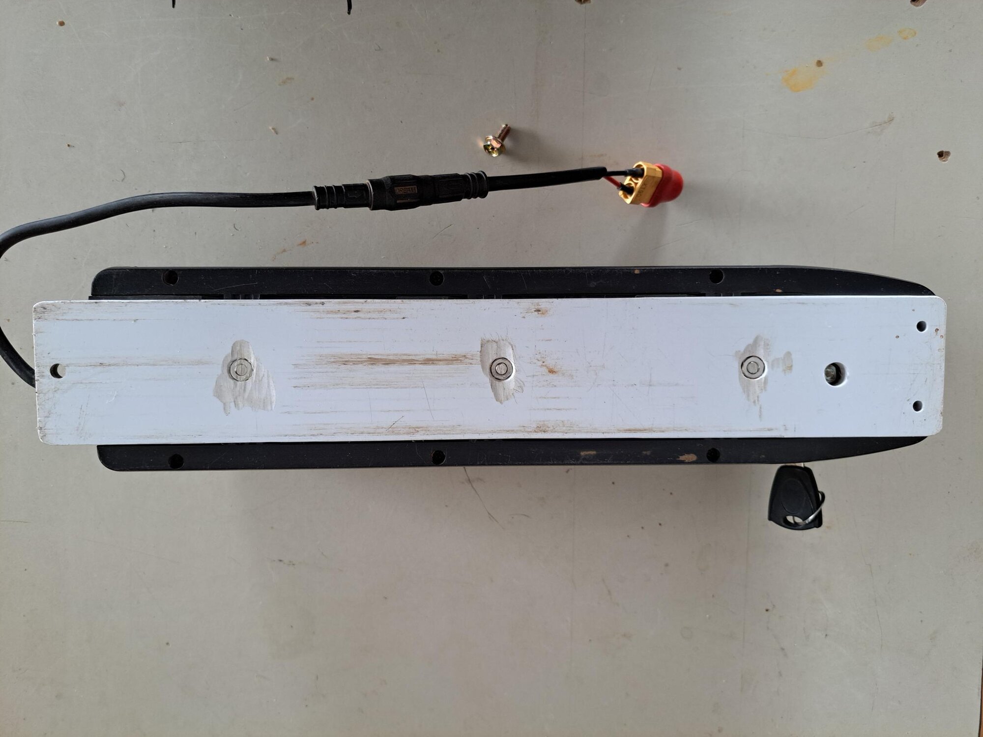

Ok. Please don't connect both batteries at the same time. Disconnect the one battery completely before you connect the other.
Those are pretty small connectors. I have those on one of my battery packs for charging. I used XT 90 connectors for the main current. Keep an eye on them for signs of melting.
For sure! I'm unable to connrct both batteries anyway, the cables aren't long enough... this is the safety feature! :p
Thanks for the tip, will do! The battery actually came with XT60 but LBS asked to swap these out as they had the correct cables already (saved them from loads of soldering etc).
Those Anderson Powerpole connectors are good for 45 amps. They are silver plated to avoid corrosion. I use them, as well as the XT60's and have had no problems with either.
In the past, I've used my batteries individually as well as wired in parallel with an isolator. When wired together, they both discharge at the same time and I have to recharge both every time I ride. Unless you make a rig that will charge both at once, you either need two chargers or remember to switch batteries on a single charger.
I stop frequently when I'm riding anyway, so swapping a battery connector is no big deal.
They can be 45A rated. Counterfeit is the problem. NOT the physical size of the Anderson connectors.

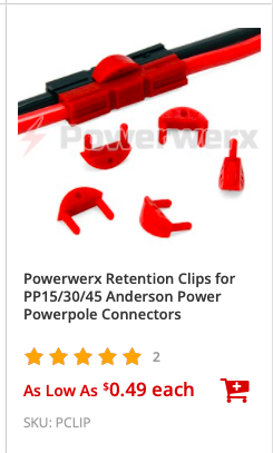

I would be treating them with an anti-moisture, an anticorrosive product like Boeshield T6, shame the LBS doesn't use the Anderson accessories.

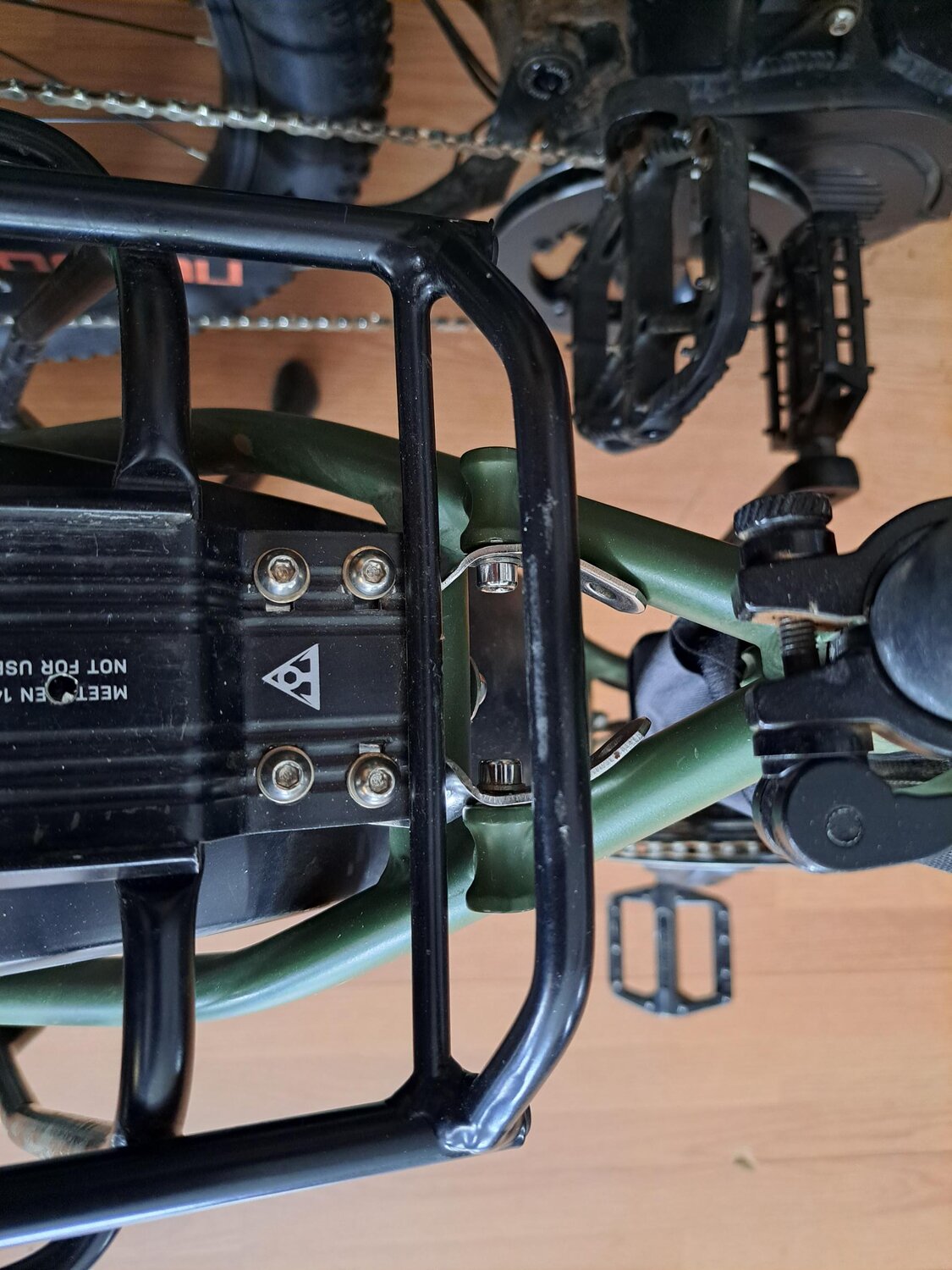

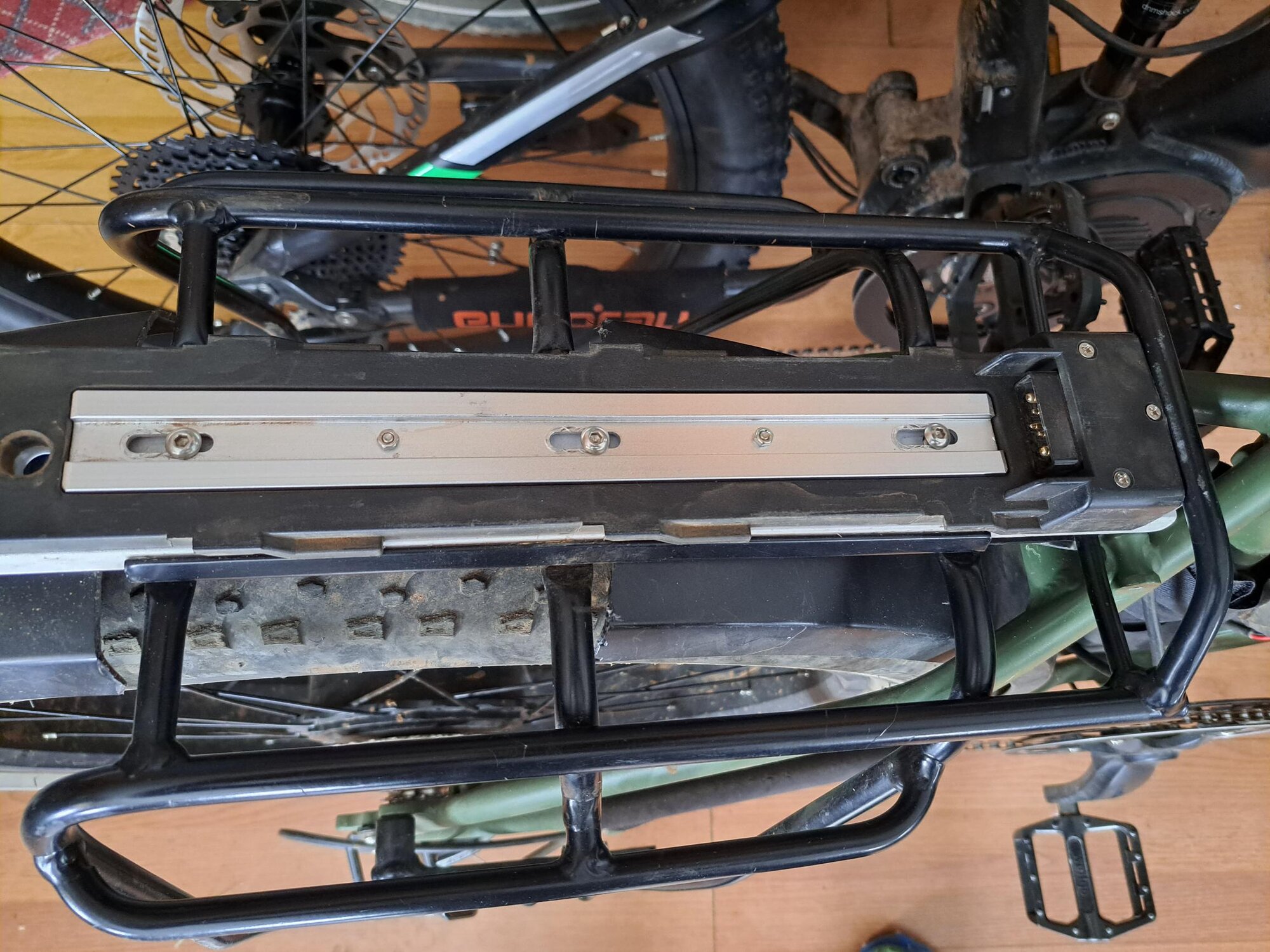

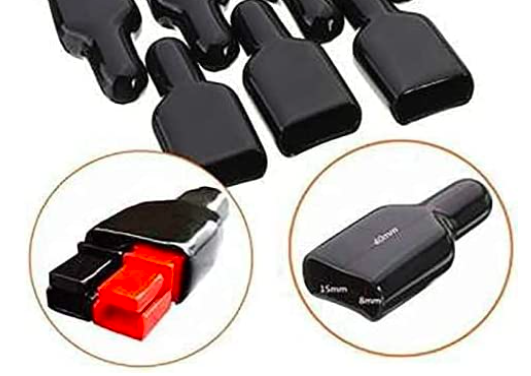

I've looking around for the weather resistant dust caps but can't seem to find anyone in the UK selling them, strange!

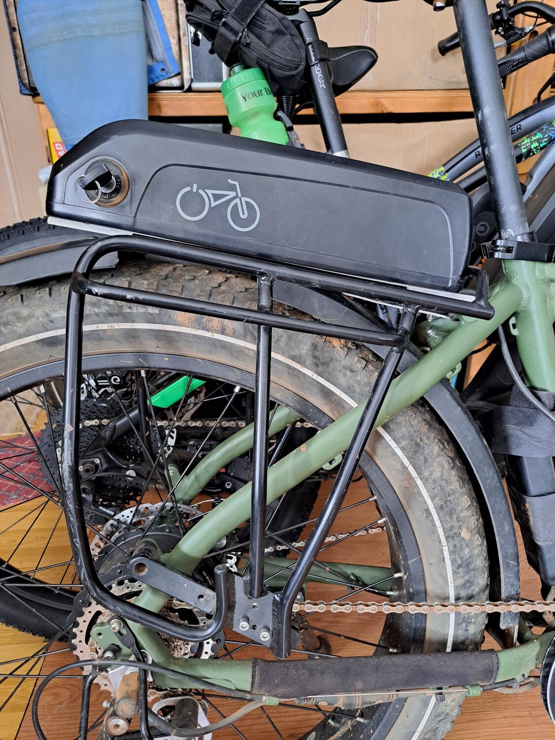

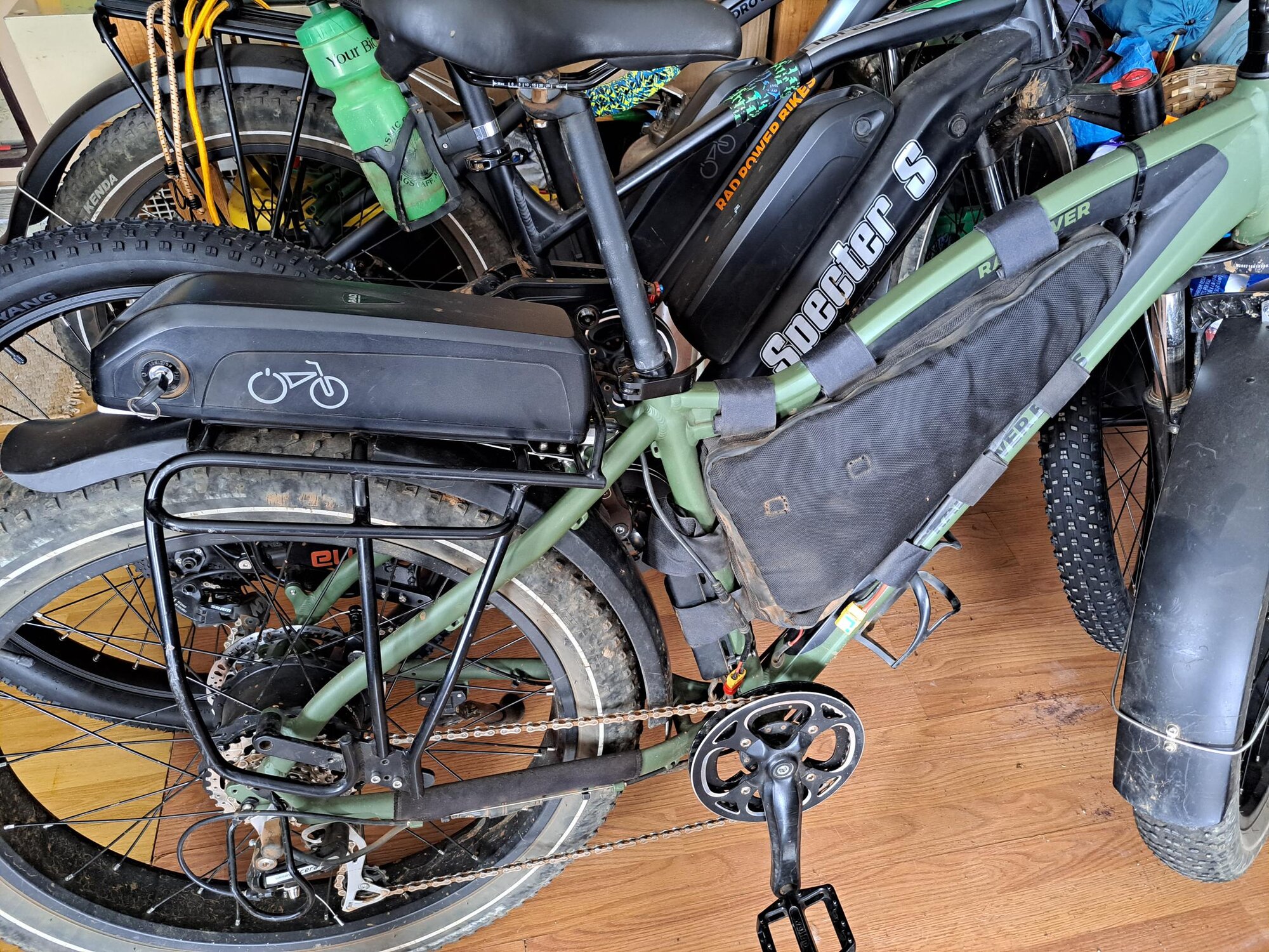

What I did is similar to other mods seen here but with better placement for center of gravity. I put a 20ah triangle battery on my Rad Rover 5 and used a Topeak Uni Super Tourist DX rear rack to carry the oem battery. That rack is very adjustable to position it far forward and very low to the tire. With a little modification to the upper mounting straps I was able to get most of the battery weight in front of the rear axle and just above the rear tire. My mission was to keep the extra battery weight as low and forward as possible so I cut the Rad Rover plastic fender so that the rack acts as part of the fender to put the weight even lower. By bending the rack's tail light holder outward I was able to use it to bolt on the Rad fender tip. (I cut it too short for mud). The rack is designed to carry heavy loads and it has a slide on mounting system for Topeak DX bags. I made an adapter plate from pvc that screws onto the Rad oem battery cradle, so now the battery and cradle can just be slid on and off easily and quickly. By drilling a hole in the plate, the battery still locks to the cradle and can be removed from the cradle for charging or whatever. Sliding the assembly onto the rack with the battery facing backwards allowed me to use a short connector cable too. Dropping a 1/4" bolt into a hole in the forward side of the pvc plate keeps the assembly locked in place and if I put a nut on the bolt the battery is locked onto the rack but can still be removed from the cradle with the oem key lock. If I use the Topeak pack on the rack, the battery can either fit inside (tight fit) or in one of the fold out panniers. This system works perfect for me, and never having 'range anxiety' is well worth the extra battery weight and less than ideal mounting location. Once the bike is rolling I don't even notice the weight.
